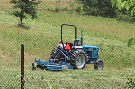

Chris, these are from last Summer when I was fixing up my Howse medium duty brush hog.
I made some leveling gauge wheels that fit the brush hog and other implements such as my box blade and rake. They are hydraulic controlled so I can raise the rear or front while mowing. I don't have a level spot where I mow so I use the position control and 3 pt for raising or lowering the front and the hydraulic wheels for the rear. I have solid swaybars that are adjustable by pins and a slot for some movement.

Hey Rob.
That is a fantastic looking setup. I wasn't sure what to expect, but that looks sweeeeet!
Thanks for sharing the pics.
