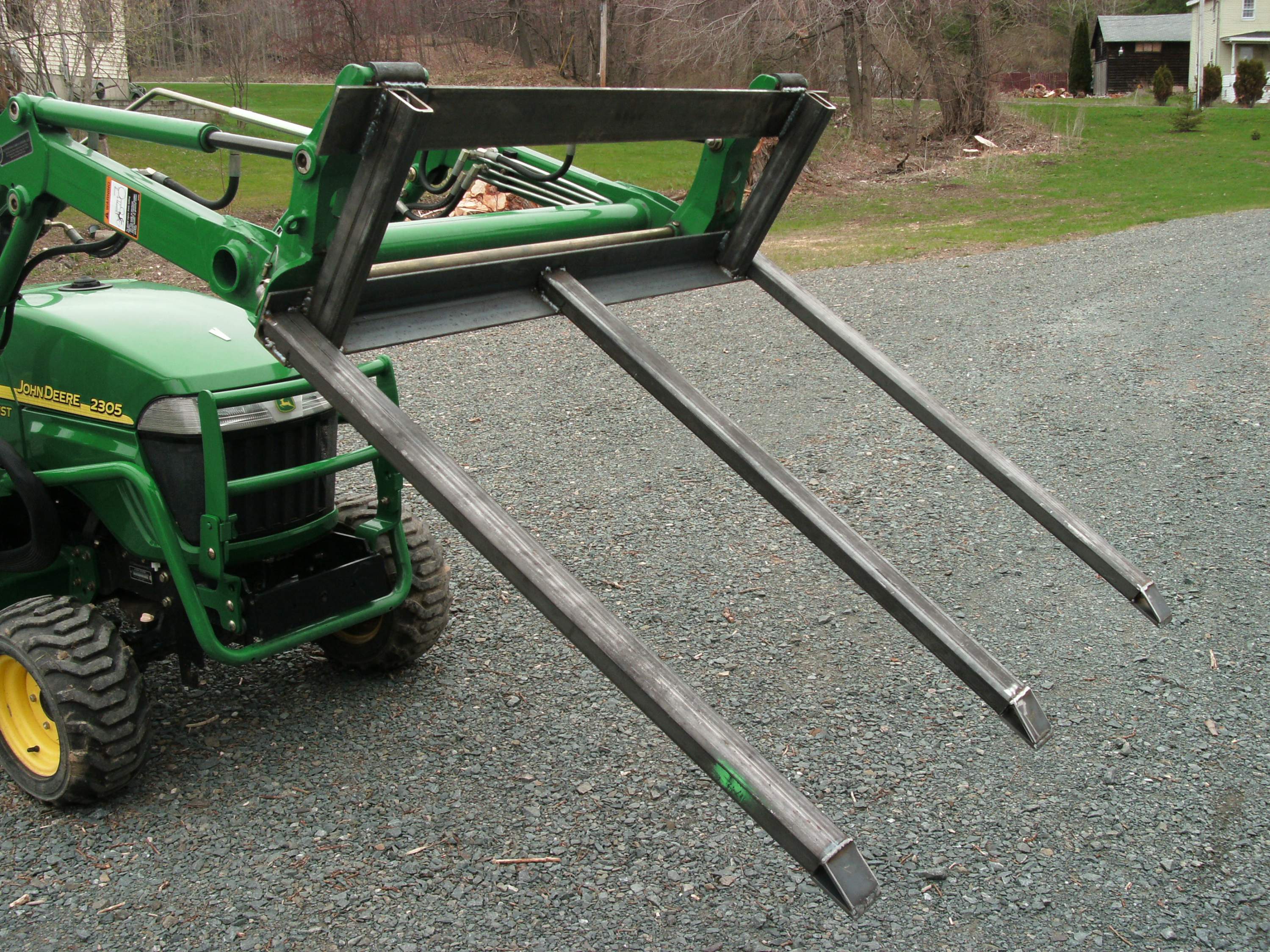

Got some more scrap and made some progress. So far, this is how they look. I tested them, & they definitely need to beefed up a bit more, the middle fork felxes the angle iron it seats in under heavy loads. Also will be adding the smaller forks in between. I would love to make this look nicer, built with all square tube, but with my tight budget, I need to keep cost down. This was built w/ all scrap, so far it cost me about $100.00.
Some 2.5" or so round tubing welded in the throat of the angle spanning between each fork would handle the torsion loading on that angle iron. I would leave out the small forks -- it going to make it too "busy".

Did you buy the quick attach hooks and pins from Deere, or fab them yourselves. If I remember right, I had looked a while back and the formed hooks for the top and the pins for the bottom were avaliable as service parts that could be welded on your own project. I had been thinking about a special grapple bucket or something at the time and thought that might save some redneck metal forming making the upper hooks.

Just my opinion, but the forks near the bottom of the frame need a lot more support. Right at the lip on the bottom is where you will probably bend the fork/frame with enough weight is lifted. What is the wall thickness/size of the box tubing, and length of the forks? I would add gussets on both sides of each fork, Maybe 4x4x6 triangle, or larger. With the forks that long, you will try and lift more than you should.
