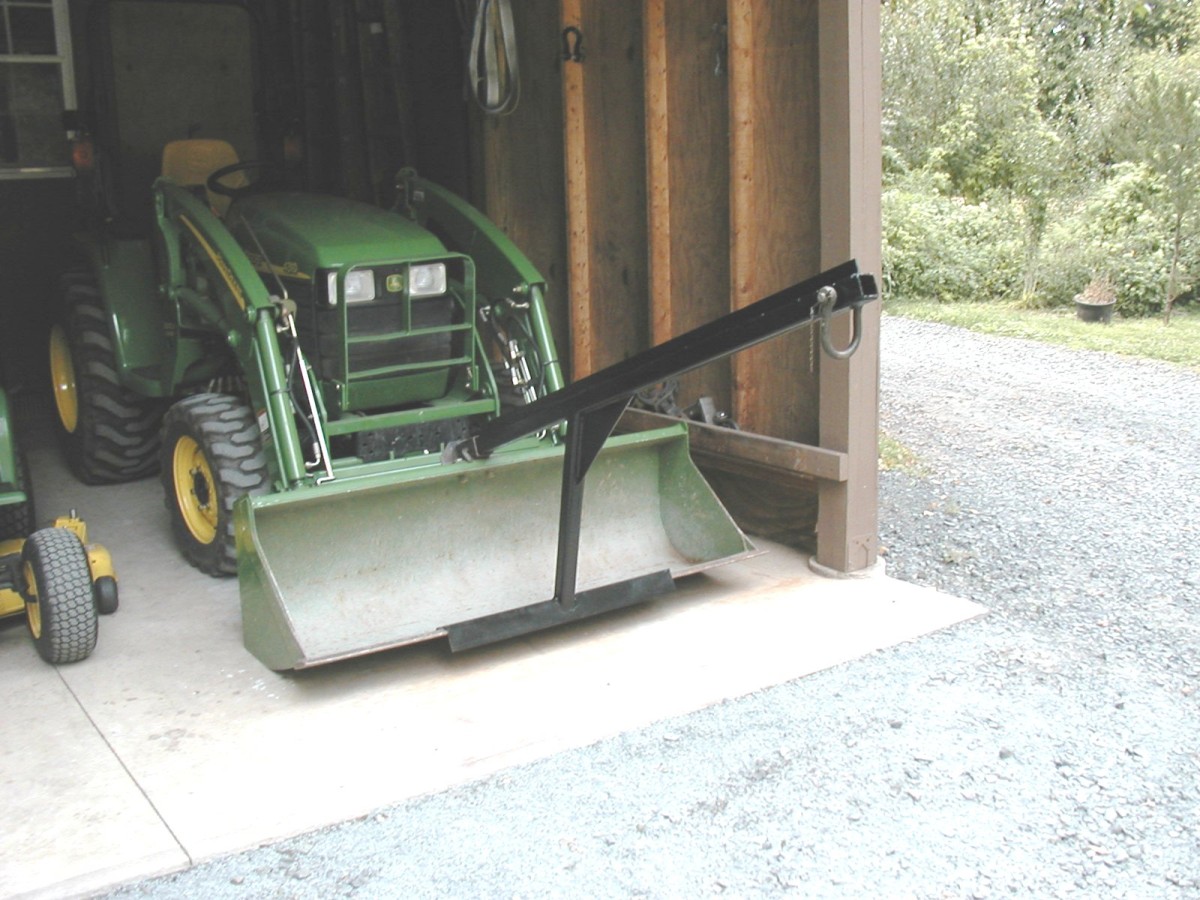

JB4310 said:
Bucket buddy revisited, made this extended lift pole today, I know I can't move the world with it but I figure 300-400 pounds should be OK, Just enough to be a ball buster saver. JB,
Pictures:
This is a close up of the T-shaped steel I welded to the top of the tube to stiffen it up along with the gusset at the fulcrom. The T stock came from an old garage door opener track, very heavy duty for that application.

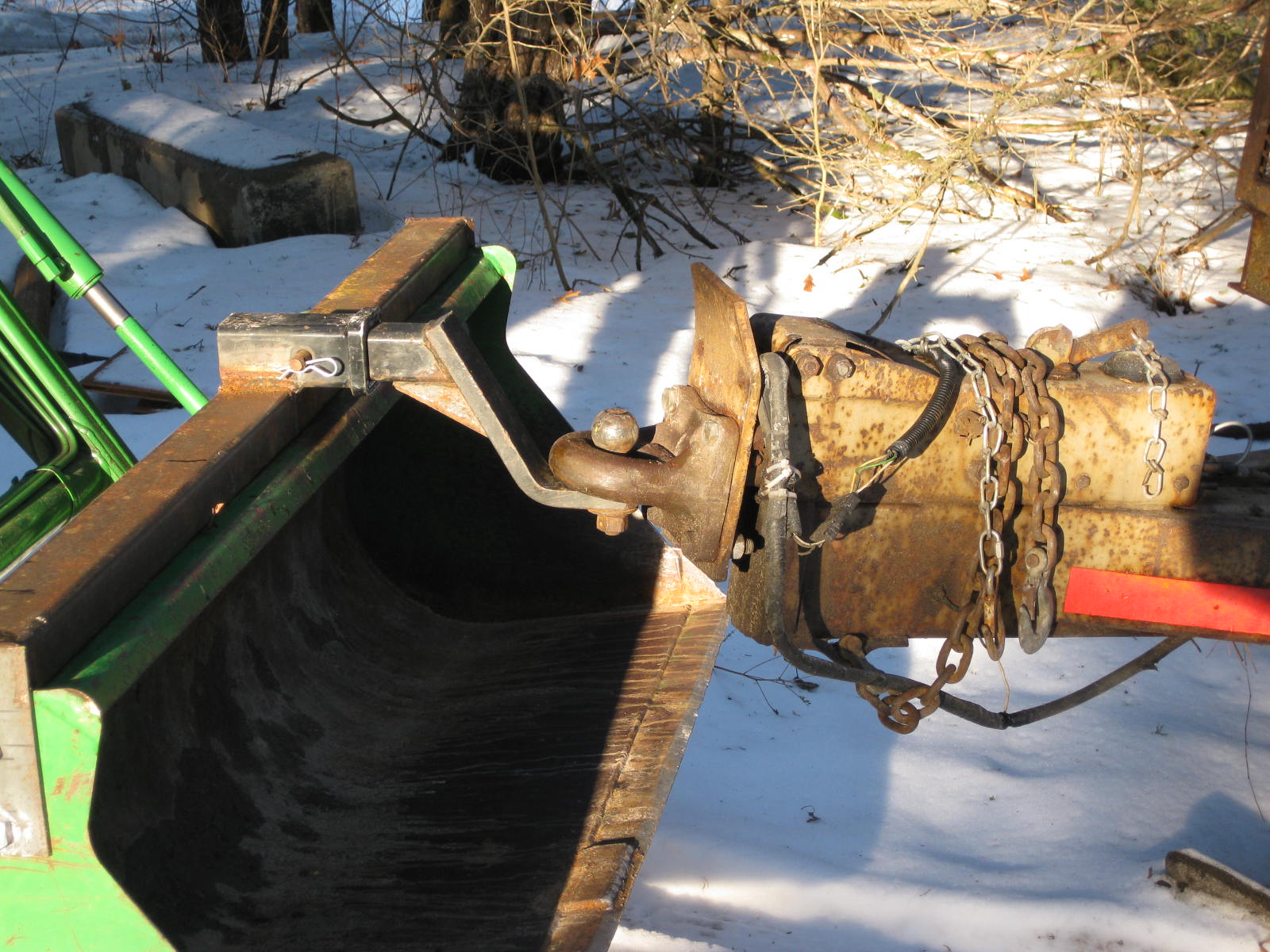

We must be on the same wave length. I built one for my D-15 AC today. The bucket of the TC - 55 is the next candidate. I have a 6' piece of tube that is just the correct size for the housing. Also various sizes of angle. I have about 4 receivers so this application was a natural. Besides I hate changing balls from 2" to 2 5/16" between two trailers.
I'm going to bolt mine in place because I can see a grapple in the future.

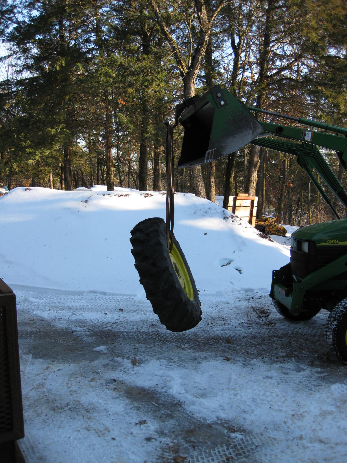

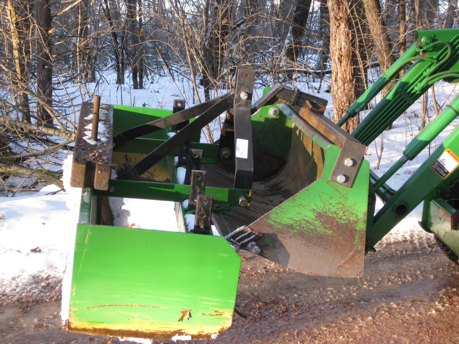

http://pacificcargo.com/catalogs/downloads/catalog-trailer.pdf
Page 6
I just noticed the date on your post. You probably already found a source for the hooks
   / Bucket Buddy instead of Weld on Hooks #26
I just found this post and I must say it is BRILLIANT! I am going to do this for sure. Thanks for the photos and details!!!
   / Bucket Buddy instead of Weld on Hooks #27
I use a 1 7/8'' ball on a 6'' drop works great, started using for more than I thought :D

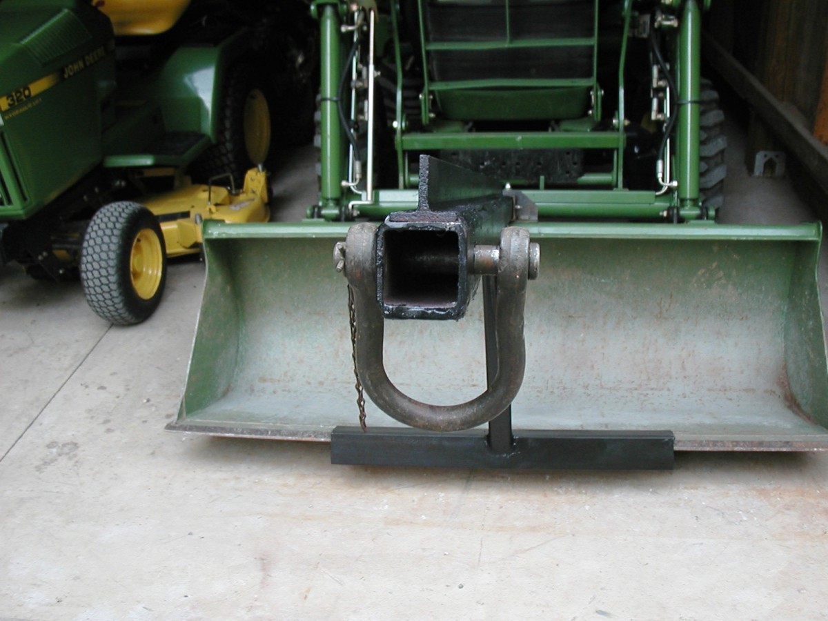

   / Bucket Buddy instead of Weld on Hooks #28
Is there any reason not to weld 3 of these on top of my bucket, one at each side and one in the center? That is what I think I want to do - ultimate versatility.
I have a Kioti CK30 and the bucket is "flat" on the top edge with a 1" square tube reinforcement on the inside of the top edge. Should I weld on a stiff plate all the way across the top of the bucket so it does not get bent before putting these on?
Comments?
#29
I was gonna say the whole idea of the receiver tube is the versatility and didn't think 3 of them was necessary, but check the link and see what this guy did. Now I'd say go for it, sure can't hurt, as far as your bucket needing any reinforcement I'm not sure but with mine it hasn't been an issue.
