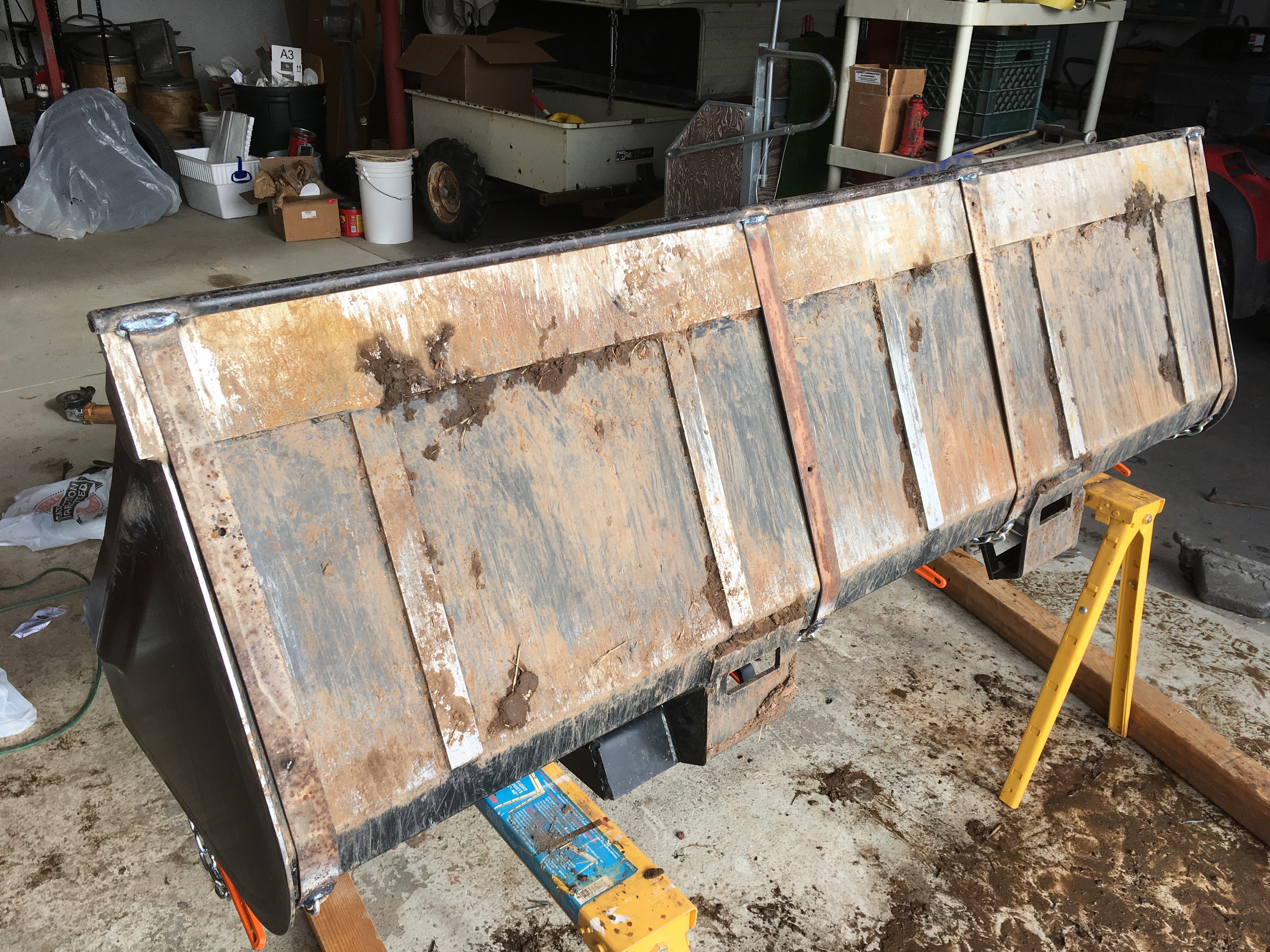

I have seen on here where various people built bucket edge protectors to reduce damage to lawns and such. This weekend I decided to build one and mounted some angle iron with slots for chains on top of the bucket. I should have taken more pictures but didn't.
![IMG_0943[1].JPG IMG_0943[1].JPG](https://www.tractorbynet.com/forums/data/attachments/475/475740-4e93814694f1ae66d7750be7d947d563.jpg)
As you can see, I slotted a 1/2" pipe to slip over the bucket edge. I left the ends long and unslotted so the pipe held its shape. Next I welded 4 each 1/8" x 1-1/2" strap to the pipe running underneath the bucket and a few inches up the back. I then welded chain to the ends of the strap. Those chains ran up the back of the bucket to the angle iron I had previously welded to the top of the bucket. I used cheap binders to tighten up the edge protector. Once everything was mounted I cut the pipe off about 1/4" from the ends of the cutting edge, then hammered over the pipe ends so they had no sharp edges and would hold the pipe centered on the bucket. Time will tell how good it works but I liked it enough I am thinking of making one for the snow blower on the back of the tractor.
![IMG_0941[1].JPG IMG_0941[1].JPG](https://www.tractorbynet.com/forums/data/attachments/475/475757-bbfbaac0285b830bae196a5b4da2c5cd.jpg)
This is the angle iron welded to the top of the bucket for doing chain work. I used 1/4"x3"x3" angle, I would have preferred 3/8" thick but couldn't find any around here. The slots are cut for 3/8" chain but hold 5/16" chain just fine. My previous tractor had one of these on it. It is a very handy feature if you use chains much.
