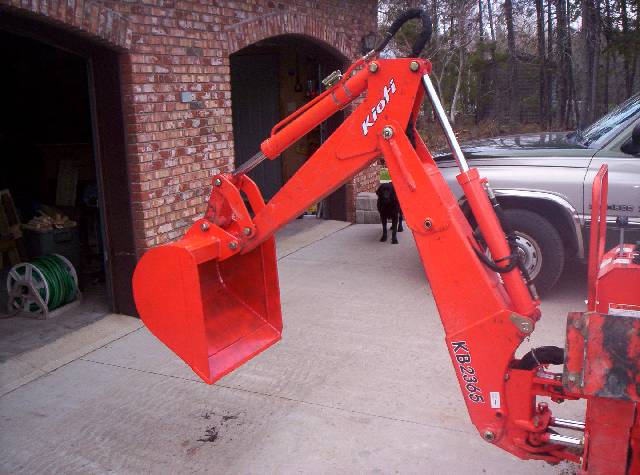

Hi , just picked up my kioti backhoe for a CK20 machine, it has a 9 inch bucket now and considering a 16 inch, main use is for landscape and some trenching, anyone used this backhoe with larger bucket sizes that can give me advise about use, is 16 inch close to the limits of this machine.
I assume the digging and breaking of the soil is performed by rolling the bucket, boom mainly for lifting, plan on building a thumb some time this summer to mave it more versitile, any tips on using will apreciated.

I would assume you have the KB2365 which is normal for the CK20. I have the KB2375 for my CK30hst. It also came with the 9 inch bucket. Works great for trenching. I added a 24 inch bucket to my collection. It makes fast work of softer soils without any problems. I used the 24 to clean up a small pond. Fully loaded and then some of heavy wet clay was no problem. I think there is a 16in and 18 in available. I'd go for the 18 if it fits your jobs. The specs of the 65 are similar to the 75. The curl does have a good bit of digging force but you will also find the reach will dig well also. Actually, it will probably drag the tractor back if you are into some hard ground. I think you'll be surprised at what it can do. You might want to consider installing cleats on the stabilyzers. Your dealer can order them or I just made my own from 2x3 angle.
Any specifics on the jobs, soil, etc, you can add will help the members answer your questions. Have fun with the new toy!
   / bucket for backhoe #3
I have the 16" bucket on my CK20 HST with KB2365. The dealer put it on before delivery as part of the deal and recommended it. I have not found a stump or rock yet that I couldn't pull out. Some take longer than others, but they move eventually. :D

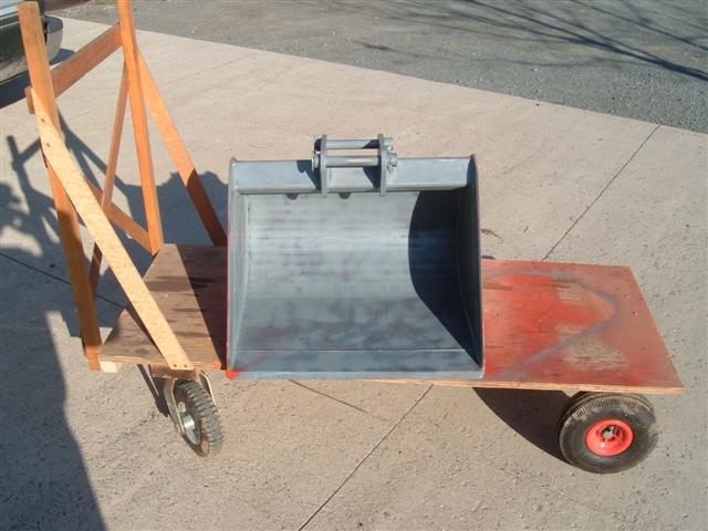

I had a buddy of mine build one for me. It's 24" and my 2365 handles it with no problem as long as you don't try and over do it in the harder soils.
Steve

Hi Steve, sure a nice job he did, I ordered the 16 inch and now the idea of the 24 inch for smoothing sides could be the way to go with no teeth, all the digging will be done by the smaller bucket, any tricks when using my backhoe you can share

You will be happy with that 16" bucket.
As far as tips, I have found that 2100 rpms is perfect for any backhoe work. I tried higher rpms for more power, but all you get is faster speed which makes it very difficult to work with. You will still hit the relief valves at the same time. Just swinging side to side will toss you around with too high a rpm. Anything under 2100 seems too slow, but you will hit the relief valves before the engine even thinks about dropping in rpms.
I have found that using two functions at once works better than one. While curling the bucket up, I will pull the boom closer to the tractor so that it does a sweeping curl rather than just curling.
It's all in the practice, there's nothing like seat time!
