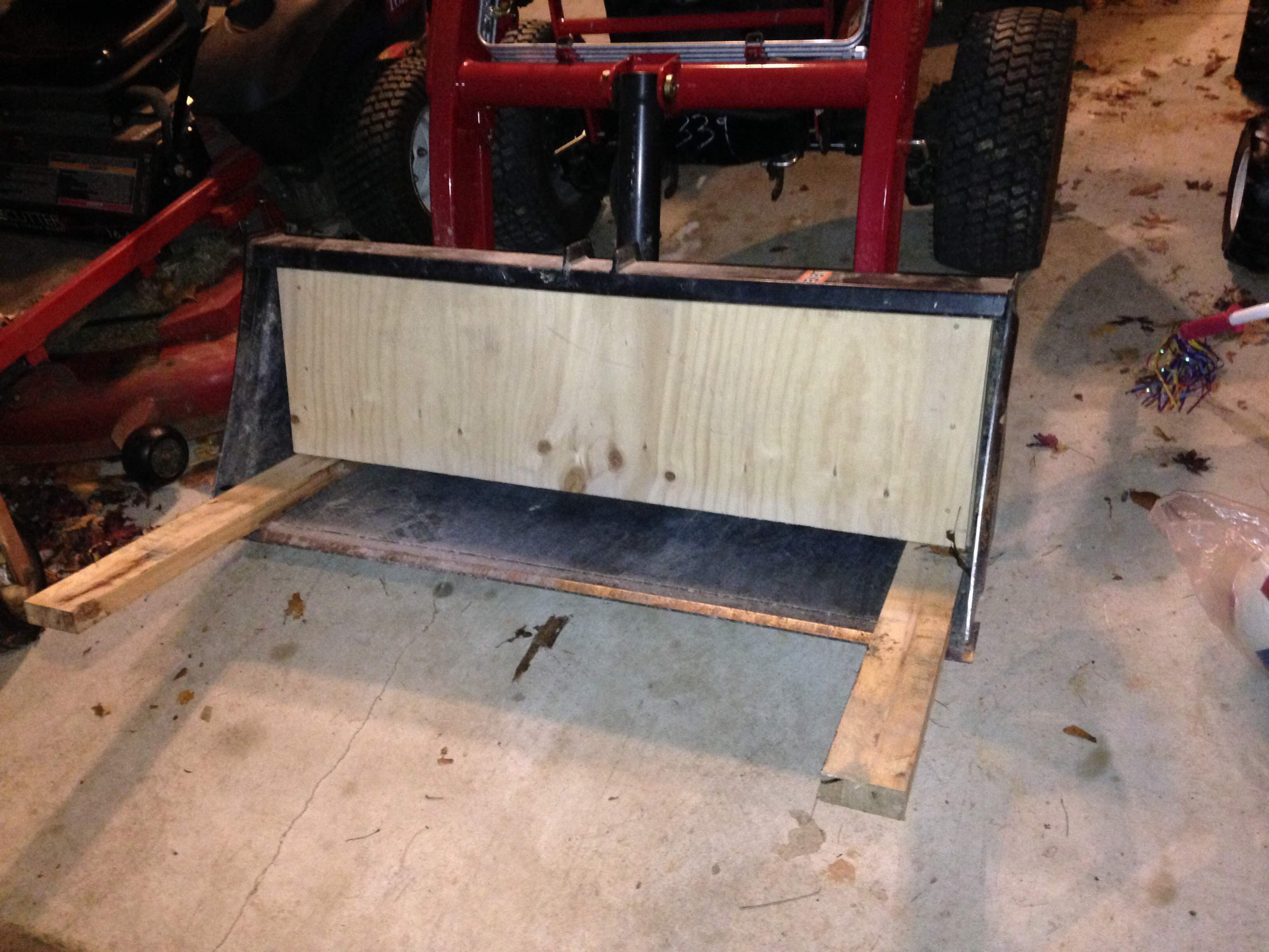

I built these for my emax 25. Very happy with how they worked out. The forks are 2"x4" hickory and significantly stronger than a pine 2x4. Behind the plywood there is an upright 2x4 that is tight to the top of the bucket, the plywood then adds lateral stability. I've had 4 12 foot treated 6x6 posts on there approx 600lbs. With zero issues, also free as it was built with scrap.
