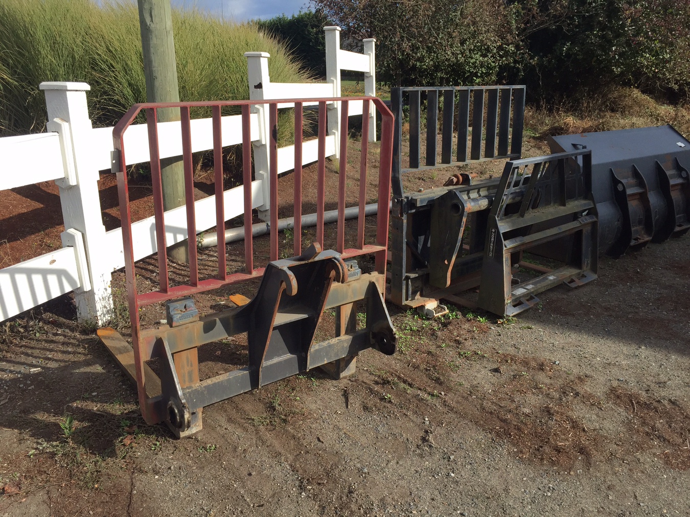

Yes I realize this is NOT the solution for most, but the best scenario would be to have a dedicated fork attachment with quick attach.
   / bucket forks hold downs #25
That's what I'm hoping to do maybe next year. Quick disconnect bucket never occurred to me when I bought my tractor, it's occurs now.
I just found a pic of my shop built two pallet setup with Q/A. I bought a single set, an extra pair of forks, extended each side of the frame and built a backrest.
I realize clamp on forks are handy and have their place but personally I view the as being akin to a strap-on d**k.
Never been much of a fan of “make do” devices.....
