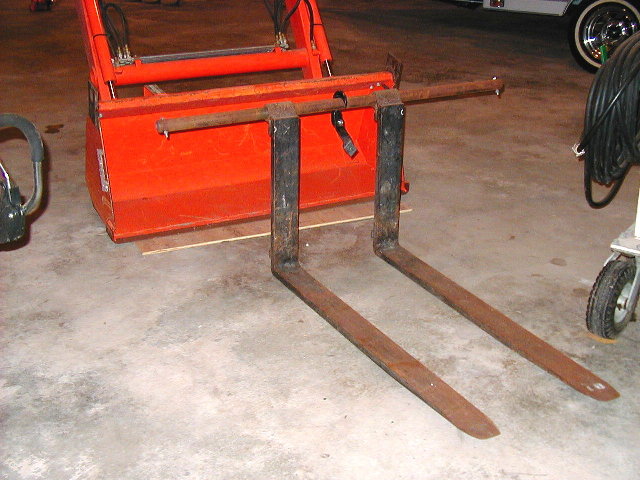

Alan, of course I made my forks with regular 4' forklift forks to go on the front of the bucket for my B2710. The forks weighed 90# each, so with my welding, I had an extra 200# on there. The biggest problem was that even with 4' forks, I had to stand up to see the front end of them when they were level, but they were certainly handy for moving brush piles, loading and unloading a 55 gallon fuel barrel in and out of the pickup, moving pallets of bricks (not more than about 150 bricks at a time on a pallet, etc.

<font color=blue>I made my forks with regular 4' forklift forks</font color=blue>
I couldn't find the post where you originally posted the picture, Bird, but I thought maybe some folks reading this thread might like to see your (former) forks, so I've attached it again here.
<font color=blue>The forks weighed 90# each</font color=blue>
That's interesting 'cuz that's exactly what <A target="_blank" HREF=http://www.tractorbynet.com/forumfiles/2-38933-BucketForks.jpg>my li'l clamp-ons</A> weigh, too.
