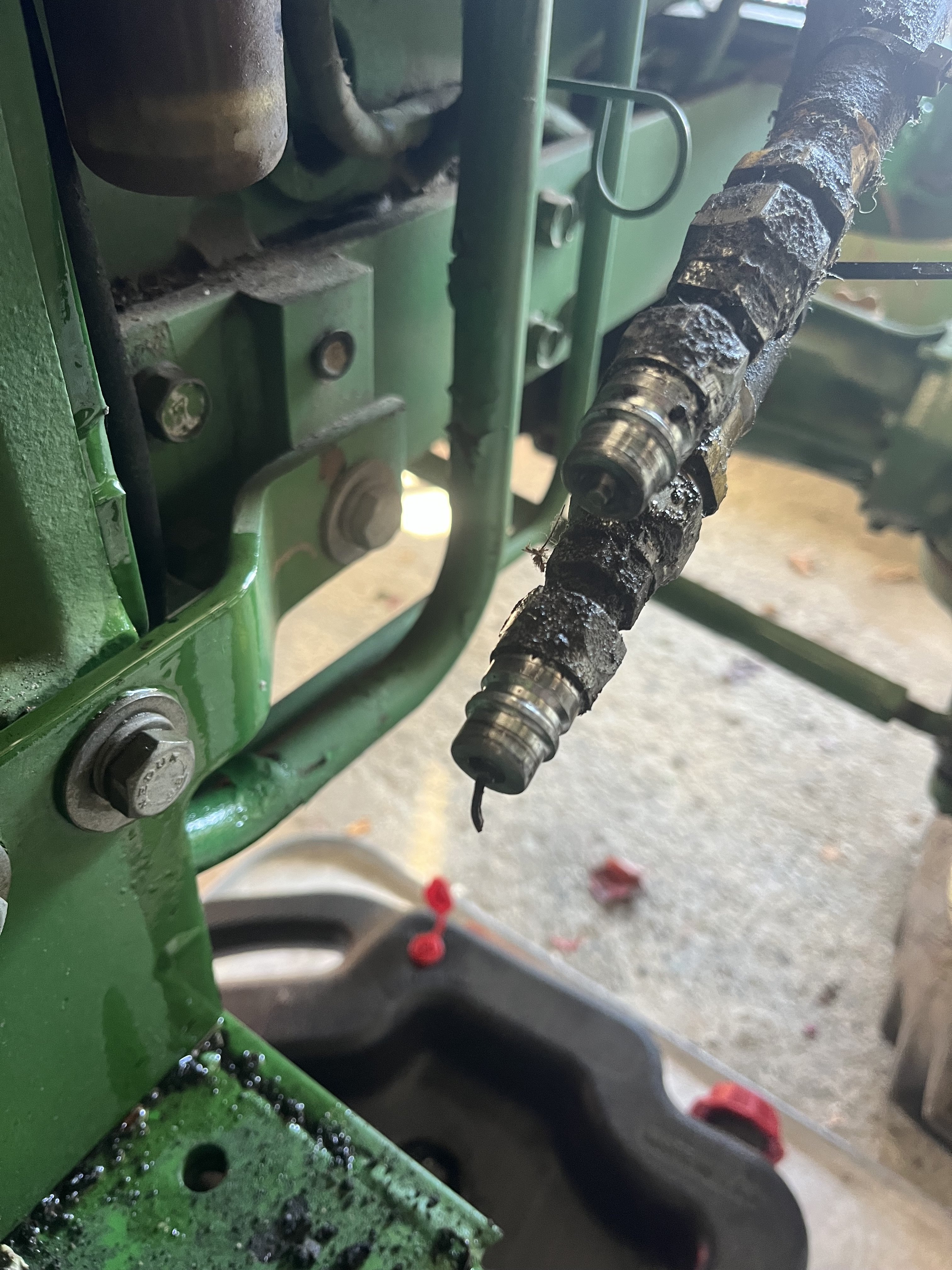

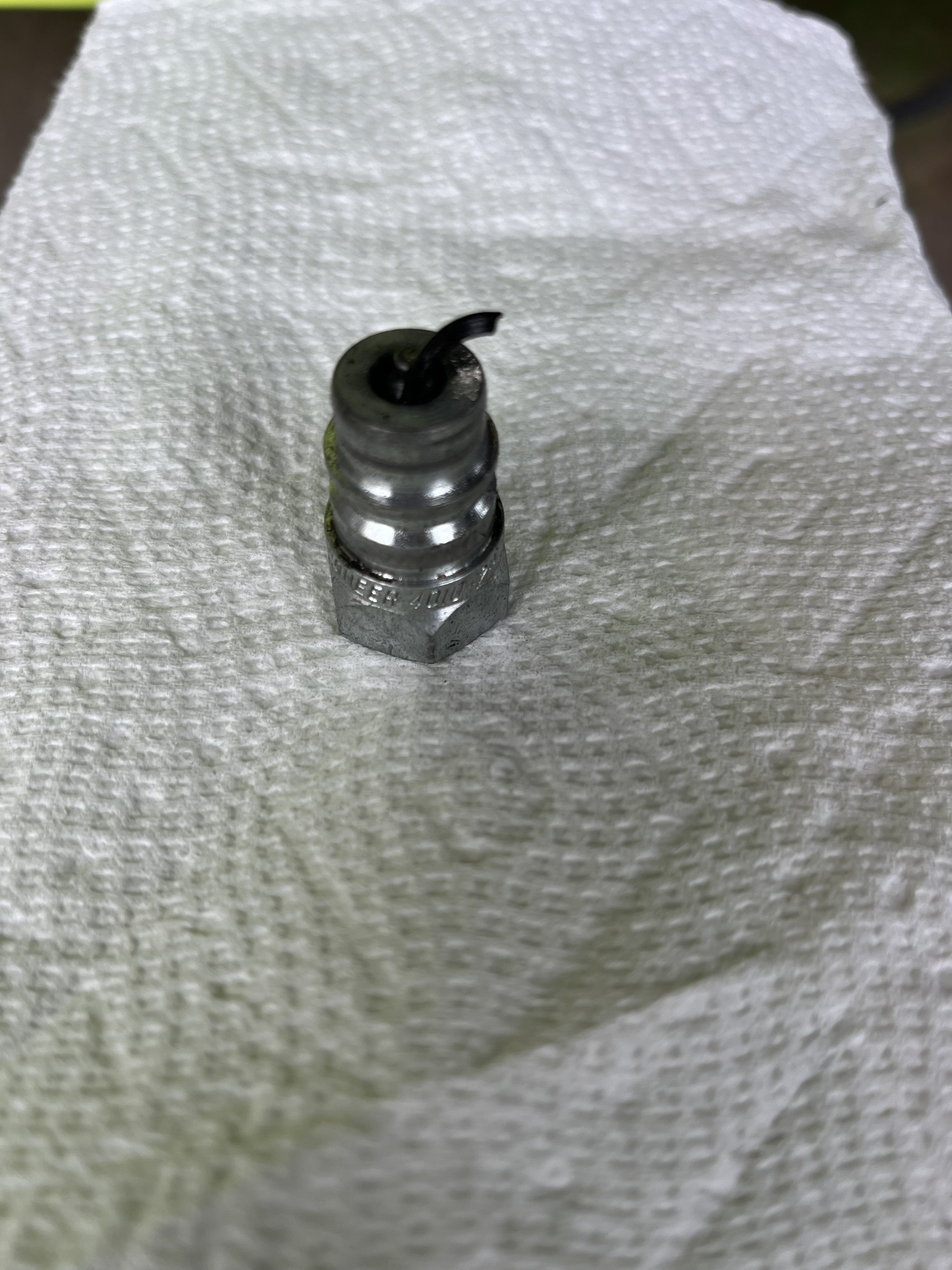

Update,
I switched the hoses going into my control valve and it did the same thing but the levers were just the opposite. So we then bypassed the rear hydraulics like someone suggested but that didn’t make a difference. I decided to try to rebuild the control valve, John Deere makes an o-ring kit for it so we took the old one all apart, changed the o-rings, put it back together and it’s working great, hopefully it will last! We did find a piece of an o-ring in one of the couplers so I bought a new coupler set and switched that out as well, not sure where it came from or if it was even part of the problem. Thank you everyone for your help, this is great forum for people who don’t have a lot of knowledge about tractors.
