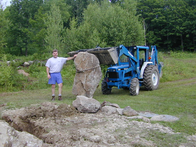

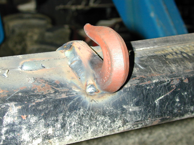

I finally got around to installing a hook on my bucket. Just a single 3/8 grab hook welded in the center. The hook had to ground to it the contour of the lip. I also had to reinforce the top lip of the bucket. The reinforcement plate is 1/2 thick by 6" deep and 72" long. The plate is/was a bolt of cutting edge from a Fisher snow plow. Shouldn't bend I hope.

Well had to try out the hook! Picked up the rock barely. The back end felt a lillte light even with the 2k lb. backhoe on the back. The chain is a 3/8 grade 80 chain. My guess is the rock weighs about 1700 lbs. I could (barely) pick it up with the lift arms. But the curl could pick it up higher. The hook or bucket didn't bend, yet.
Hey Harv, I wish I could say I took it with a timer and make a mad dash to pose for the camera. Well I didn't, had my father take the picture. I haven't found that little wedge thing that hooks the camera to the tripod /w3tcompact/icons/frown.gif.

YIKES, Derek! /w3tcompact/icons/shocked.gif
That's twice as much rock as I could lift with my li'l Bota! Hope you were wearing your steel-toed shorts that day! /w3tcompact/icons/crazy.gif Heck, I'd worry about the front of tractor, too.
You know, you could have just told me you did the mad dash thing, and I would have believed you. /w3tcompact/icons/wink.gif
<font color=blue>I haven't found that little wedge thing</font color=blue>
I assume that's why you're looking under rocks. /w3tcompact/icons/laugh.gif

Thanks. We gotta do your bucket next. I'll come up help you get the bucket off, drive it up to the shop and weld it, bring it back home and we'll put it back on. I knew the hook would be handy to have but this is the greatest. Attached is a close up of the hook. Did a little grinding and it fit pretty well.
