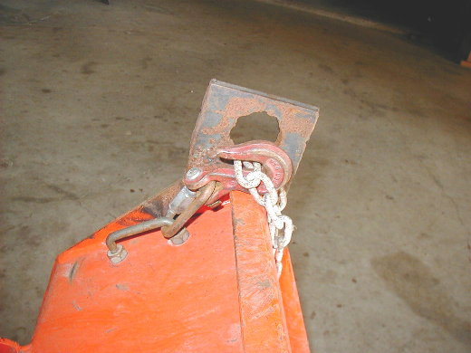

Has anyone tried to bolt the hook on their bucket ? I do not have access to a good enough welder and was going to see if I could get a hook that could be bolted on .

I used a bolt on tow hook and it works well. Only drawback is it's a slip hook, not a grab hook. I use a "grab ring" when I need a grab hook there. It's a forged ring with a grab slot at one end. Minor inconvenience, but saved me having to weld /w3tcompact/icons/smile.gif
   / Bucket hook reinforcement #15
Ray, I drilled two holes on each end (on top) of the bucket and mounted my hooks on U-bolts, so I can swing them forward when I want to use them, and they lay back out of the way the rest of the time. I welded brackets on for my fork lift forks and welded hooks would interfere with that.

Bird,
Can you post a picture of your hook setup? I bought the weldable grab hooks (no clevis), but I like your idea. Is it strong enough?

PaulT, here's a picture of the hook on one end of the bucket; laid back out of the way.

And here's what it looks like with a chain attached. Of course, when the hooks are not being used, they swing around a bit and take some paint off the bucket. And I bought Kubota paint to paint the steel plate I welded on the end of the bucket for my forks, but never applied it./w3tcompact/icons/frown.gif Anyway, I mounted my hooks like this for two reasons: (1) used material on hand without buying anything/w3tcompact/icons/laugh.gif, and (2) they're out of the way when I want to put the forks on.
