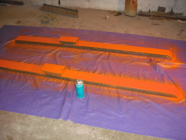

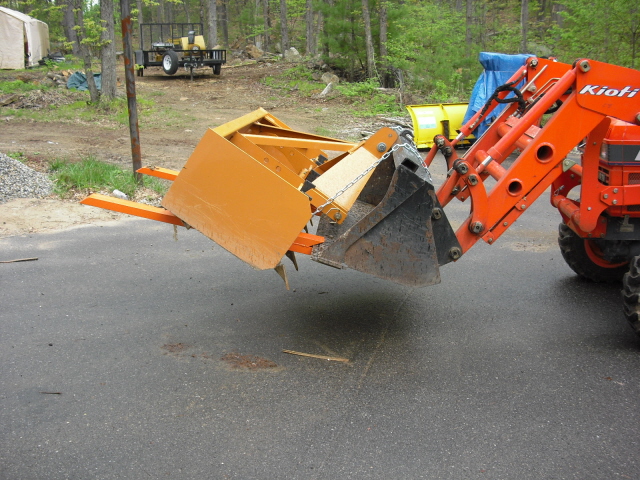

The only item I've found to be handier than my bucket hook are my forks. They are amazingly versatile. I can pick up just about anything and being able to easily move pallets around, I can now put stuff on pallets and then move around that way. Nothing better for logs.
I really like my pallet forks, and man were they easy to build. $40 worth of pallet rack steel and chain and a little cutting and welding and I was done.
Joel

The only item I've found to be handier than my bucket hook are my forks. ...
Joel
Hey Joel,
Any pictures of your forks? I have some pallet rack steel hanging around looking to be used.
Clem
   / Bucket hooks, should have done it earlier. #19
Not trying to hyjack thread, I really do use my forks all the time.
Joel
