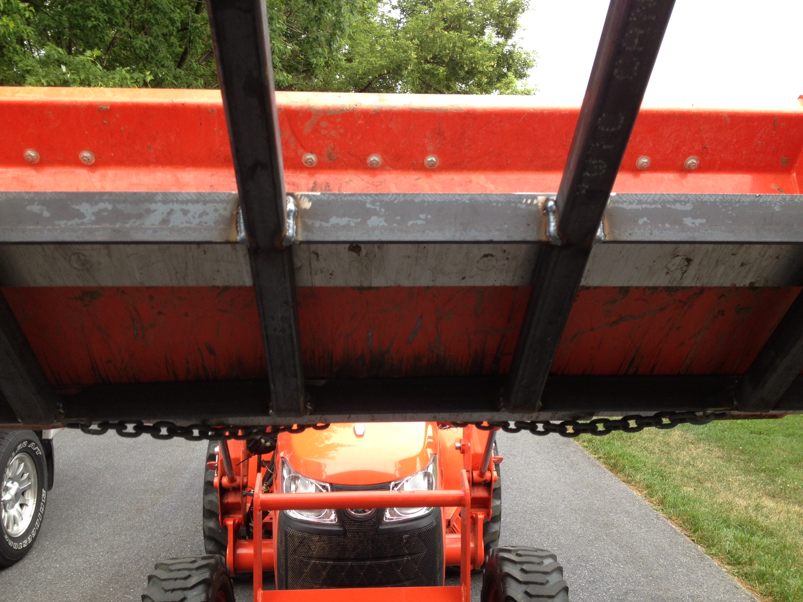

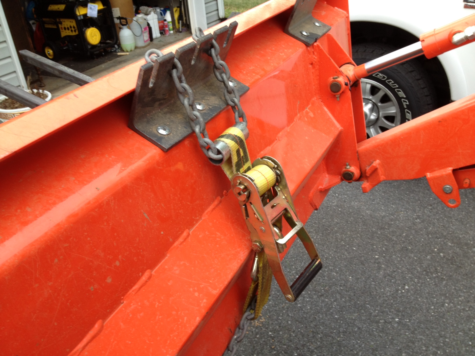

Have you ever had a chain pop out of the slot? thinking a 1/2" wide x 1/8" deep horizontal groove ground out at the bottom of the slots would grab the chain, but also thinking that would weaken the attachment. hmmmmmm...
No, never had the chain come out unless I wanted it to. I'd hesitate to make the chain more captive than it is, because as mentioned earlier sometimes it's nice to be able to roll the bucket and not dismount to disconnect.

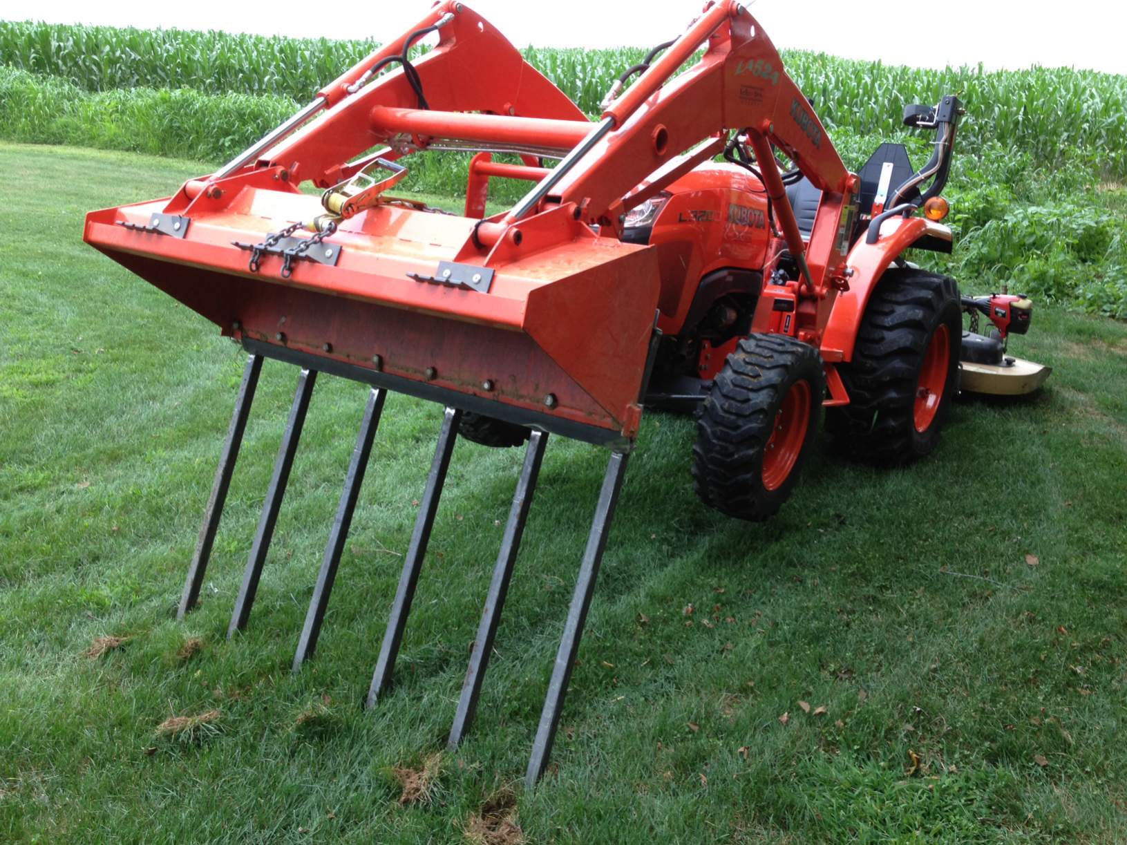

I use the same slotted steel to mount the brush forks. The forks are welded to a common angle that slips over the bucket lip. A heavy binder ratchet connects to a bridle chain on the forks.

The extra slots are mostly for keeping extra chain out of the way. There are times when I'll pick something with only one chain. Like Wednesday evening I picked the rear blade to put it in the shed. For storage it sits on the face of the blade with the frame locked so it takes up less space. Dropping the extra chain into the spare slots kept it out of the way. Without plenty of slots, extra chain would probably end up being carried in the bucket and getting dumped out when I roll the bucket.
There are times when I want to pick something and keep it parallel with the bucket using two chains. Then the outside angles are used and there are still plenty of slots to drop the extra chain into.
The bucket doesn't roll far enough to dump the load and the chains won't slip out of the slots until the top of the bucket is roughly as low as the connection to the item being picked and moving away from it.
Making decent slots was just a matter of drilling holes and sawing to them from the edge of the angle.

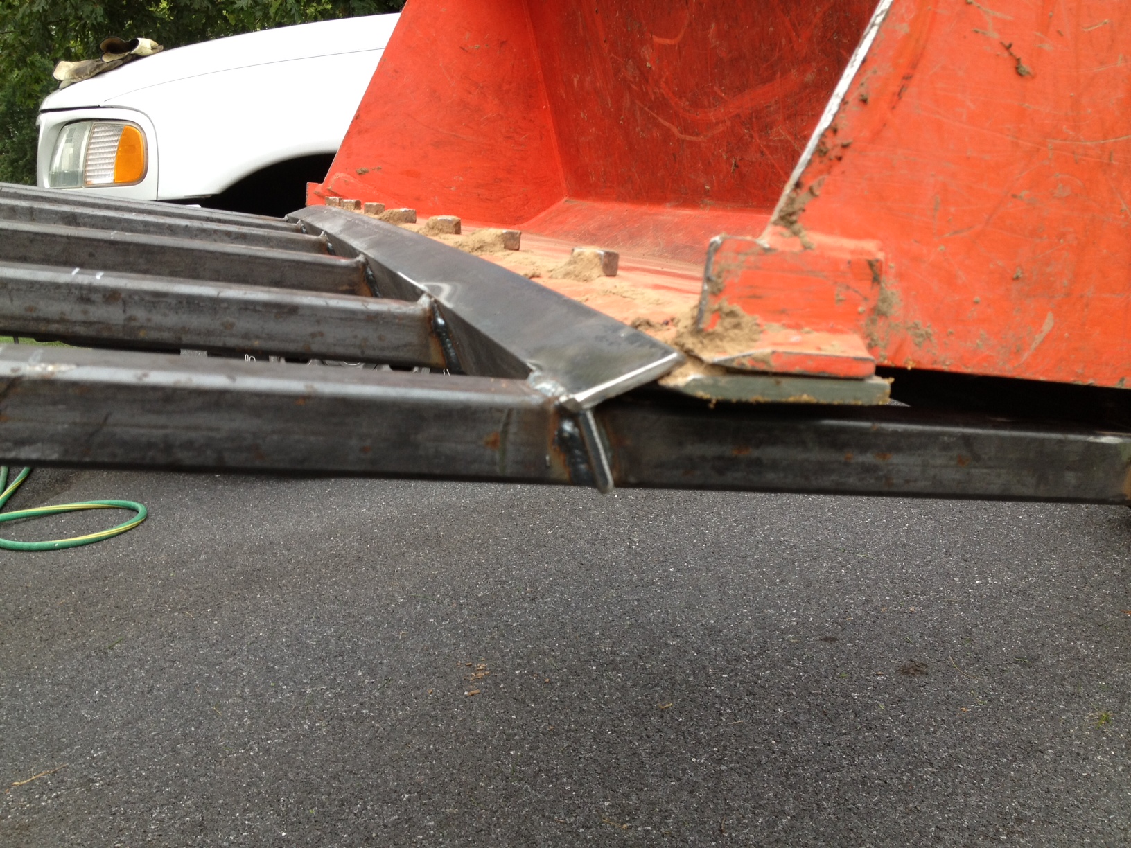

Hey Chim, when you get a chance, can you take a snap-shot of the underside of that fork set-up.
I have similar forks, and I like your set-up, I'd like to see what it looks like underneath.

The loader and forks are off now, but here are a couple shots I took a while back. The chain is welded to two places on the back of the fork frame to form a loose loop. The load binder grabs the chain loop.
