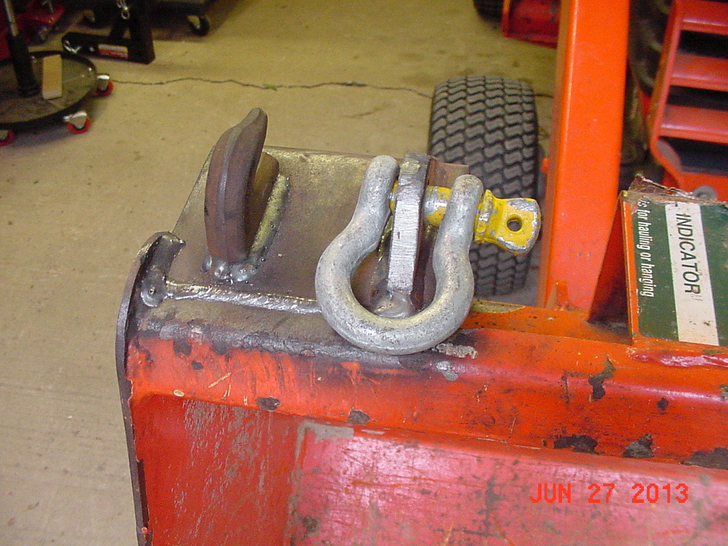

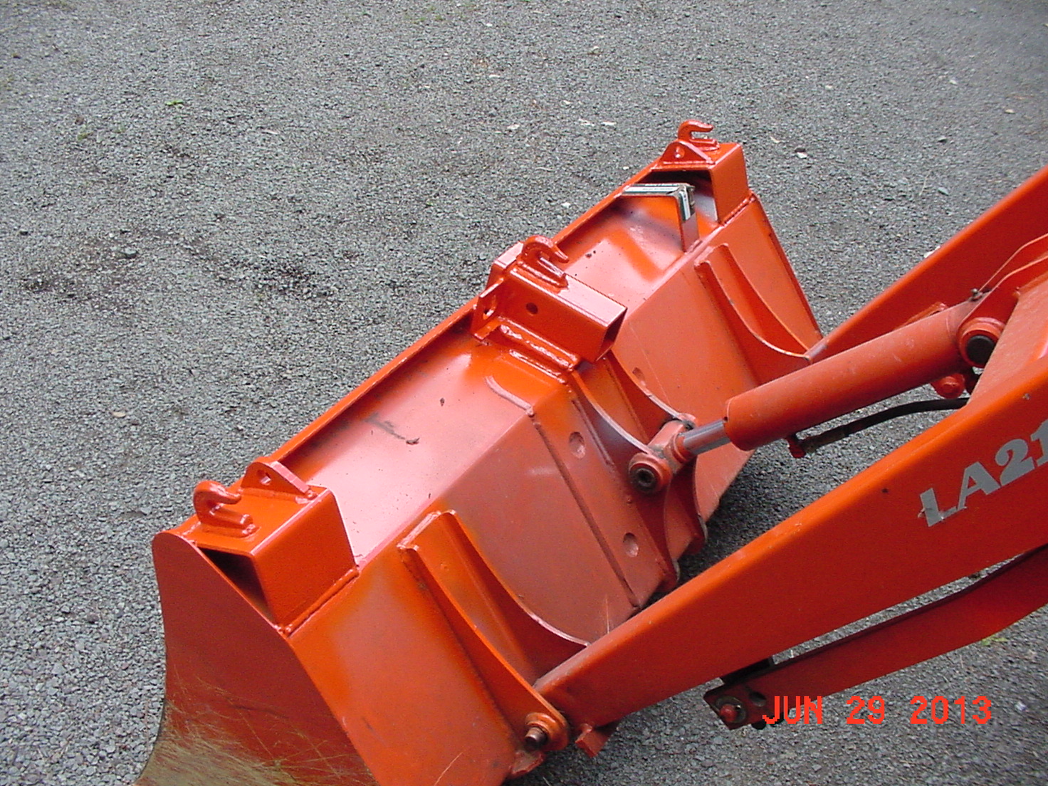

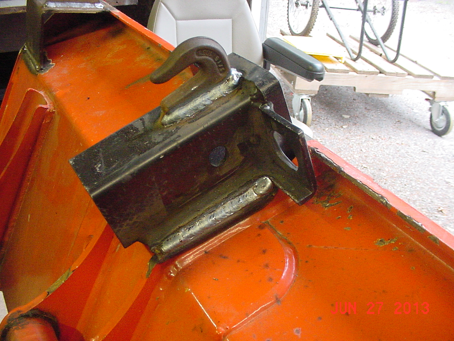

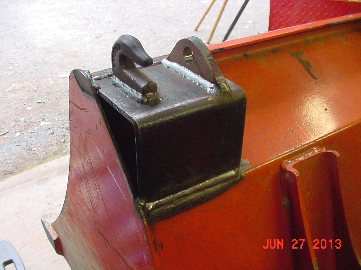

/ Bucket hooks #10
In line with the loader arms. is best,
Yep, and my bucket needed reinforcement (in my opinion) on the top to avoid bending the top lip. I did it similar to Timster did in his pictures above.
/ Bucket hooks #11
I second James.
When moving tree trunks on the bucket, you will usually want one chain securing the load on each end.
When you pull out 2" - 3" trees with the roots, using bucket roll back, it is best to have the load lined up with the lift arms, where the bucket has the most support.
When dragging out moderate loads from the woods, to make them more accessible, frequently there is not space to push the entire bucket it. With in-line mounts, you can go in a little deeper with one corner of the bucket.
For heavy loads, don't use the bucket, use the rear center drawbar and a clevis mount grab hook. (Some sub-compacts and compact tractors require rear center mount drawbar to be purchased as an option.)
DON'T MOUNT HOOKS ON BUCKET ENDS. Torsion loads can lead to a "sprung" bucket.

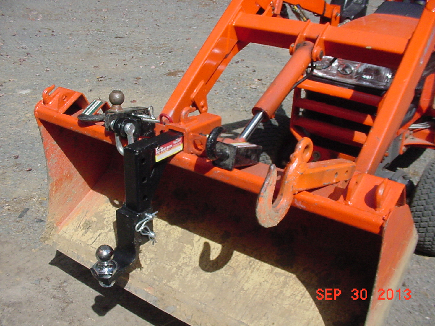

/ Bucket hooks #14
With the receiver hitch mounted in the center I have lots of options for lifting, towing etc.

/ Bucket hooks #18
<img src="http://www.tractorbynet.com/forums/attachment.php?attachmentid=366237"/>
You sure do. Very nice.
