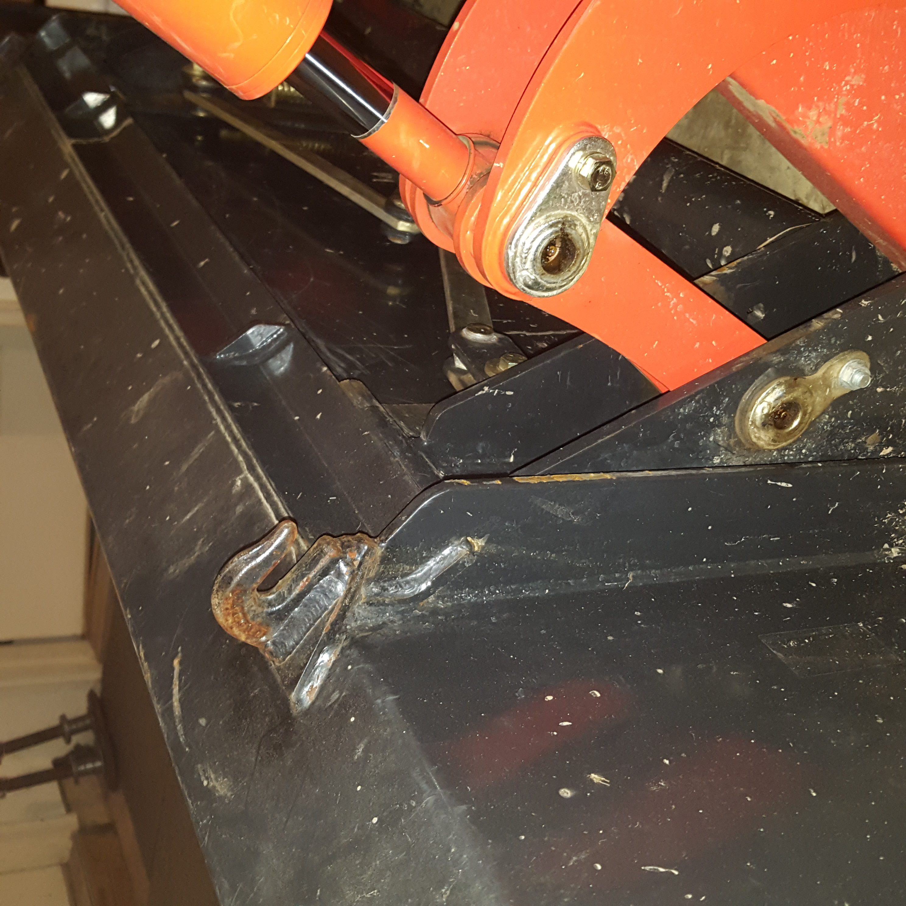

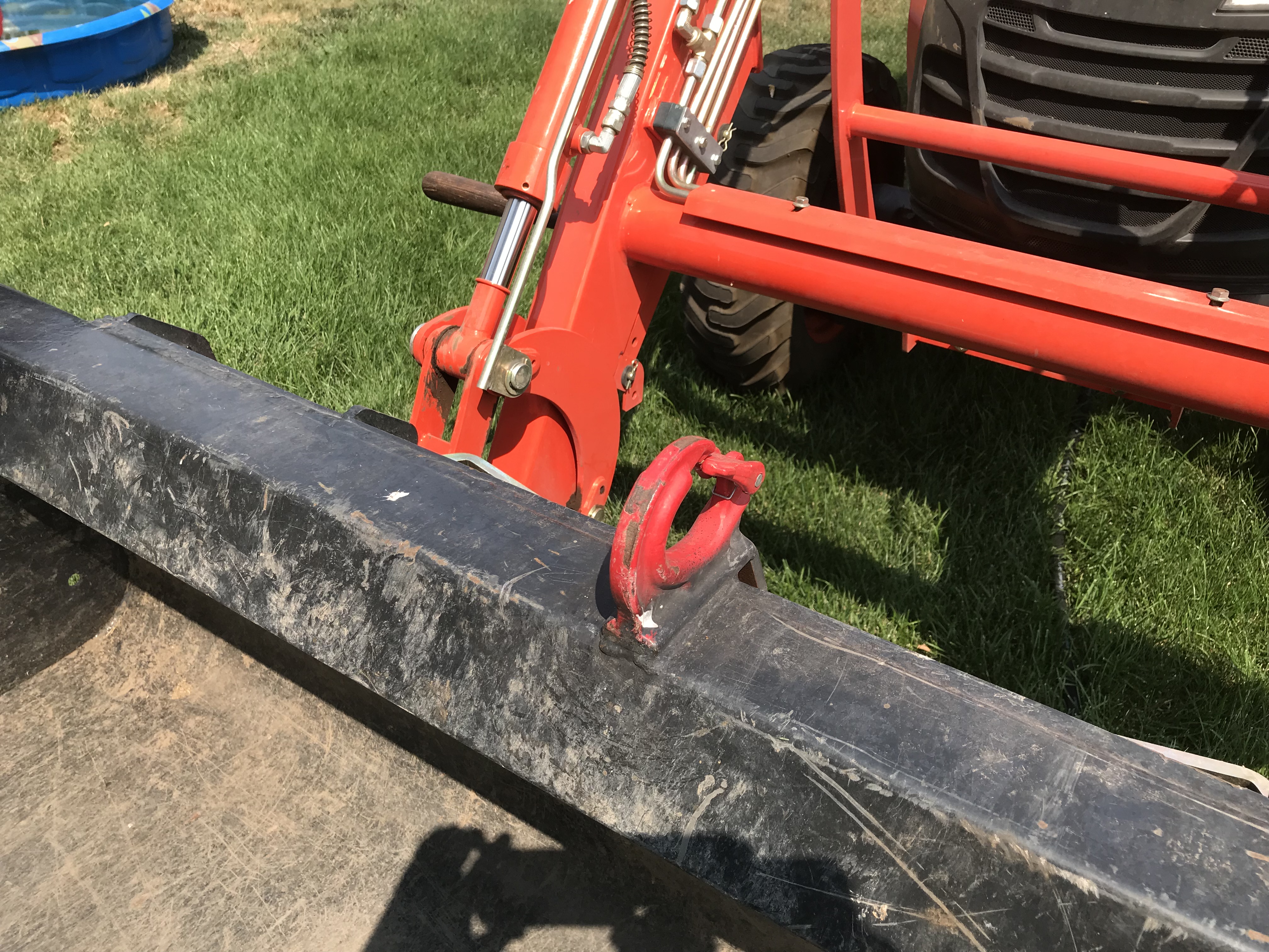

My CK 2610 loader bucket is boxed across the top edge. This seems to make using bolt on chain hooks improbable. What type of set up is best suited to these buckets? Thanks!
Are you certain? Mine has a space right be hind the boxed in "tube". Its the standard 60" Kioti supplied bucket. Just enough room existed to drill through a single metal into a very stable spot lined up nicely lined up on each lift arm. And furthest back on the bucket edge I would think preferable anyway. The strongest point in the bucket is the area that the lift arm attaches. And by putting one on each side you get an even lift right straight on the arms. Both sides.
You have to measure correctly but there was enough space for both bolts, nuts and washers. The hooks I got from amazon have the holes for bolting on each side (link attached for source). Not front to back. You have to be very precise in order to be able to get the big thick washers to center as there is just enough space with little to spare. You only have I'd estimate 1/4" of play room. If not you'll likely have to grind or trim a washer. I measured these all out on tape applied to the top and spent a bit of time laying the holes out.
These are mounted right behind the boxed area in about a 3" space that is only one single thickness. Works perfectly with this style of hooks.
Link to amazon source for hooks: Amazon.com: Set of (3) Titan 5/16 Bolt-On Grab Hooks: Home Improvement

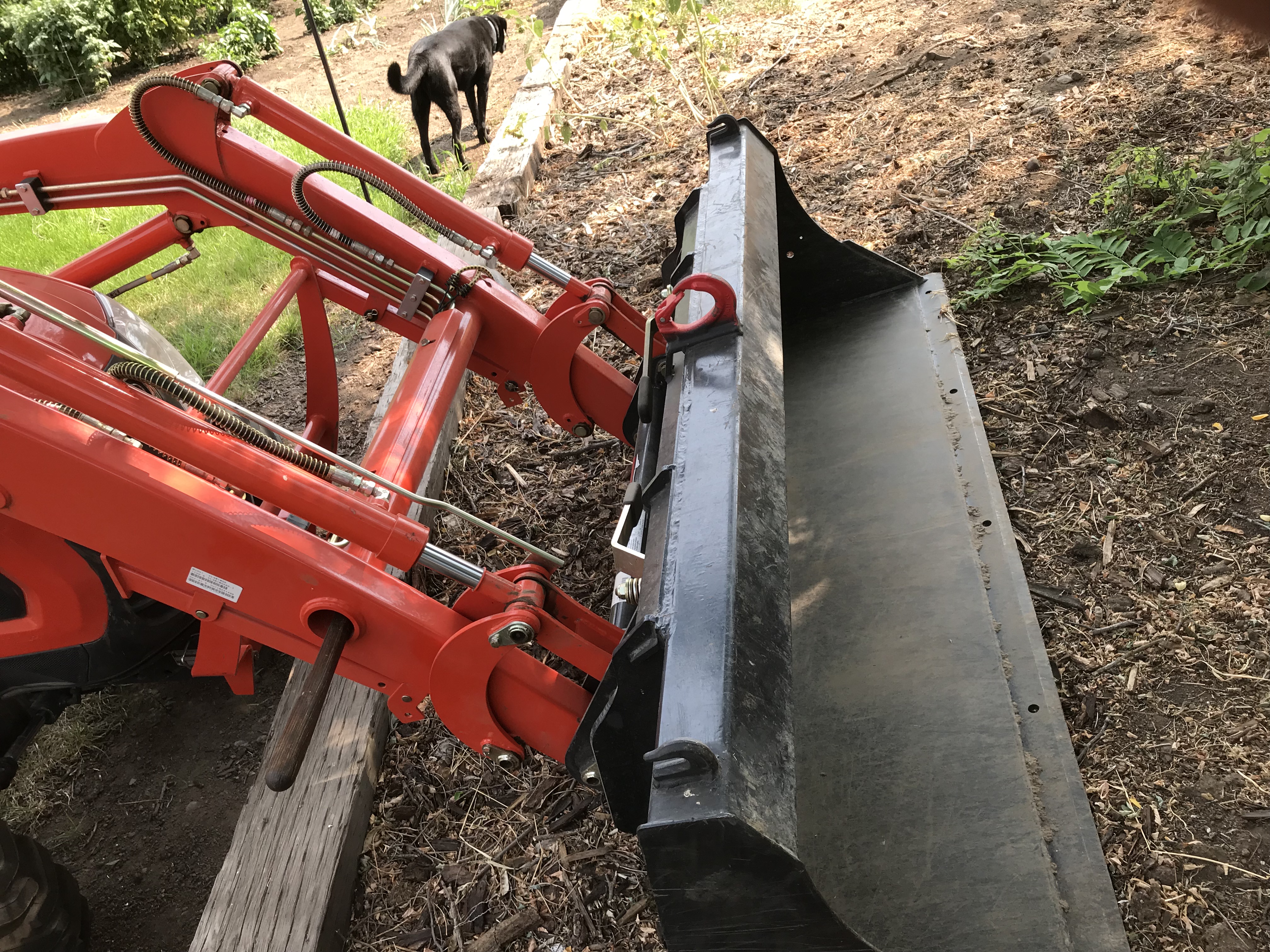

I have a post where I welded c-channel across top of bucket then welded chain hook to middle of c-channel. I’d never put a hook straight on top of bucket without c-channel. Certain to bend top of bucket.
/ Bucket hooks #24
Joel, is your C-channel the width of the bucket? Any pics with that post, and could you share a link to it on TBN? It might be tough to find otherwise.
Yours is a good idea, although probably not practical for most owners. Thinking more about this, 5/16" welded grab hooks with reinforcing plates would be an easy, inexpensive item for manufacturers to install standard on buckets, so I'm guessing there are other reasons they don't. Maybe concern about creating an invitation to misuse. :scratchchin: Even if adequately reinforced to minimize deforming the bucket, improper use can damage loader wrist pins and even cylinders.

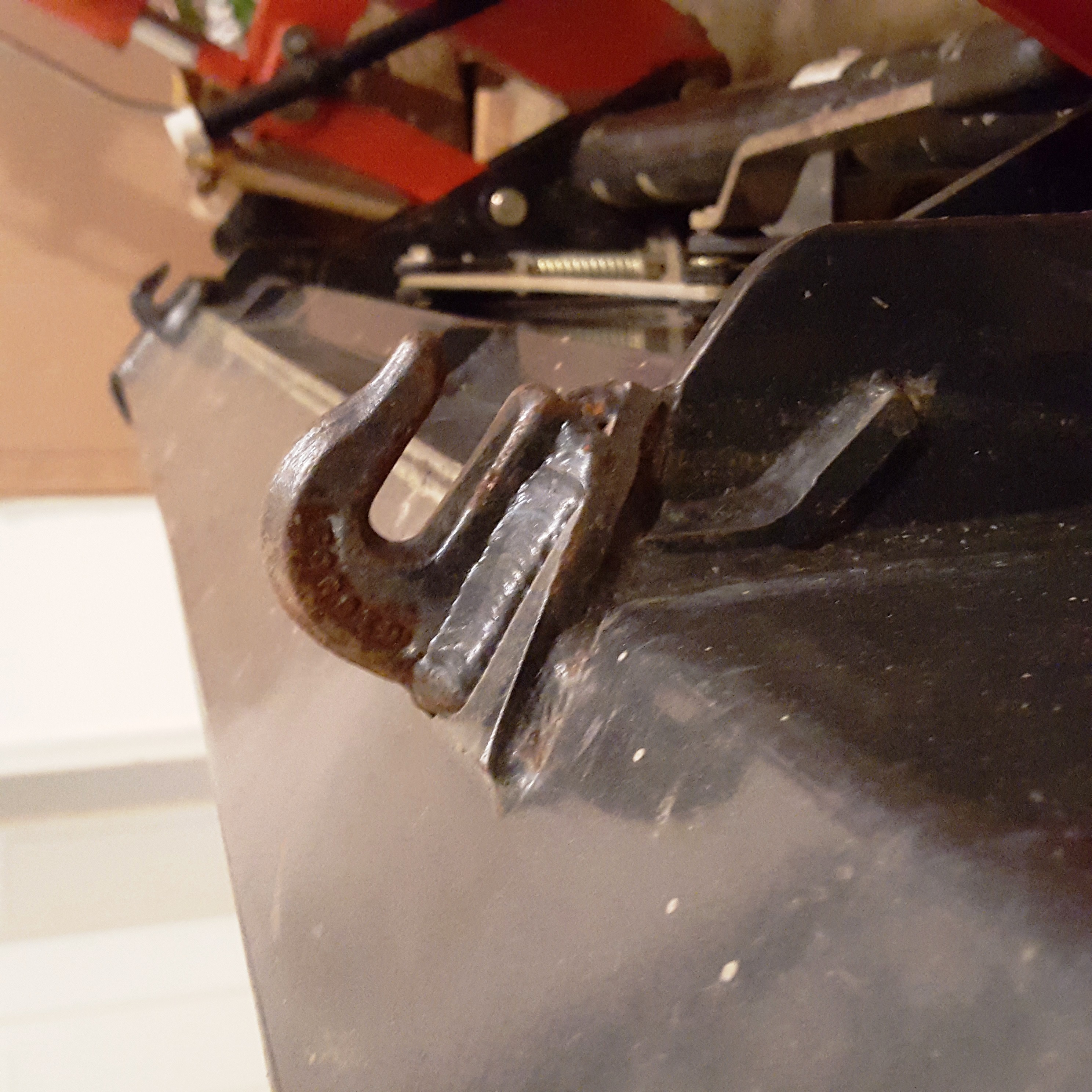

Here's the post with my bucket hook install. I've had it for years now and has been one of the most useful attachments I have.
My logic for the method is as follows:
1) I did not want to bend the top of my bucket like so many have.
2) I wanted to strengthen my bucket, which is why I'd never drill a hole in the top edge of my bucket. Also why I installed cutting edge at bottom as well as c-channel at the top.
3) I went with middle of bucket as I wanted no twisting force on my bucket and loader arms.
4) I went with weld-on as it will never come off for any reason based on my type of use of the machine.
After almost 10 years of use I have no regrets and my bucket remains dead straight.
