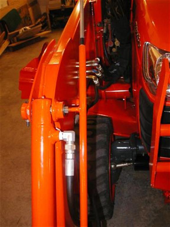

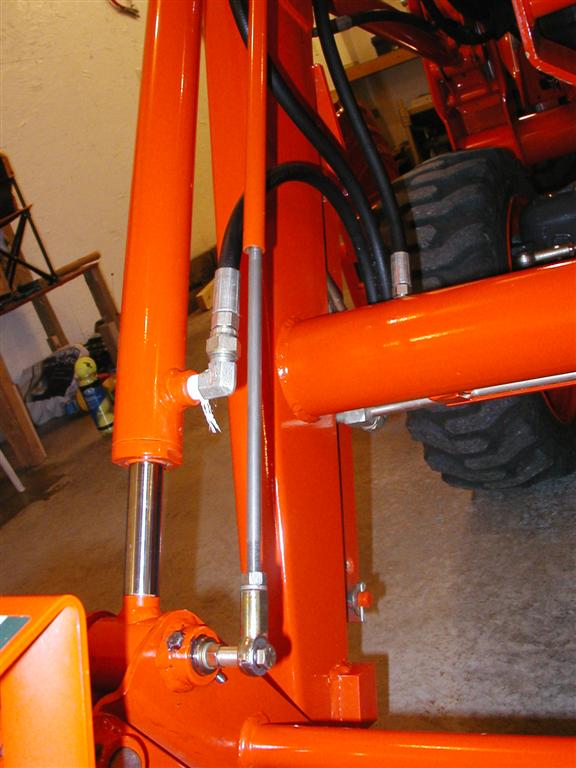

Alot of people have made bucket level indicators. I made one for my B3030 because i didnt care for that bracket either. I didnt weld anything on the loader. I just drilled and tapped the loader pins in a lathe ect ect. Just wanted to show you mine so you can get some ideas for yours.

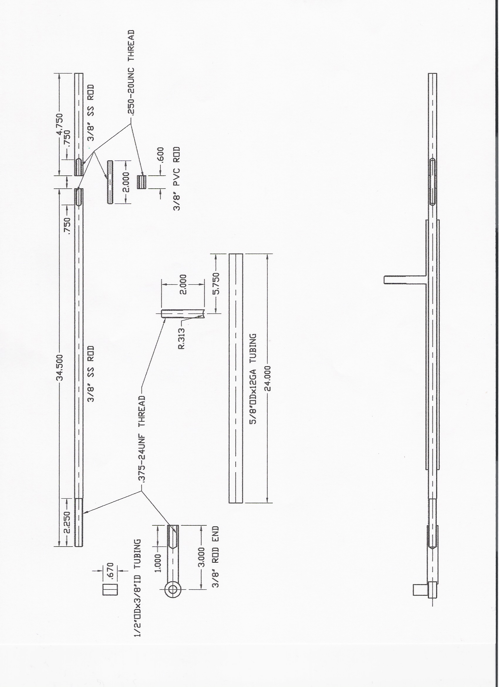

HuntThomas here is the print for the B3030 level indicator I promised.

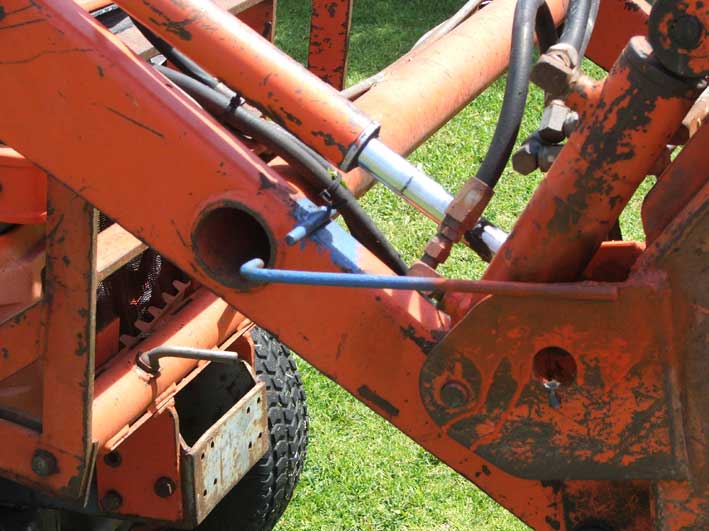

Mine isnt pretty but the price and fabrication time were about right. (Free and 10 minutes.). When the two blue rods line up perfectly the bucket is level. I have to line 'em up before I drop the loader. Or, if its on the ground, I have to lean out the side to see it. I'll add something better one day, but for now this is a lot better than nothing.

Well alchemysa i think yours is much beter than that stock bracket.
