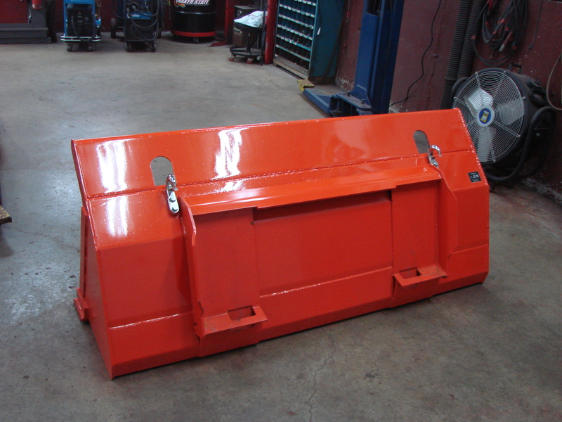

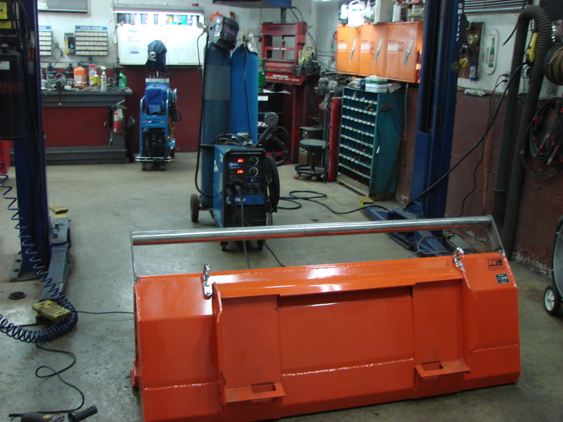

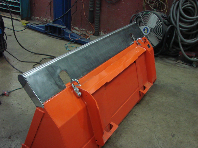

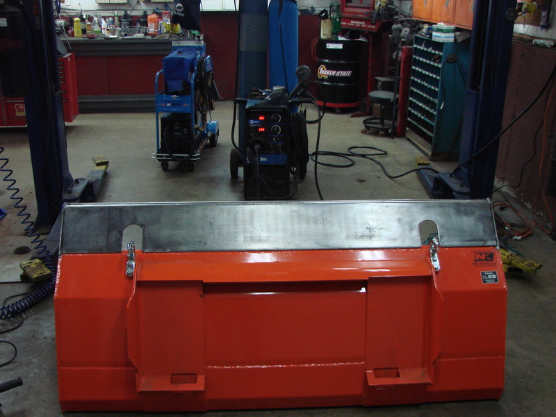

Well considering I'm going to be plowing snow and snow only with my tractor I've never liked the fact that the back side of the bucket wasn't very high. All the equipment I've ever operated that had a bucket always had an extension on the top of the bucket to reduce the chance of snow falling off the bucket and either hitting the engine hood or the windshield. I decided to change my bucket and this is how it turned out.

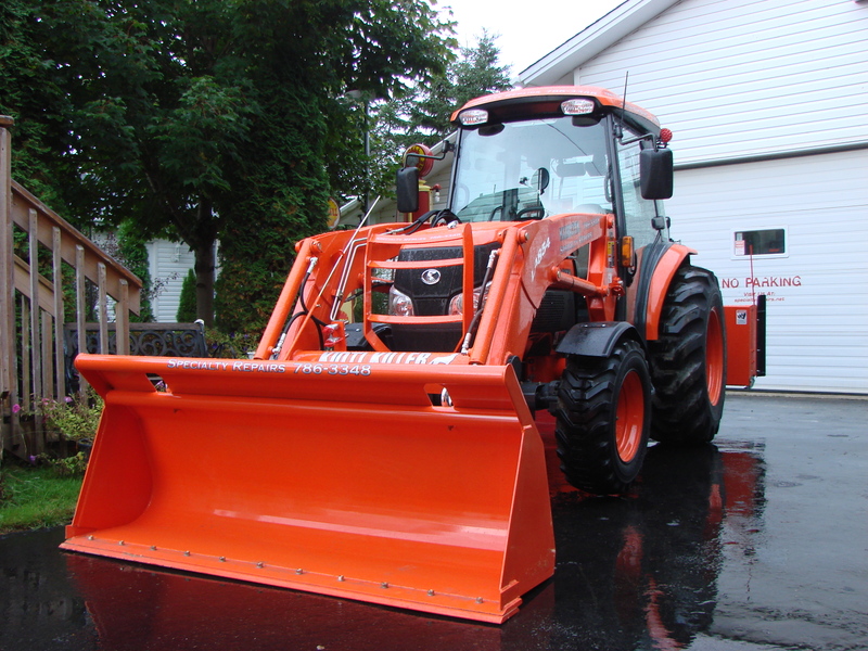

Completed pics

Nice piece of work!
I wish I could weld / fabricate like that. I just had a buddy fab a 12" high expanded mesh extension like yours, surrounded and braced by 2"W x 1/4" thick flat steel. I have a 6' SS utility bucket for snow use, and wanted to make my 5' factory dirt bucket more versatile in the brush pushing and piling department.
It also acts as a decent brush guard when tooling around the woods and swamp, and I can still see through it fairly well for close-in work.
