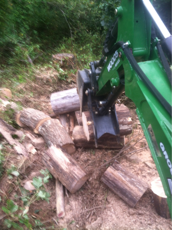

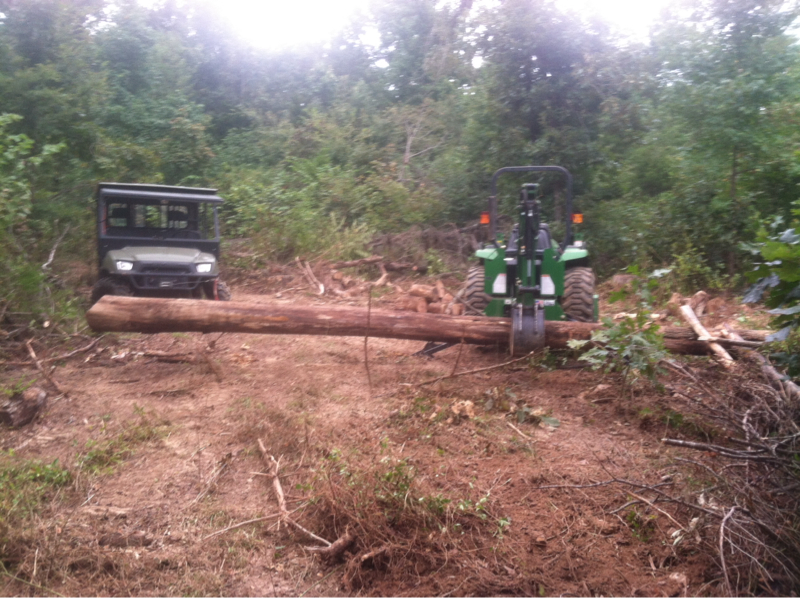

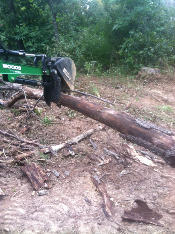

I use the thumb on my backhoe for this. LUTT
