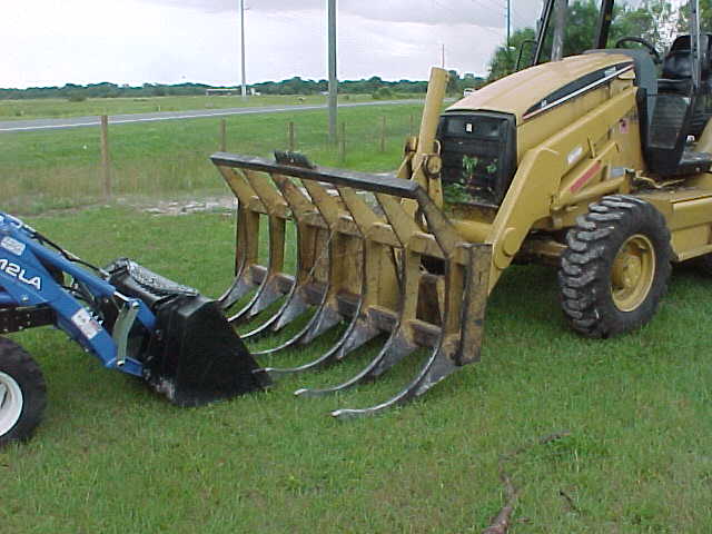

</font><font color="blue" class="small">( Try this for the pic.)</font>
That's it! I'm adding to that design. My bucket is only 48" wide, and the box blade tube/scarifiers I'm going to use are 72", so mine will stick past the bucket on each end. Next, I'm going to weld a skeleton frame to the main tube. Imagine a rectangle at the bottom and top of the bucket and running out for 12" on each side. Finally, imagine another rectangle on top of that, but vertical, so with the bucket level, there is a three-sided, 2-angle cradle for the brush, both below and above the bucket. The top-most frame will not only help cradle the brush, but will serve as a guard to prevent the stuff from getting back to me! My sketches are on paper and my scanner isn't hooked up, so I'll have to wait for actual progess to make the idea more clear.
The angle on my scarifier shanks is more acute than the ones pictured, so I will have more of a drop below the bucket. They will be mounted so when the bottom of the bucket is level, the leading edge of the teeth will be level. By having the teeth extend past the width of the bucket, I'll be able to see one on each end and better judge how deep I'm getting.
I'm also planning to add one more slot in the middle of the scarifier bar so I can take one of the teeth from the ends and put it in the middle, letting me have 3 teeth only 6" apart instead of 12" apart, for when I want to get smaller saplings that might fall between the wider spacing. In those cases, I'll only use 3 teeth and won't tear up as much ground. I think it will be good to be able to remove teeth and change the depth of the teeth, like on a box blade.
The key to the thing is not only being able to dig a little under the roots, but to hook and cradle the brush without it sliding off the bucket. At first, I'll be using it more just to move brush piles and shake the dirt off the roots. Some of the other designs I've seen on TBN, with longer, straight forks in the front, would be able to do that as well, if not better, than my design, but they don't look like they can dig as well.

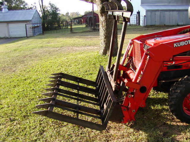

Slightly different angle for the dangle.
I already had built a set of forks with a grapple of sorts to load logs & large brush with. When I got down to the little brush, I found I was spending too much time off the tractor seat, which causes me concern.
Solution:
Built a small frame that the forks slip inside of & held on with 2 linch pins.
Sure made the small brush pickup much better.

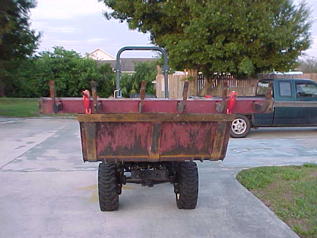

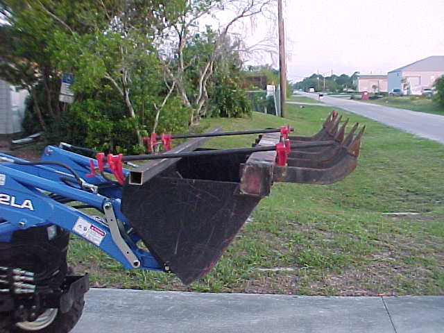

A little progress. I got the scarifier bar cut out of the box blade. That was tougher than it sounds, for me - all my equipment is for sheet metal and aluminum up to .125". I'm not used to cutting 1/2" steel plate.

   / Bucket mounted root rake
In these pix, the scarifier bar is just balanced/clamped on the bucket, along with an uncut piece of the 2" square, .125 wall tubing I'm going to use to create the rest of the cradle. The 2" tube will connect to the 4" x 3" scarifier bar with some uprights. That whole assembly will have arms extending into the bucket and will be bolted to the side of the bucket like a tooth bar. Two bolts at the bottom and one on the top at each end.
