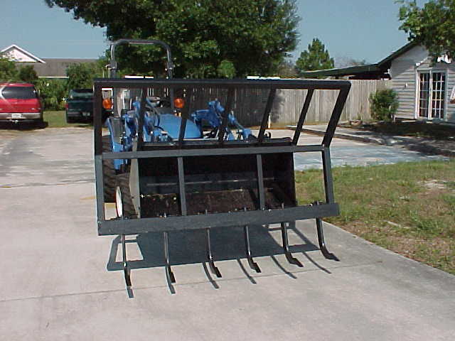

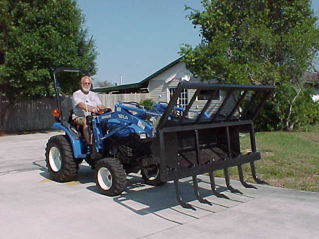

Re: Bucket mounted root rake - finished
I wish I could, too /forums/images/graemlins/grin.gif /forums/images/graemlins/grin.gif There will be no close-up shots of my welds. But, it didn't break when we tried it...
</font><font color="blue" class="small">( TIG is the BMW of welding processes, but it's slow (compared to even stick) and the equipment is really expensive (of course, just about all TIG machines will also do stick). Stick is good for thicker stuff, like tractor attachments. It's also the most forgiving of dirty, rusty, or painted metal.)</font>

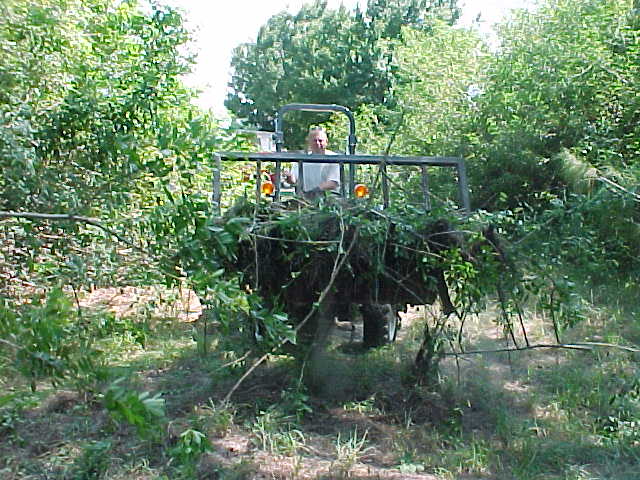

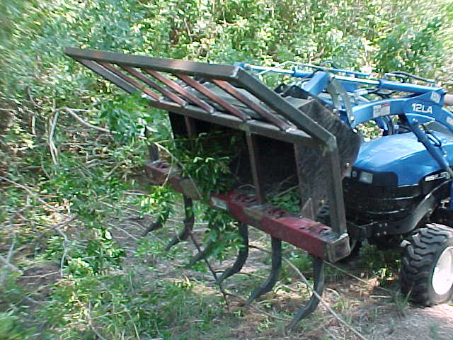

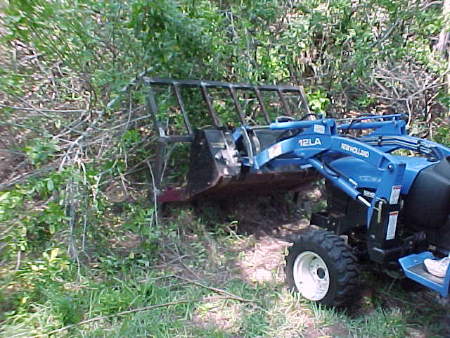

Dave, the machine I used to do this job is TIG, but I used the stick capability, partly for the reasons you cited, and partly because I really need the practice. I can gas weld pretty good, and as a result I can handle a TIG torch without much trouble, but I never did get the hang of stick. I have trouble keeping that arc, way out there at the end of the stick, nice and steady and the same distance from the work. As a result, every now and again I get too close or too slow and blow a hole in the stuff, and then it's no fun at all. I was getting better by the end of this job - the knots of molten metal dropped from the size of grapes to less than the size of garden peas, so I didn't have as much to grind off. By the way, when you blow a hole in it, you know you're getting penetration.
Seriously, we dug it into the ground pretty good, and it held. Like you said, I ain't Steinway...
