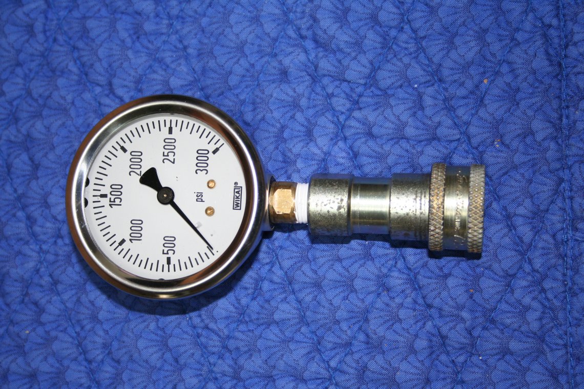

Install a 3000 psi hyd gage with a 1/4 in female QD in a tee in the IN port of the FEL valve. It will tell you the pressure in the hyd system for the implement circuit at any time the engine is running.
