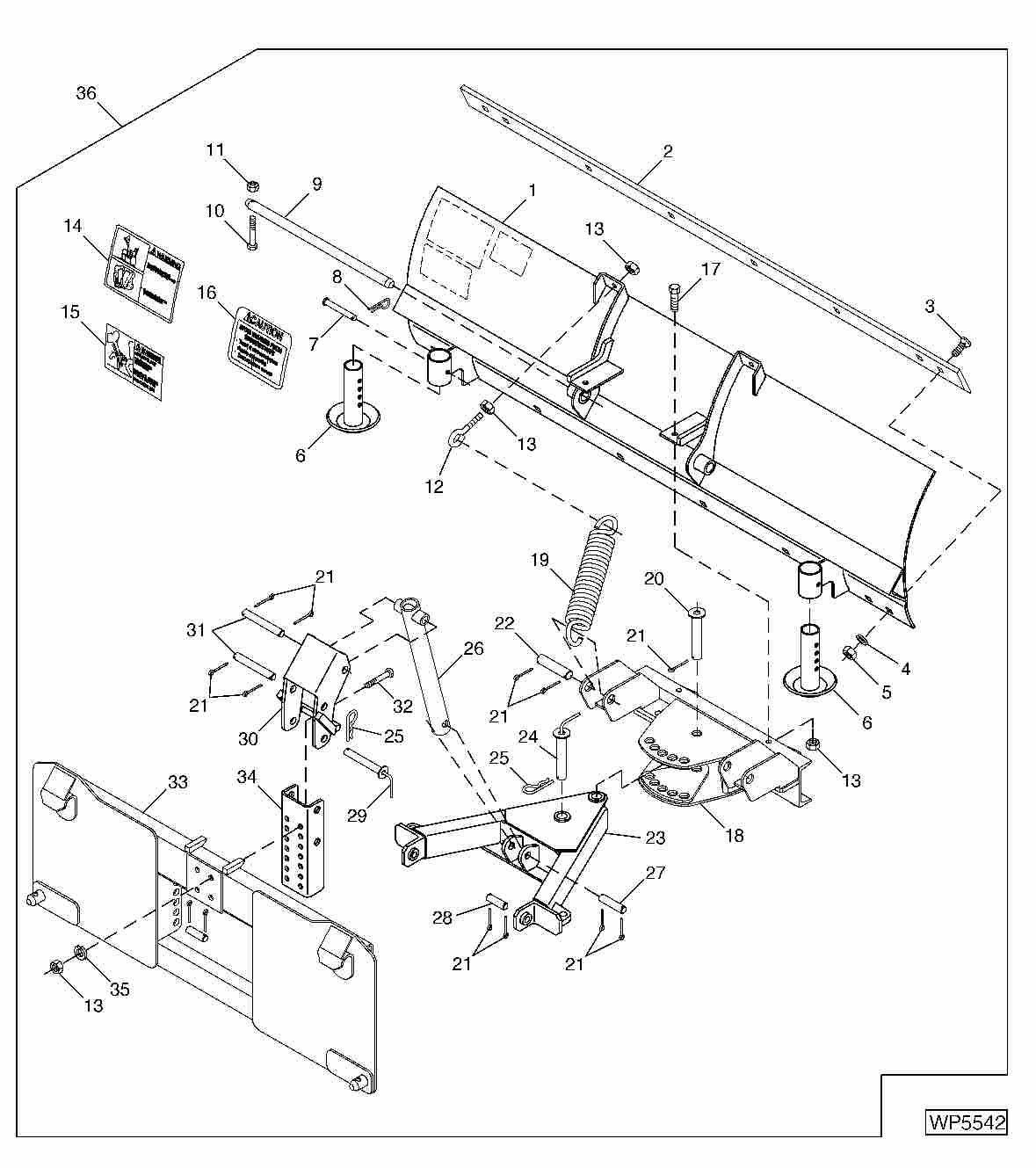

</font><font color="blue" class="small">( I am pretty sure that you can get the hardware from JDParts so that you don't have to fabricate all the connecting stuff.... )</font>
Part number is WP615300 (33 on the attached drawing). I'm seeing a price of $795.00 on J D Parts. /forums/images/graemlins/blush.gif

That drawing should be very helpful. Anyone doing this should look closely at the design that Deere uses, it would be easy to go to a lot of trouble and not consider a crucial factor that the engineers have compensated for....
I was actually thinking about the pins and the top brackets, as Atch4115 mentioned. But, with the cost of materials, it doesn't take much before $800 is reasonable....

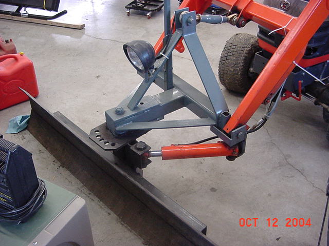

Here's what I did to my tractor (pardon the orange paint you will see). I found a 'bent' 3PH blade that I shortened the body on (that was the bent area). I then removed my bucket, and mounted the blade to my lower arms. The width was very close to the width of my bucket. I then removed the tilt cylinder, and put in a adjustable link. I then took the cylinder and welded brackets on the frame so that I could use this for hydraulic angle control. Here's a picture, so I hope that it clears up what I am trying to say here.
