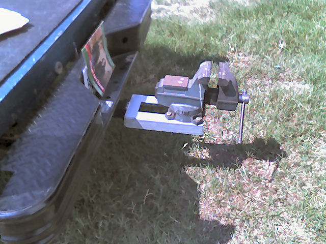

lostcause,
The 2x2 Rcvr has to be the best idea I have seen in a long time, I like it.
As you have already setup a hook there is no limit to the tools that can be used with this setup. I was thinking a Vice in the field, mounted to a 2x2 Pipe will work wonders when needed.
Great idea is all I can say, thanks.
You mean like this.
