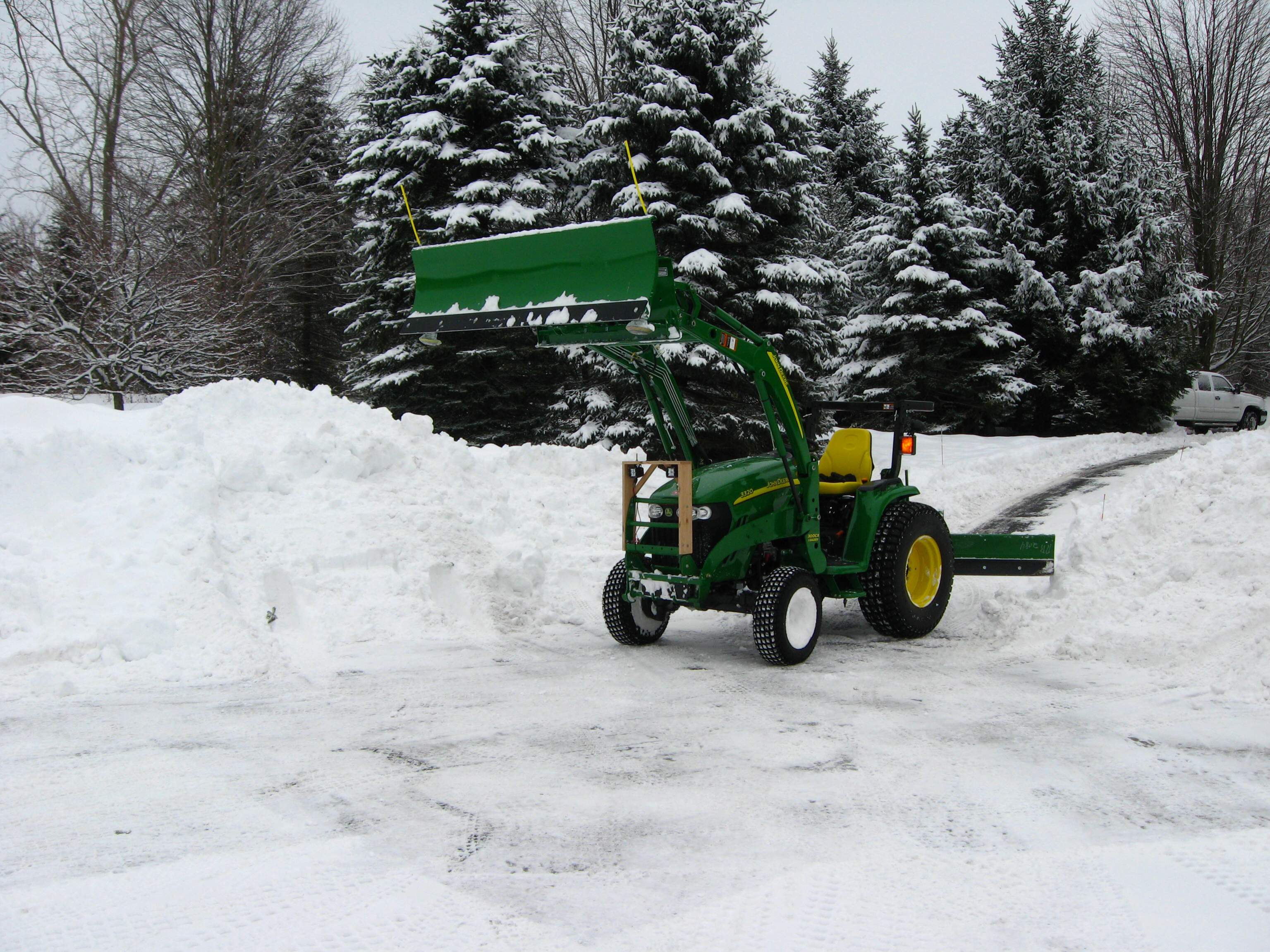

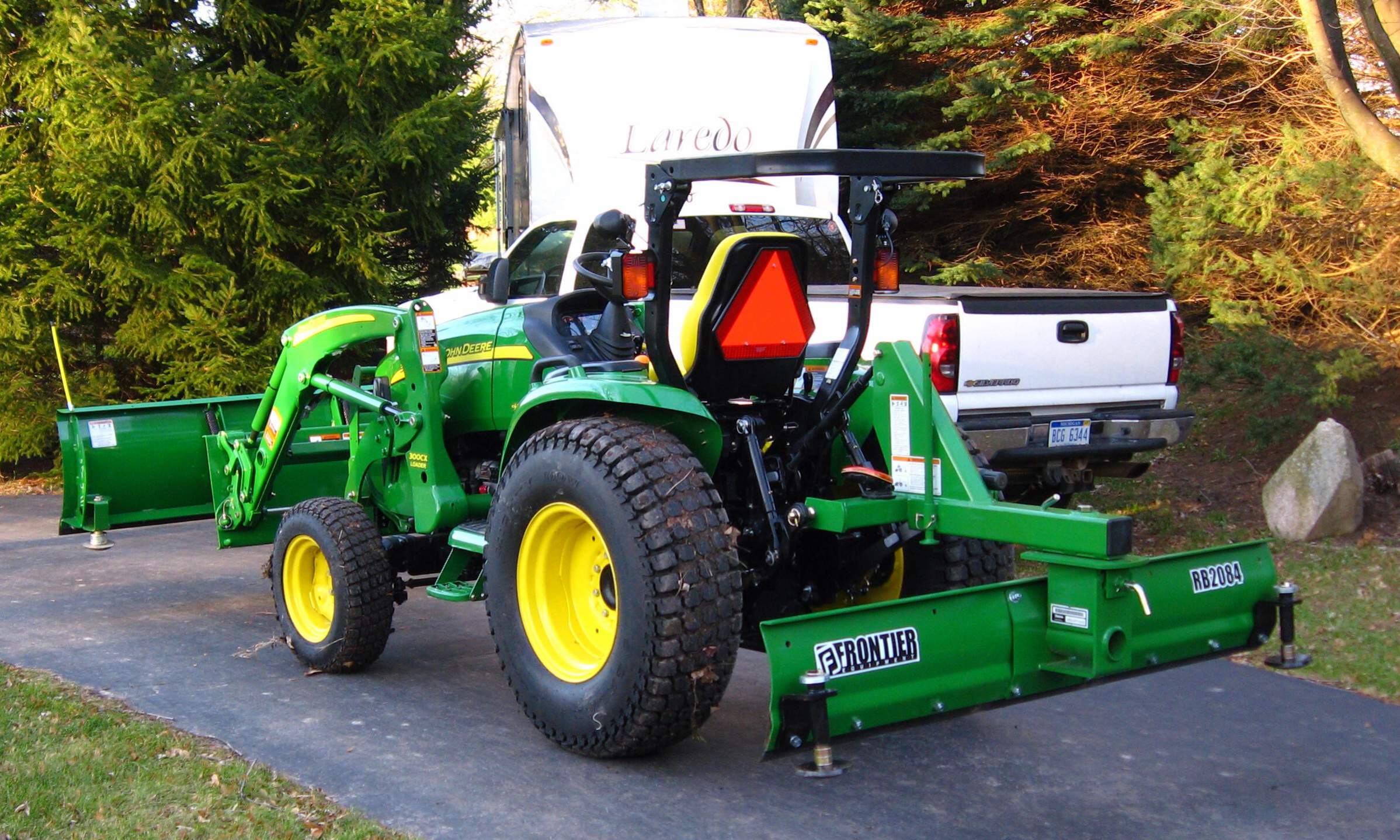

Until the snow piles, rows, & ridges set up hard, the front blade and rear blade in tandem make quick work of a lot of snow. I have the JD3320 which weighs a lot less than your 4710 and even through our record setting snow last year, my tractor with turf tires wasn't pushed around a lot. I mostly used the rear blade with skid shoes, about 5 miles per hour, and snow rolled off better than expected. Front blade was used to push side banks back after the rear wouldn't push the snow up and over. An unexpected use for the loader-mounted front blade was the reach and height for pushing piles further back at the end of our cul-de-sac.
Once the snow got hard, I replaced the front blade with the bucket and muscled the snow out of the way.
Have fun this winter.

Good idea on the rear blade. They usually are quite cheap. Worse case scenario, you find yourself not using it and you sell it for what you paid for it.
It's useful to have a tool on the front and one on the back at the same time.
