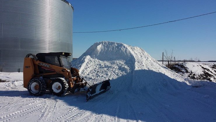

Yes the blade is the way to go for a long driveway unless the snow is really deep, then you might have to break through with the bucket and then use the blade to open up a wider path. We have several 3pt blades, a 100hp mfd loader tractor and a 3pt snow blower but 90% of our snow removal gets done with an old Western snow plow on our skid steer. Cleaning a long driveway with a bucket takes forever because your usually trying to push the snow to one end or the other, with the blade 2-3 passes will have a wide enough path cleared but like the others said start the season pushing the snow further out than you think you need too so you have plenty of room for later snows.
