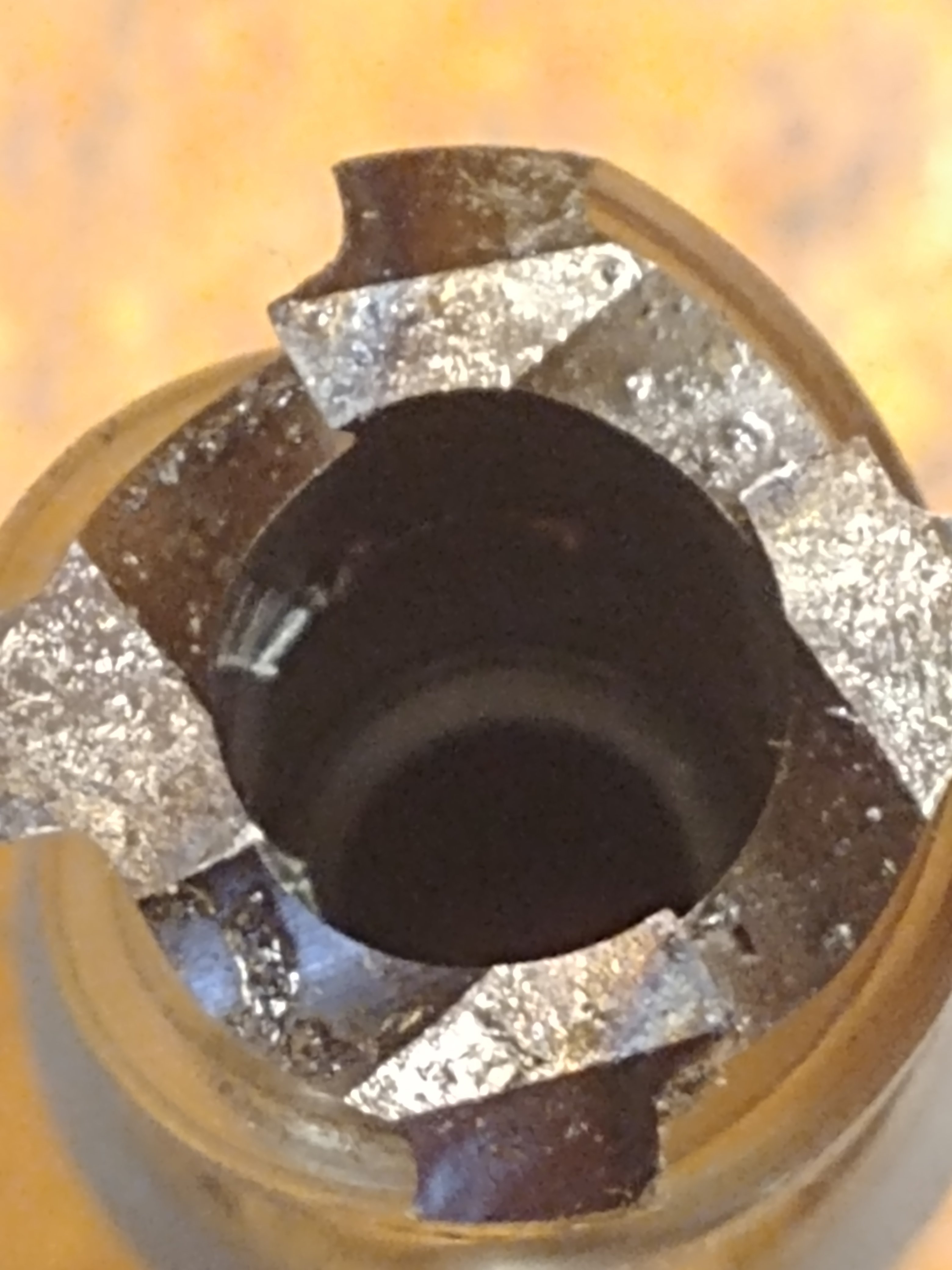

I managed to produce a little heat on this one. 5 holes, annular cutter, no coolant oil only, heavy enough drill press. $12 for the cutter I could think of as the cost of doing business. $58 material, $12 cutter, way ahead vs dealer cost of $280.

Haugen carbide tipped annular cutters are expensive to say the least and I use them as well as their HSS cutters. I'm kind of limited to what annular cutters I use because my mag drill has the quick release nose on it instead of the more common 2 set screw variety so I'm kind of married to Haugen annular cutters.
