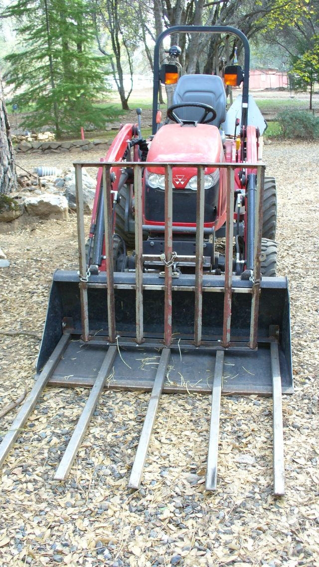

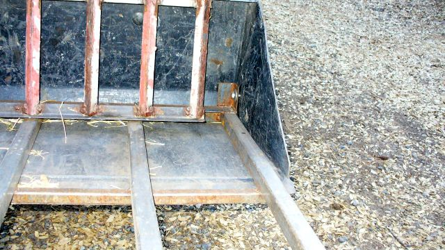

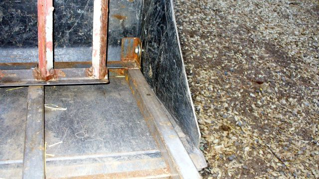

   / Bucket weight #5

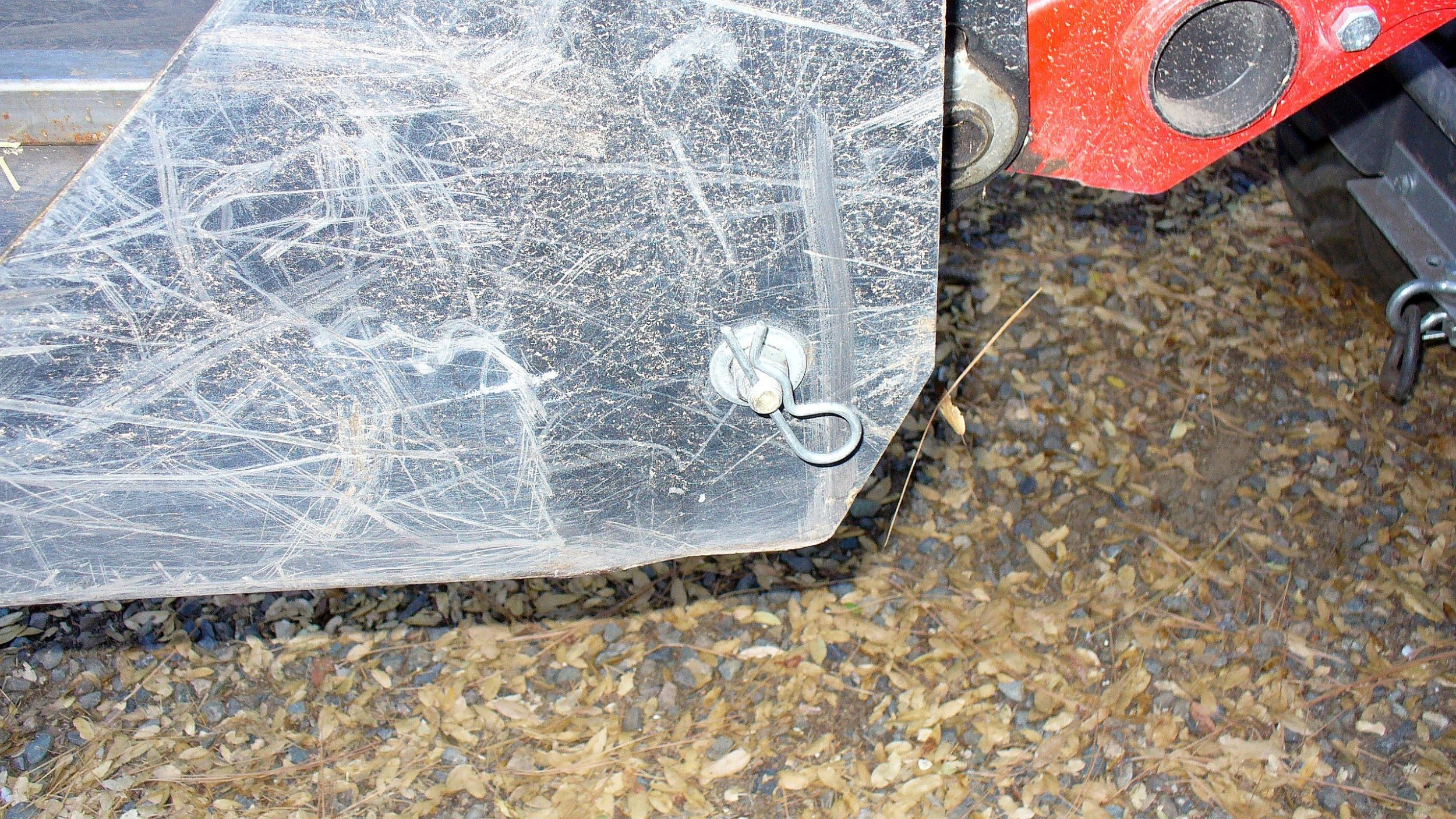

I just use a set of add on forks I fabricated to move brush piles and if I drop a pieces a piece of scrap ply wood on them I can load enough fire wood FEL can't actually lift it with out my ballast weight on.......
dsc02207-jpg.707275
Then there is this sort of option made from some sort of discarded machinery "guard"....
dsfel-basket-jpg.714717
   / Bucket weight #6
If hauling firewood is your only reason for a larger bucket, consider getting a piece of plate steel bent to conform to the inside of your bucket that extends like WranglerX's fork additions. Make it fit the bucket, and drill a single hole in each side of it to pin to your bucket, or if you don't want to drill your bucket, consider a chain or other method to keep it attached when loaded. Sides and a flat bottom will allow more wood to be stacked in the extended bucket, probably more than a wider bucket will gain.

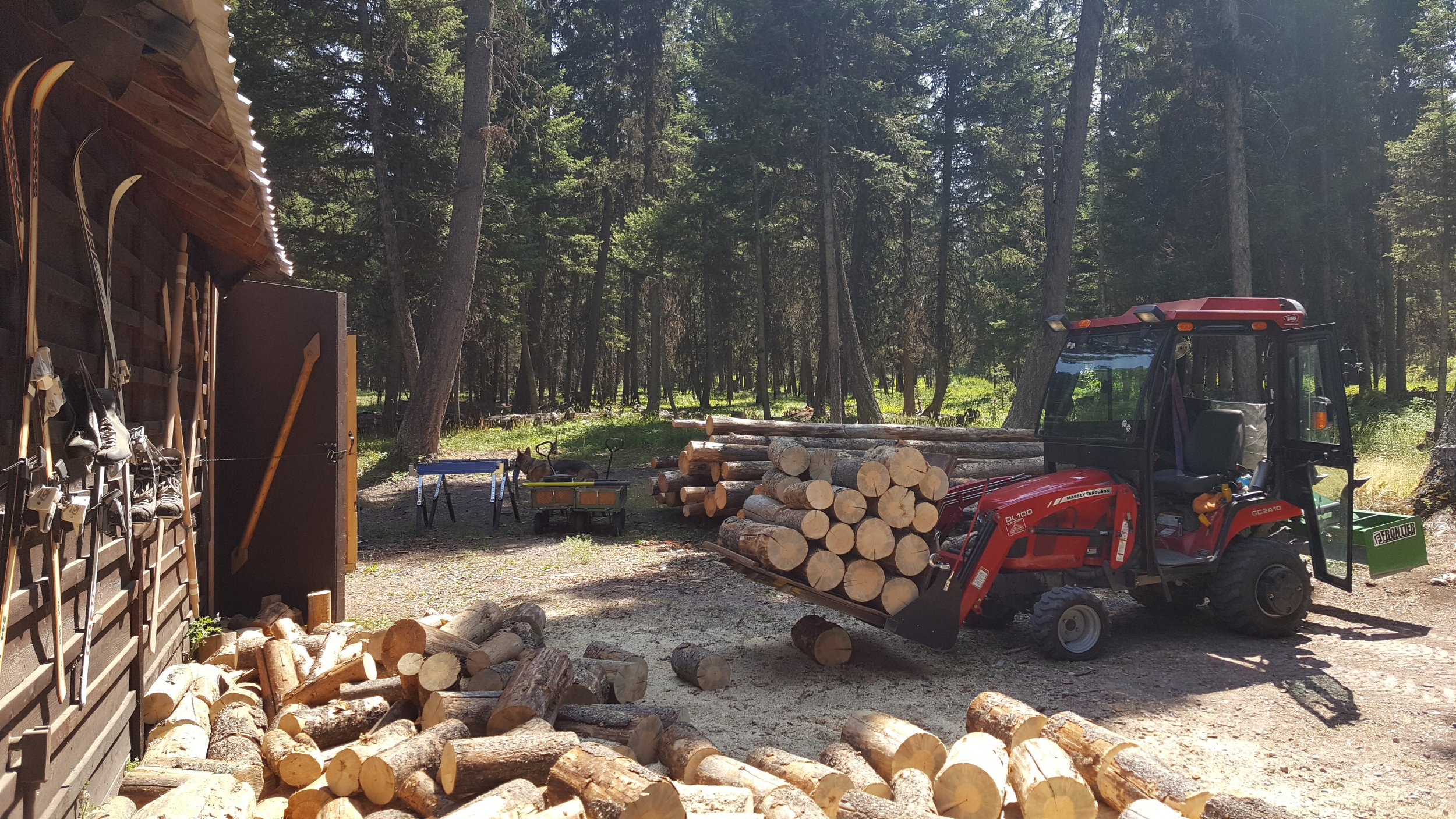

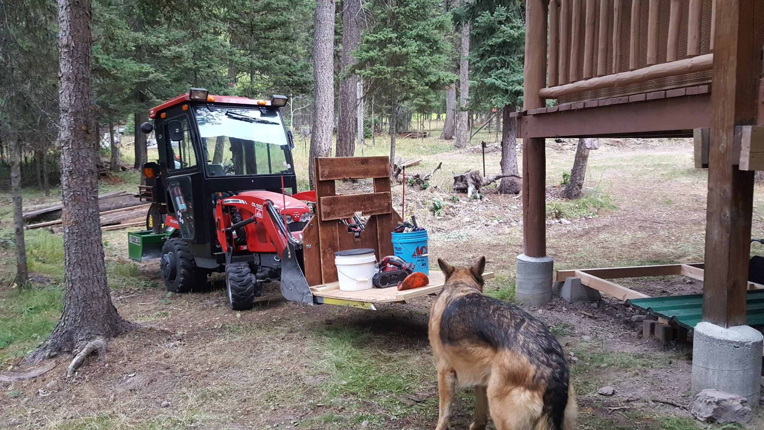

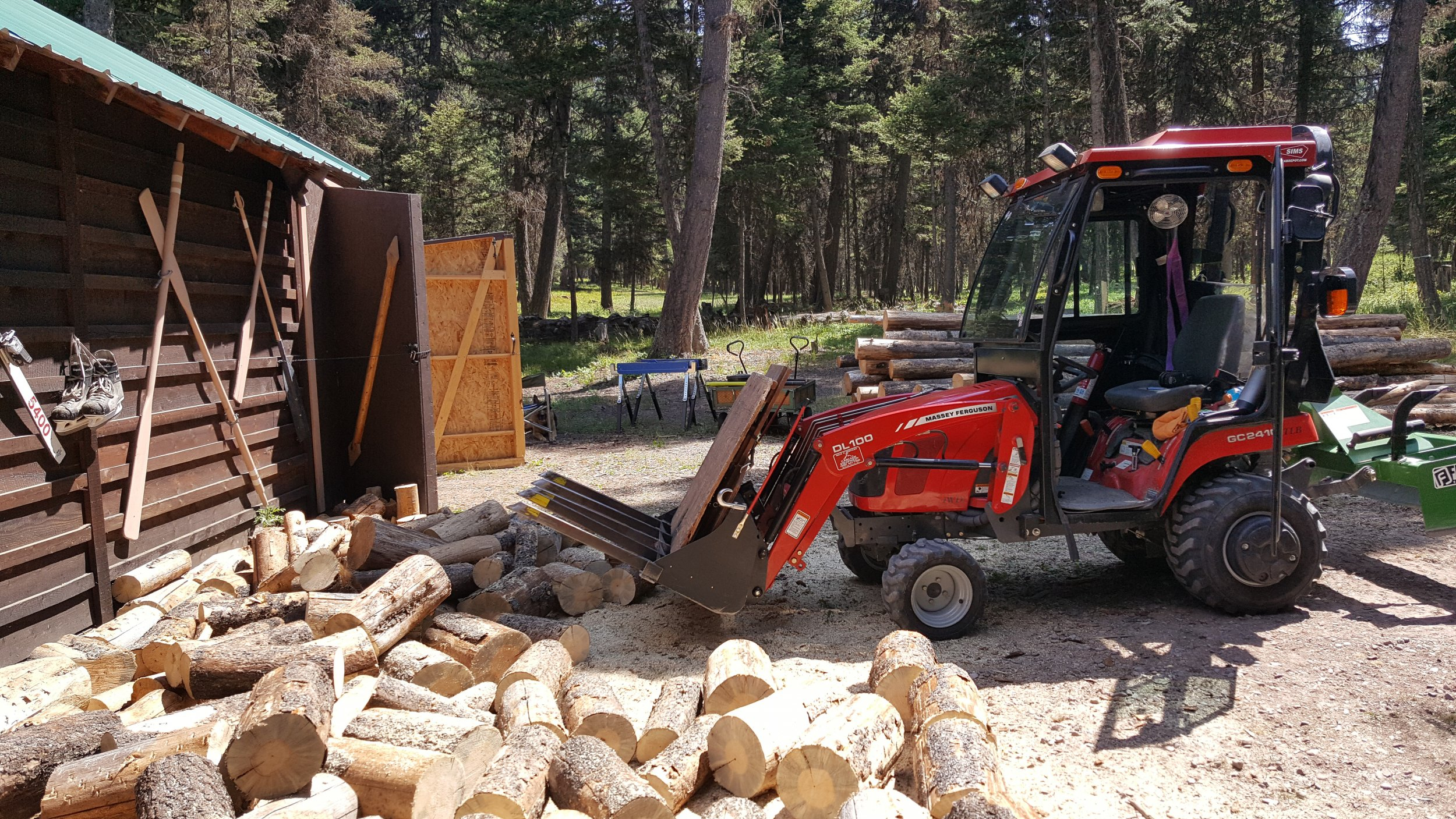

   / Bucket weight #10
This is the set of brush forks I built about 12 years ago and then added 3/4" plywood on top with a hinge so it folds up vertical against the fixed headache part.
This setup has served me well moving firewood into the woodshed.
