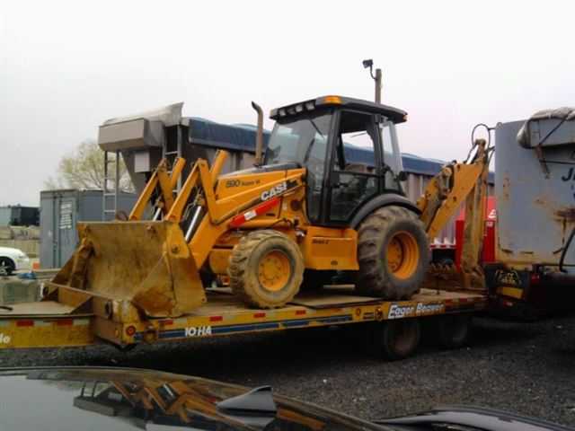

Not to pick nits but that ain't a 580 either. ;)

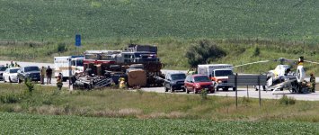

Sounds like a bad situation all around. Hope everything works out. Seeing as how that is a pintle hitch trailer, I'd have said NO plain and simple to towing that, even if my job depended on it. Did that once with a 14K pintle hitch loaded with a Ditch Witch and it was down right scary. Pintle hitch trailers over 10K are medium duty truck territory, period.
I've long said that loads like that should ONLY be towed by a medium duty truck, but most folks don't listen. They think if the manufacturer says a light duty truck can pull 20K then that's what they'll pull with it. The reason the tow ratings are climbing so high is for no other reason than to sell more trucks. It seems like the only thing they base this on nowadays is power. They want to be better than the other brand, only care about liability enough to make sure it's on the edge of being safe.
Almost as bad are the 1/2 ton trucks rated to tow over 11,000lbs these days. The may have plenty of power and huge brakes, but last time I checked still have very soft springs, relatively light frames, and don't weigh that much. As I said in another thread, my '88 F-250 is only 'rated' to tow something like 7-8K, and it is WAY more truck than those new F-150's.
I'm guilty of sometimes towing more than I should. My father has a 3500 cab-chassis Dodge that we sometimes pull 18k with. It is rated to tow that much, but may not necessarily be safe. I think single tire gooseneck trailers (14k) are about all that a 1-ton pickup should be pulling. To some extent this coincides with the CDL laws as a 14K trailer + 10-11K truck puts you right below CDL requirements. Move up to a tandem dual 20K trailer and IMO you need minimum of a class 4-5 truck. Over 20K is class 6 and up territory.

Theres new construction goin on right accross the street from my house. I'm always intrigued by equipment, so I keep a good eye on it.
Just the other day, the 4x4 F350 dually 6.0 with the service/toolbox body that I have seen around pulled up with a tandem/dual pintle hitch trailer.
They loaded a Bobcat 442 excavator (16k+) on it. Figure the machine + trailer must be close to 22k, plus the truck was already a super cab with a loaded toolbox body and 3 guys in it. They loaded it on the road and pulled away, just like it was nothin new.
Truck was under some serious strain, imagine that pintle hitch bouncin around during an emergency stop.

I'm not gonna argue about the weight and I'm sorry someone was hurt/killed, but I think there had to be some driver error involved for the trailer to lose control on an open highway like that.
Fishtailing to me means he locked up the brakes, which may suggest he was traveling to fast for the conditions.
I do agree we are pushing the limits on these class 3-5 trucks, to the point where if something does start to go wrong there is nothing in reserve for recovery.

High Compression said:
This is true. If you look close in the pictures, it is a tandem dual 20k gooseneck trailer. It would be difficult to position a backhoe on that trailer so that it didn't have enough tongue weight. He did do a good job chaining it on the trailer though. It sure didn't go anywhere.
I am sorry to here about your friend
What picture are you looking at cause all I see is the backhoe on it's side I looks like the trailer is. Way to short for the load it was hauling and that would make it fish tale with a heavy load

Granted it sucks when someone close gets seriously hurt.
But before jumping to conclusions about capacities and capabilities of an entire group of vehicles, Im certainly going to look at a number of key data points associated with the serious accident.
1) what was the speed of the vehicle at the time it crashed (easily obtained from vehicle black box, or smart phone data or onstar data)
2) What was the status of the drivers cell phone at the time of the accident.
3) what other exterior forces may have contributed to the accident. (such as a tire blowing out on the trailer, being cut off, functionality of the brake controller and trailer brakes etc)
Any drawn conclusions about the accident are worthless without solid answers to the above simple questions.
