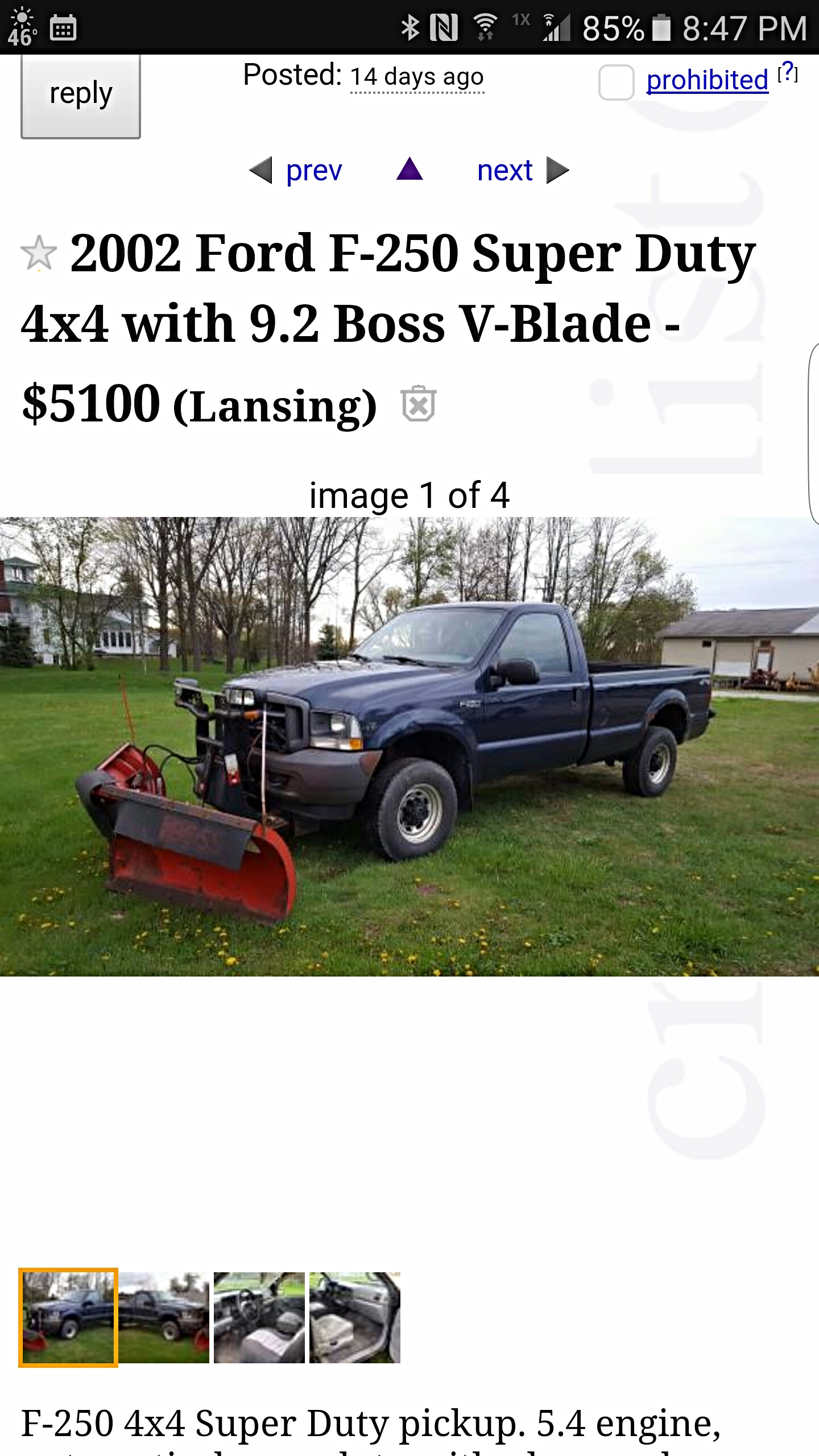

Do you need a big blower?
Something like this clears a lot of snow and has heat. My Neighbor doesnt plate his plow truck for his driveway. You'd have enough left over for a pretty nice comerical zero turn and a descent walk behind blower
