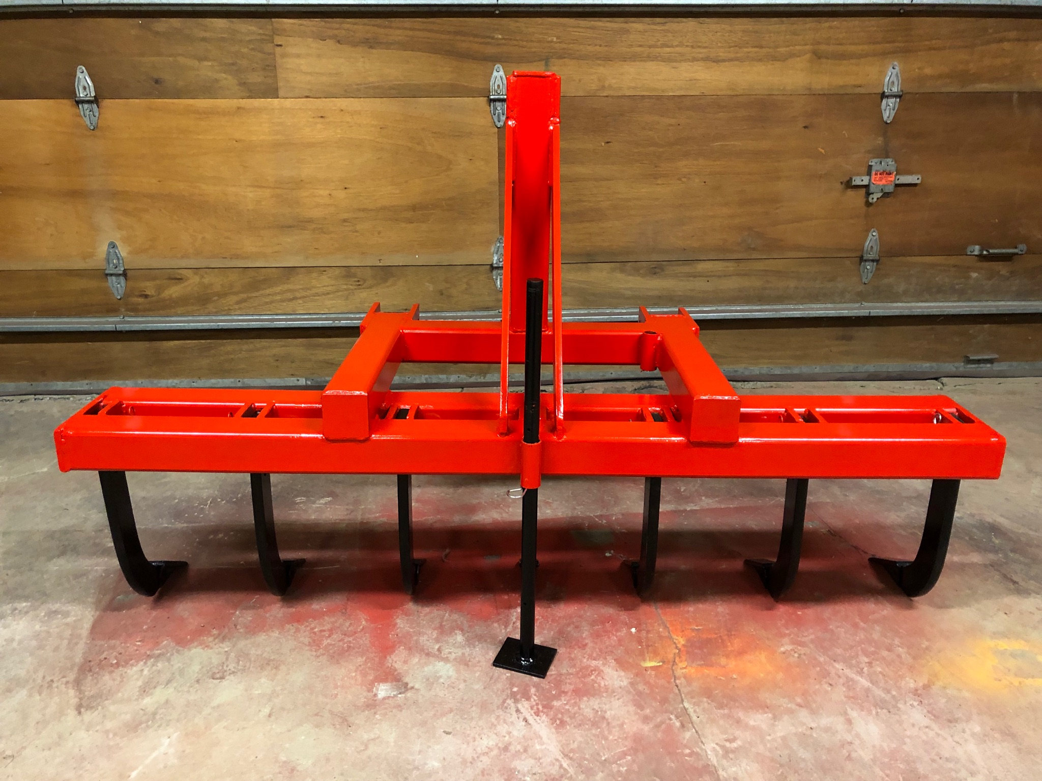

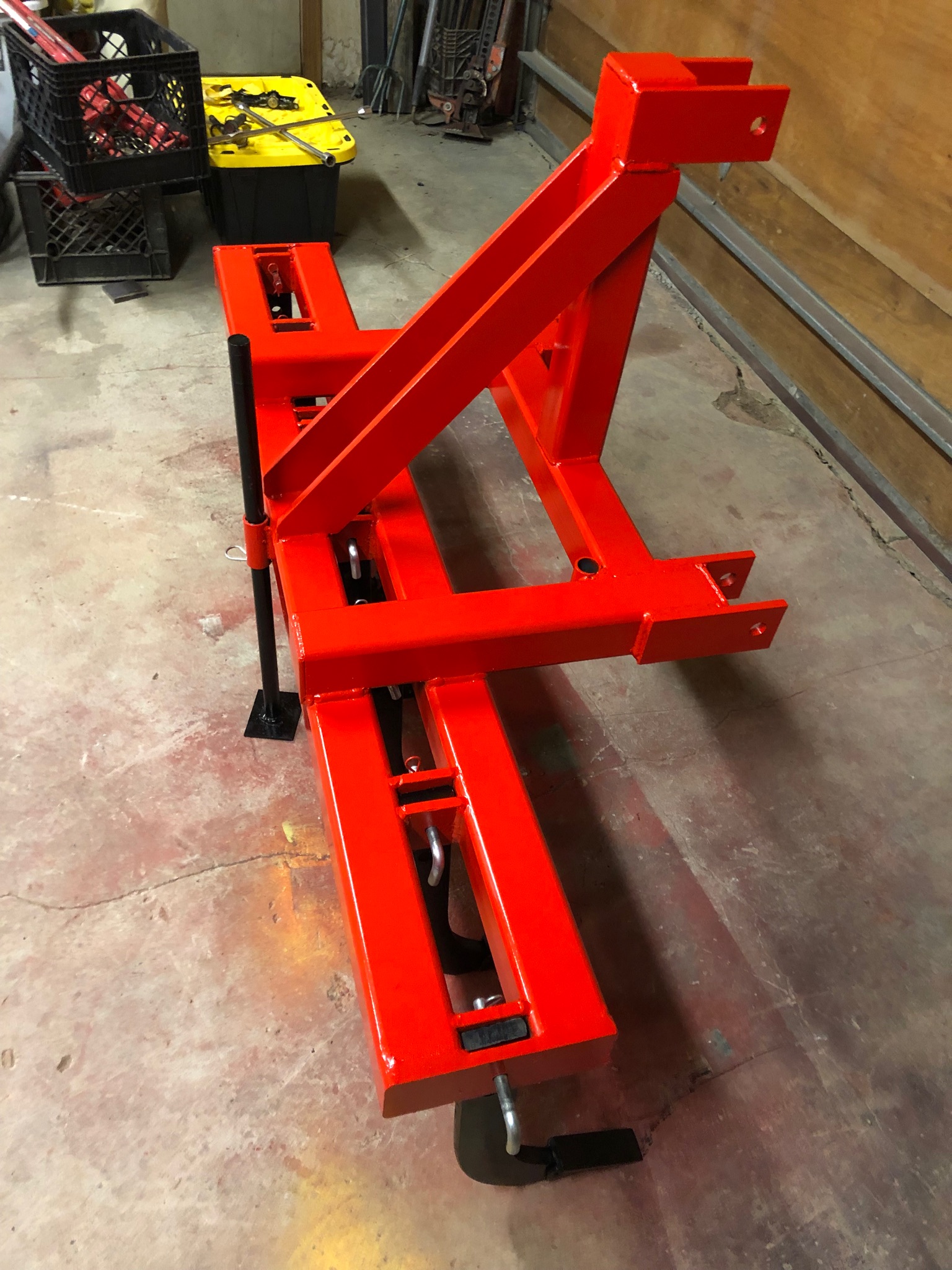

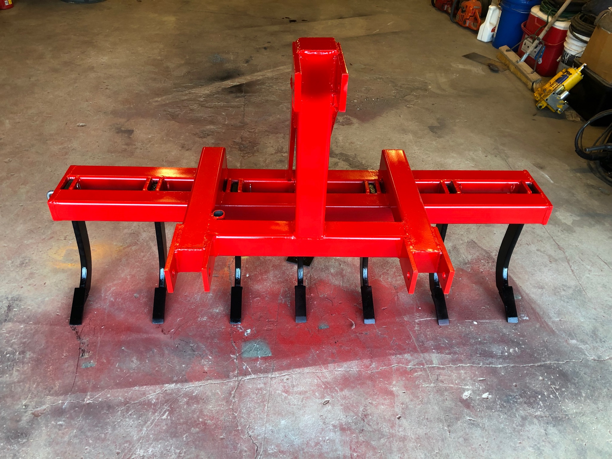

D4E1BBF1-0A75-4C21-9CFB-203EA91AE6F8.jpeg609FFD8B-0163-4DAD-B98E-CB6FFEC4E678.jpeg37550A75-DA2B-450B-9F1D-0D98967F6CE2.jpeg
This is what I use for hard pack removal.
   / Budget Ice Scarifier #16
I did use the rippers on my rear blade but decided to build a stand alone attachment. Hard pack removal is one of the services I offer with my business. The rippers do a great job breaking up the hard pack.
