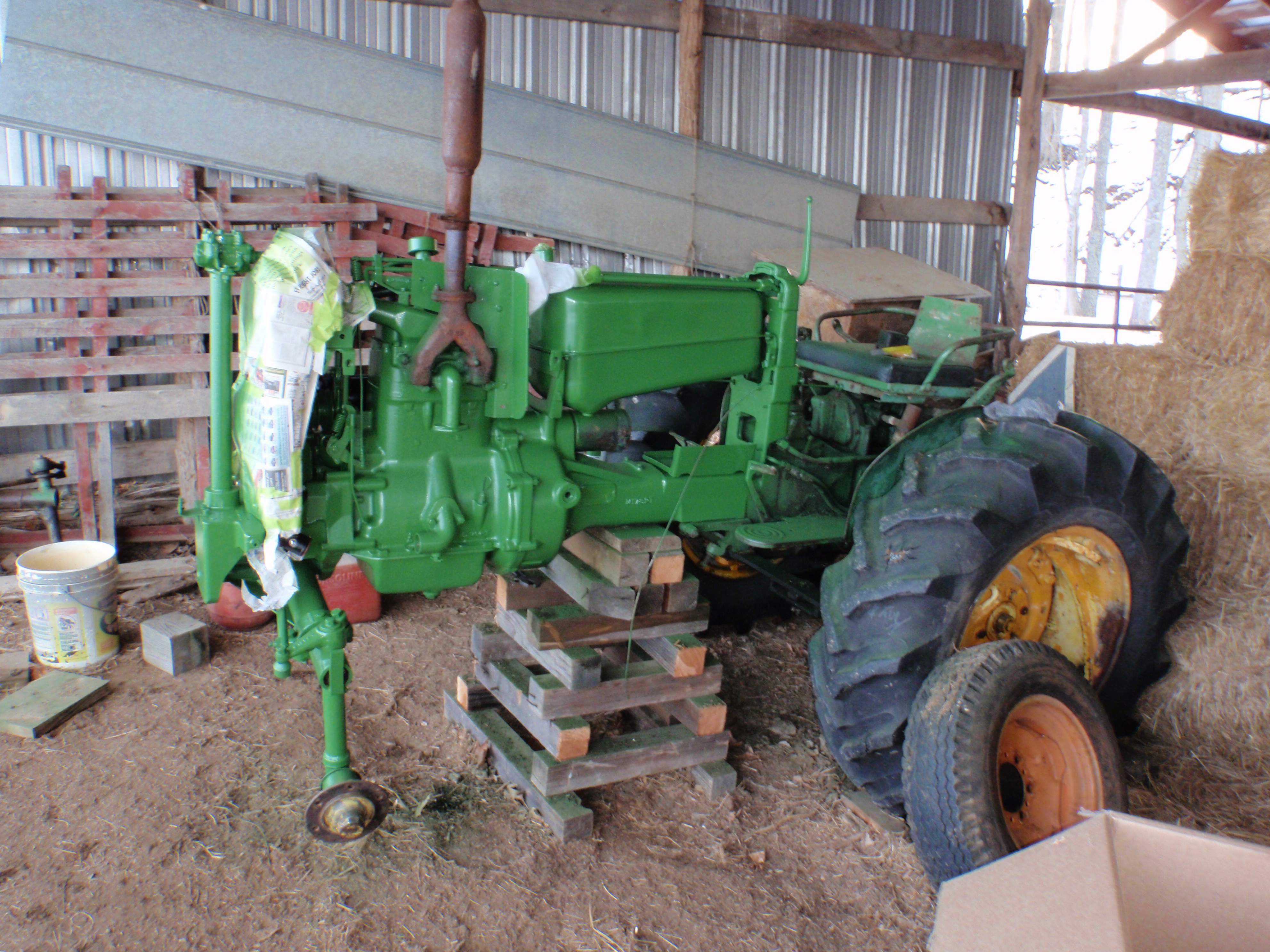

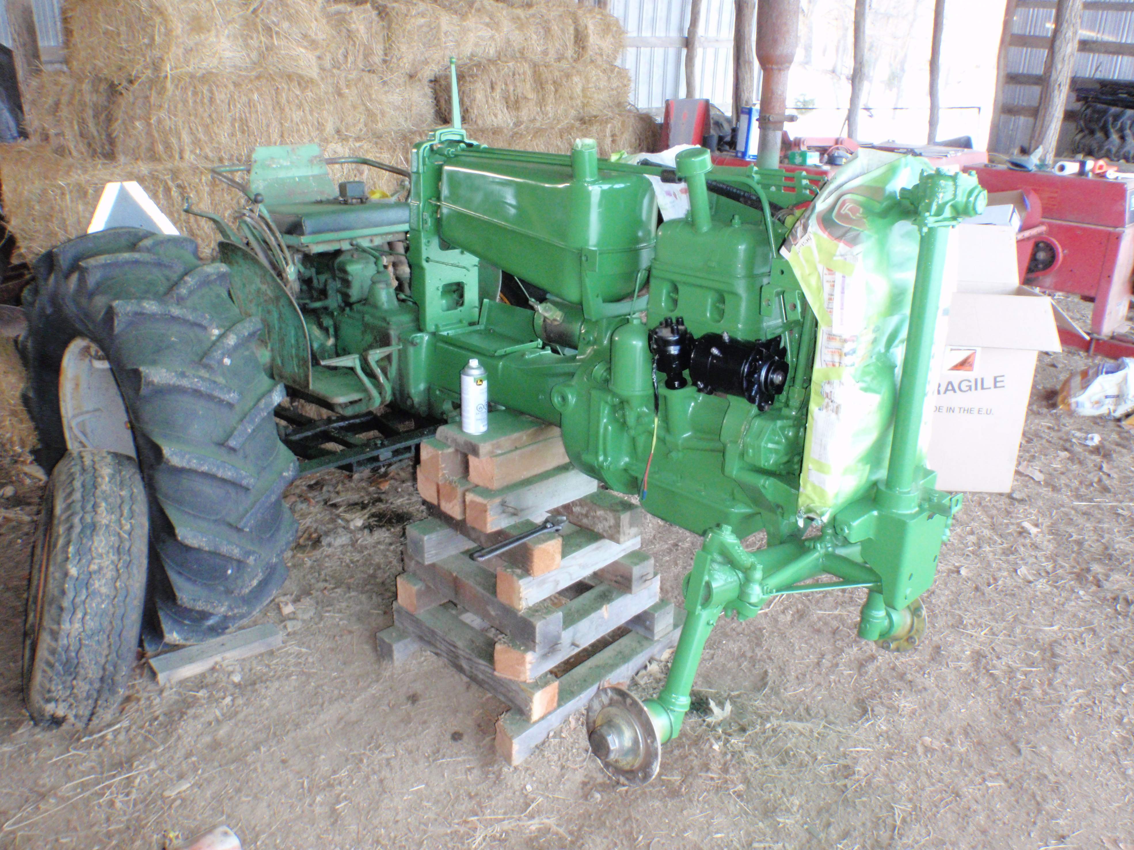

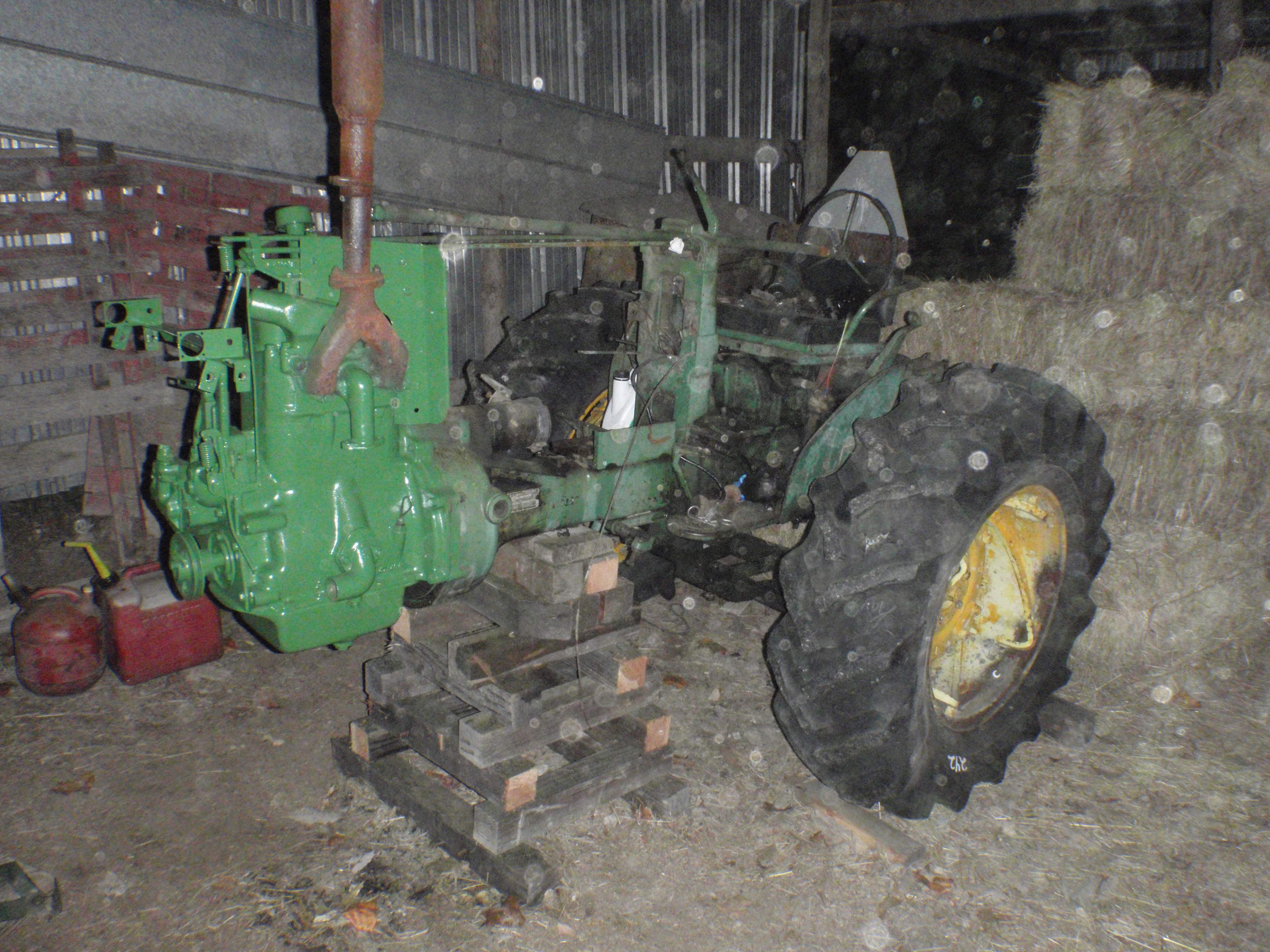

Well here we go, In the last two days Ive been plugging right along on the tractor I think Ive got a lot done on it but it not showing to much. Yesterday I wire wheeled, degreased and painted my: Distributor, Combination fan-light-radiator mount, and fan. And they turned out really nice, if I do say so. Also I Finally got my generator back, Broken casting fixed, New windings, Converted to 12v and painted black with a 12v regulator.
Also I have been feverishly trying to track down a good front end, And I think I have a good lead one another one in NC, He is supposed to email me pictures tomorrow morning (fingers crossed!). It is also the cheapest Ive found at $450 for everything :ashamed:
This evening I removed the gas tank, battery box, tool box and the mounts for gas tank so I can work my way back on the tractor. I am Waiting for some parts to arrive also: The correct exhaust, Correct Steering Wheel, And the correct raditor mounts and pads.
Total From last Time: $2,547
+ Generator & Regulator: $240
+ Belts, Hoses: $31
+ Steering Wheel, Muffler, Radiator Mounting Hardware: $149
Running Total: $2,967
Here are the most recent pictures I have:

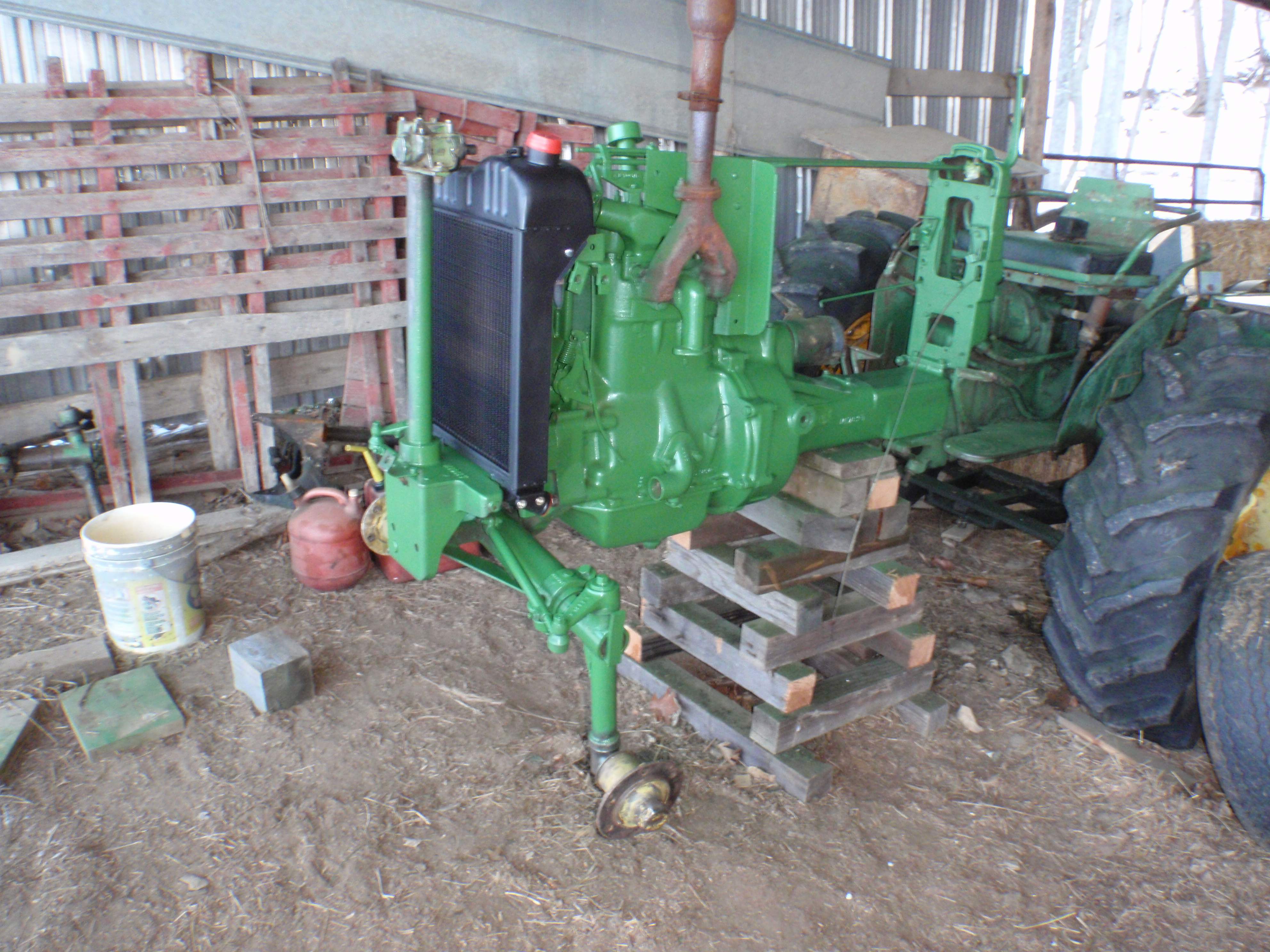

Well its been awhile since an update and i don't doubt ill leave out a few things, so here goes:
Well I found a really nice immaculate front end from a nice fellow in oxford, North Carolina along with this I got a nice set of wheels and decent front tires and also a nice dent free rust free air cleaner, all for $550.00 cash. I immediately got home and went to it with the wire wheel and got just about everything clean and ready for paint.
The next step was to mount the painted radiator mounting bracket and fan then the new radiator. Then with so with some help from a floor jack and my dad I got my new front end in place and bolted up tight. Then I put the final coats of paint on the front end and steering box.
Then after this I cleaned up my battery box, tank mounts, and the tank give me a bit of trouble, the outside was a breeze to clean up but on the inside I found 57 years of "fuel gauges" on the bottom rattling around. By this I mean sticks that they jabbed down in there to check the fuel level. It took almost four hours to get all these out with my three jawed grabber thing.
Then I got all these things painted and bolted down in place and a new fuel sediment bulb from tractor supply on it. At this point it was extremely whole again.
Total From last time: $2,967
+ $550.00 for front end, wheels and tires, air cleaner
+ $40.00 for Sediment bowl, bolts, RTV form tractor supply
+ $75.00 for muffler paint, green paint and hose from John Deere dealership.
Running Total: $3,692.00
Here are the most recent pictures that I have on my camera of it.
More posts will follow soon:
