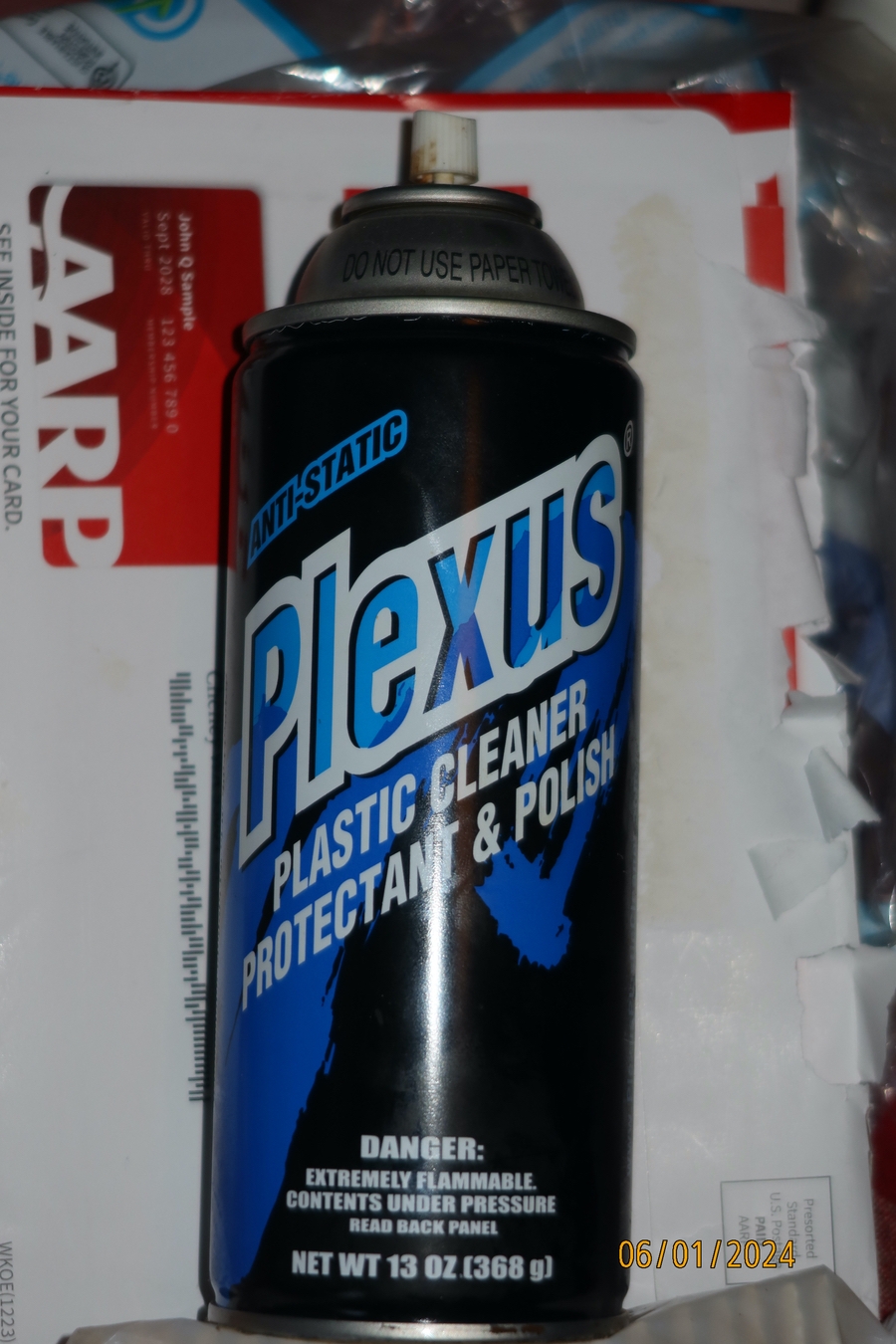

Sixty years of riding motorcycles and many of those years with some form of Plexiglas windshield. I've tried most everything. Except olive oil.
My first suggestion. Meguiars Mirror Glaze. Clear plastic polish. This product is good and only relatively expensive.
Then there is the ULTIMATE product. I've used it to visually obscure even deep scratches on Plexiglas. This product provides excellent results and is quite expensive. 13 oz spray can - around $26.
Plexus - plastic cleaner, protectant and polish. It is used by the Air Force on their aircraft plexi windshields. A good friend in the AF told me about it.
From experience - I've found that you can not buff scratches out of Plexiglas. At best - you will create an obnoxious area of "haze".
/ Buffing scratches in plexiglass? #11
