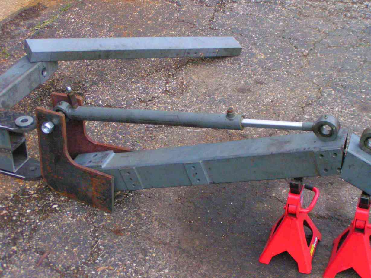

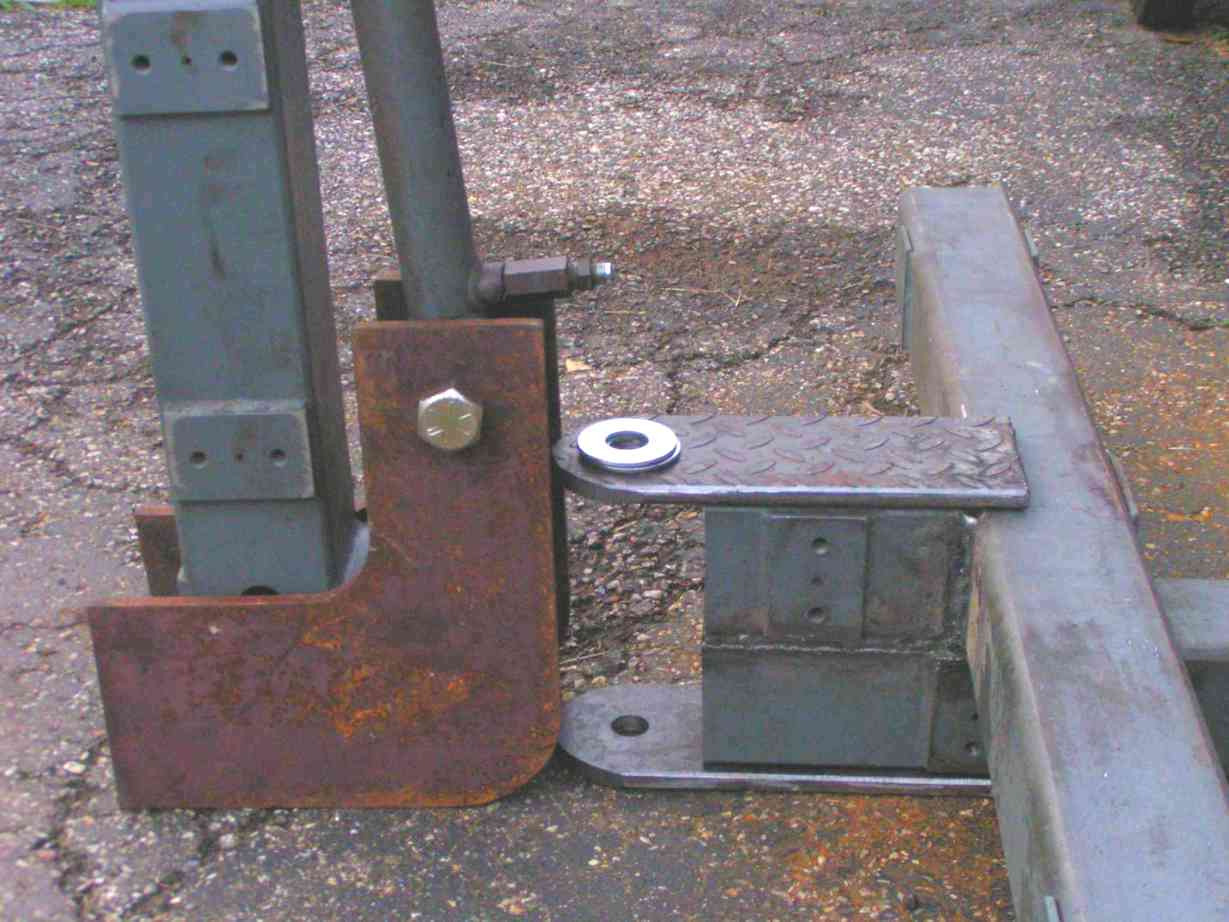

Here's how it's gonna look with the boom attached. Missing from the picture is the box I have to fabricate to hold the pivot tube. The pivot tube box will be pinned through the brackets that I showed in the last picture. The rusty L shaped brackets that hold the boom will be welded to the pivot tube box.
   / Build A Backhoe For PT425... It Could Happen
#242
Better look at that assembly. The pivot tube box will go between the brackets under the shiney washers.

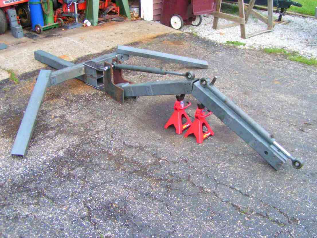

#244
It's gonna look like this extended.

#246
And somewhat like this with outriggers. Missing is the dipper stick and bucket, of course. /forums/images/graemlins/tongue.gif
