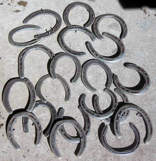

I've been using a Harbor Freight 3.5 cu mixer to tumble horse shoes. They have been thrown in the dirt for years, are really cruddy & rusty. Takes a little while and is real noisy. Only problem has been from not clipping the nails off of them. Once they get tangled up its a pain to get them untangled.
Just using river bottom sand and odd ball scraps of metal as a medium.
