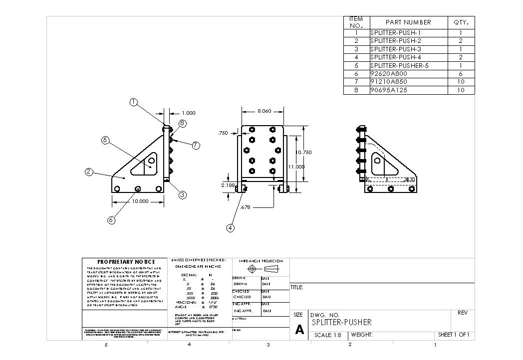

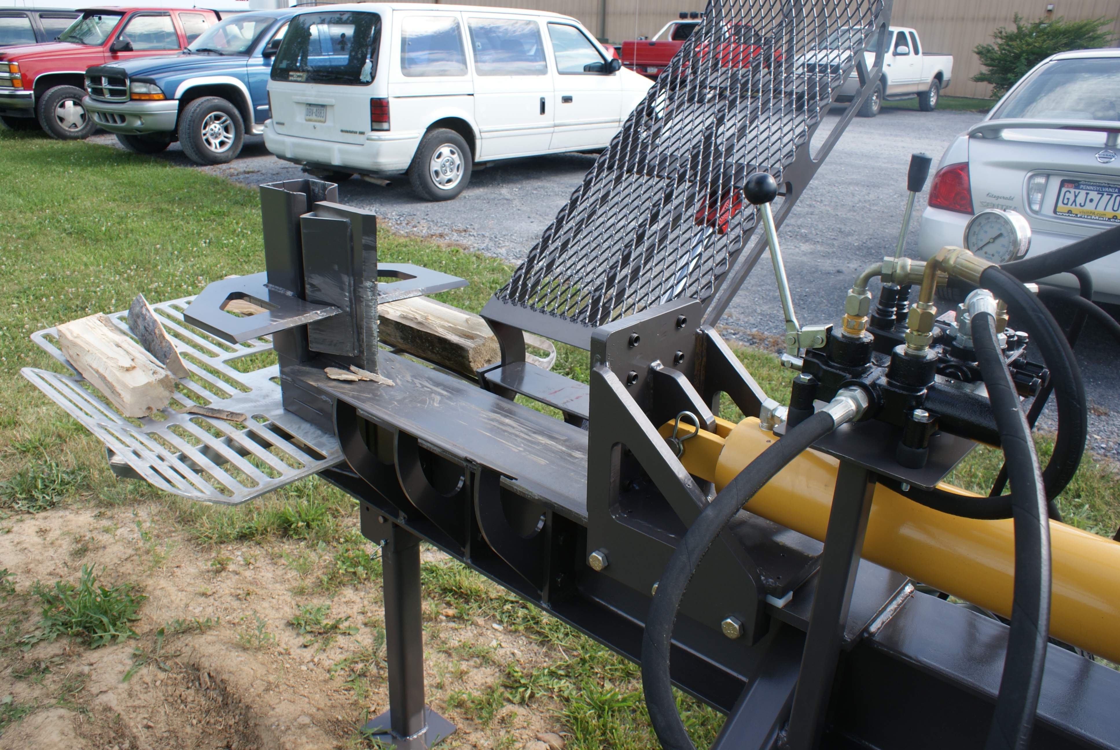

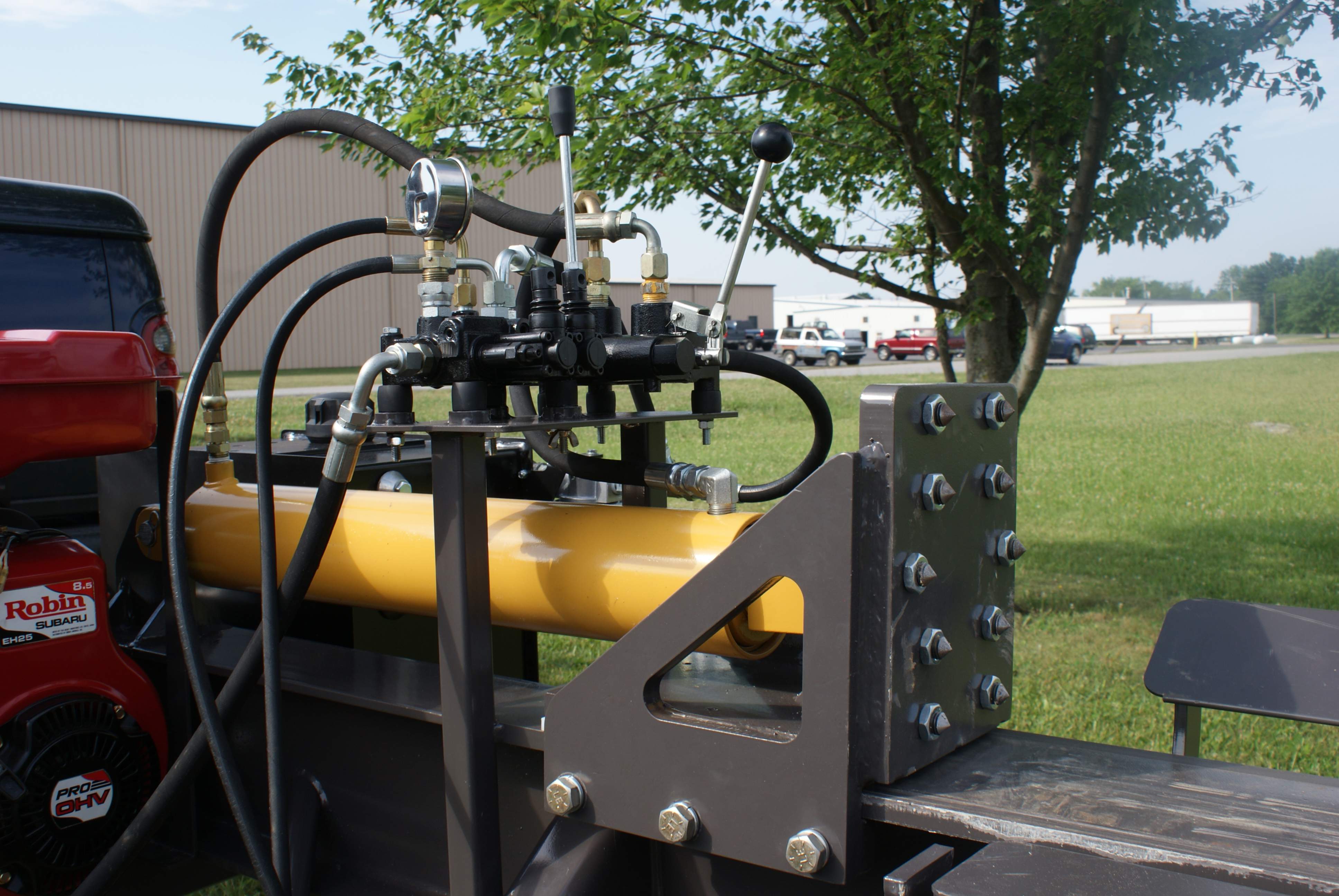

   / build a splitter #6
This is another mounting option for the slide.
The sides come down past the top of the beam and solid bars bolt on which ride underneath the beam. I used UHMW plastic in the corners of the base of the slide for smooth movement.

Not sure about the gear reduction either, but I endorse the sharpened bolts for securing the log at the pusher. It's just a safety factor for those logs that are not cut square (who does that?) jumping off into your leg. A gnarly piece under full ram pressure has lots of power in it.
I only question the ram length, but if you already have the cylinder, that speaks louder. Good luck with your project, and moving all dad's HEAVY machinery!
