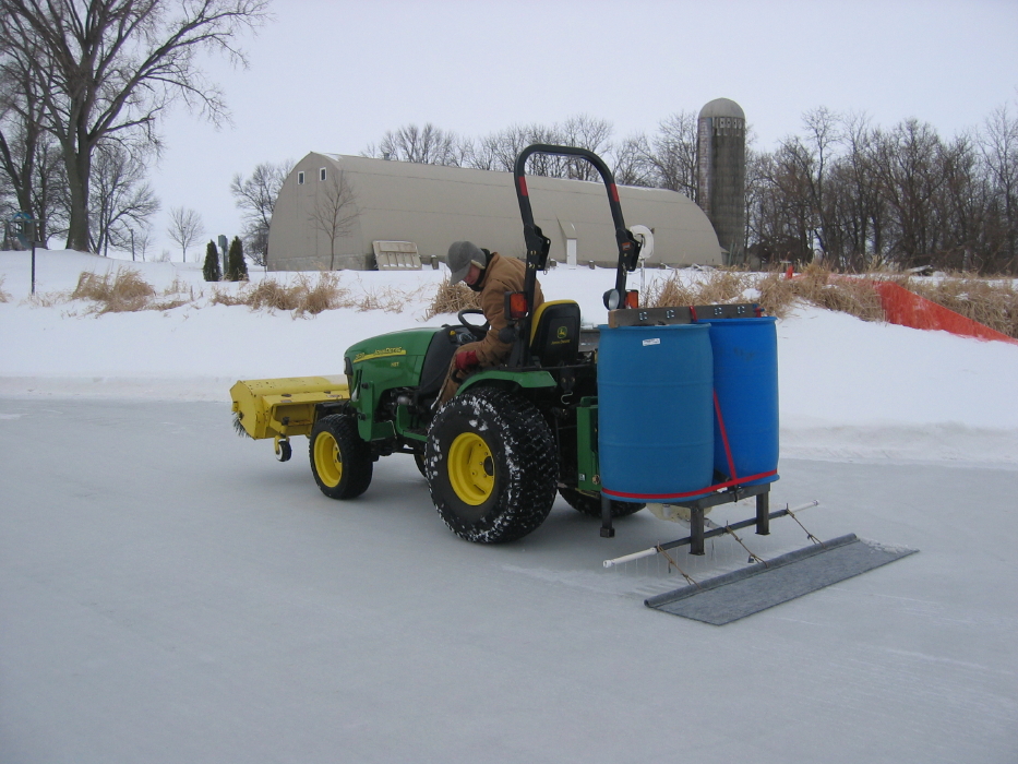

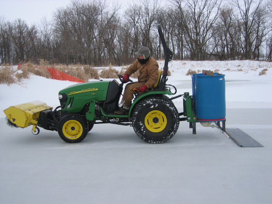

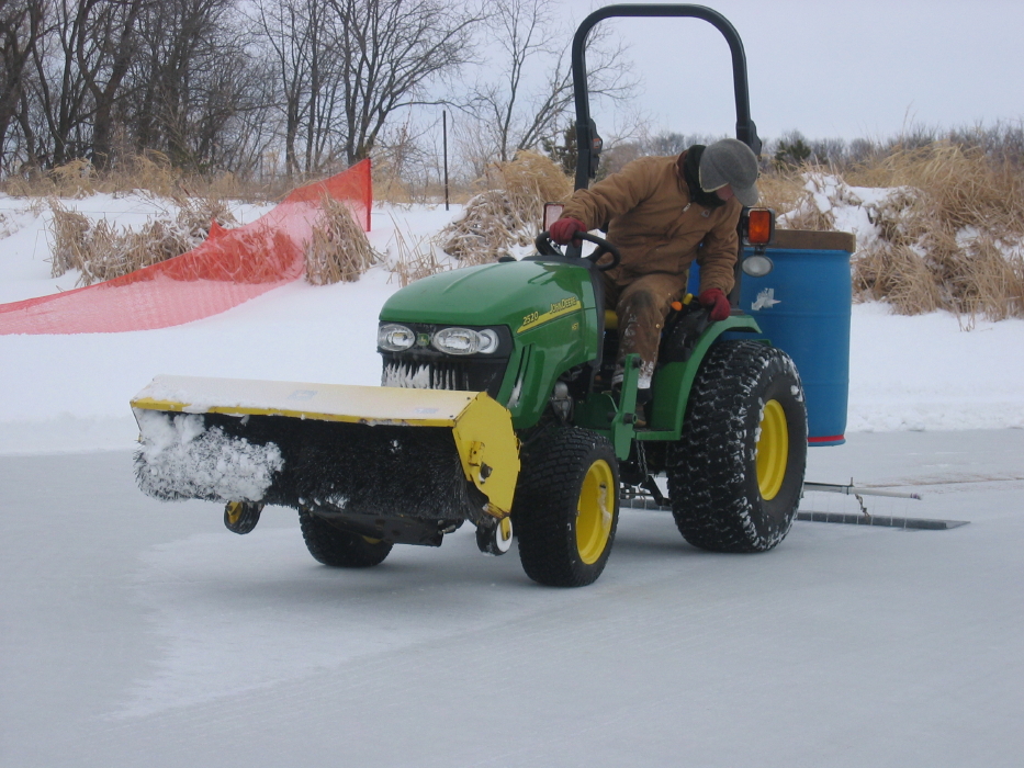

Since the winter of 06/07, I've been using the pictured PMZ (poor man's Zamboni) on my pond. I find that mother nature is not usually my friend in keeping good ice. This thing has saved the season several times when we've gotten snow and rain mixed, leaving a couple inches of honey comb crud to on top of the good ice. My process is to snow blow, sweep, then resurface. If it is sub-zero, I can continually coat the ice with many passes to build a good surface.
Here are some comments on the build. The line between the two tanks and the valve is all metal to conduct heat and help keep things from freezing during use. When done, the valve is left open and the plumbing is all inclined downward so it completely drains. The valve control is easily operated from the driver's seat. The sprayer "booms" are removed when I leave the ice and snap into a storage position on top of the tanks. Similarly, the mat hangs on hooks on the tanks between uses.
In general, this thing has been great. I use it in the summer to water remote trees. There is a by-pass of the spray boom that allows the water to flow directly out a removable spout in the back. It isn't shown on these photos.
I got the initial idea from looking at the Bambini site and their systems. They have lots of good ideas. The Bambini, ice resurfacing machine, ice resurfacing equipment, Backyard portable ice skating rinks, ice hockey rink kits
Best of luck with your project. Would love to see what you end up with!

Very nice set up Fud. Reminds me of something they used at a local rink in the 70s.
   / Build a Zamboni #19
fud, sound as if you don't have an issue with draining and freezing, but if you ever do, a little of that pink RV antifreeze (safe for humans and animals) would make a good final flush before parking it for the day.
   / Build a Zamboni
#20
Fud; very nice, a couple questions, do you find that you need 2 tanks? I have some steel pipe I was going to use, do you think it will freeze up? and how big or the holes and how far apart are they on you boom arms. Your idea looks like it works great.
