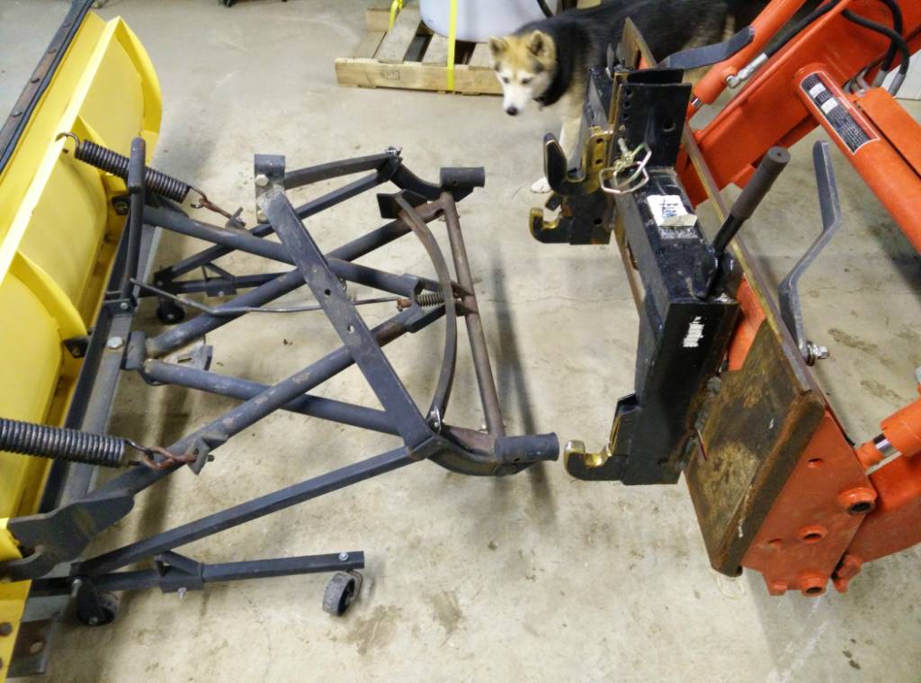

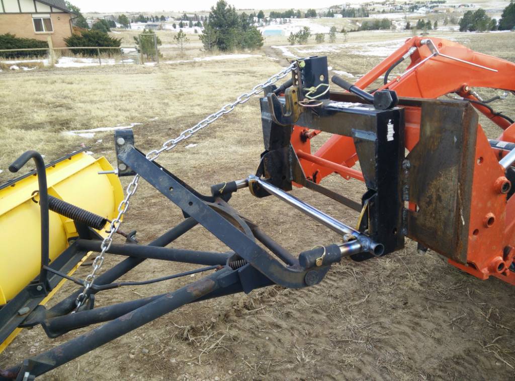

I made one for a plow mount on my L3200 (32hp, 2,500lbs). It worked well for the plow & moving some other impliments. Need more beef for your needs, but my cheap QH pulls my 1,700lbs flail through dense woody brush. Not sure if pushing would pose problems pulling doesn't.
