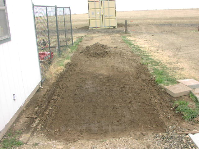

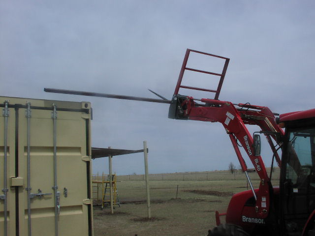

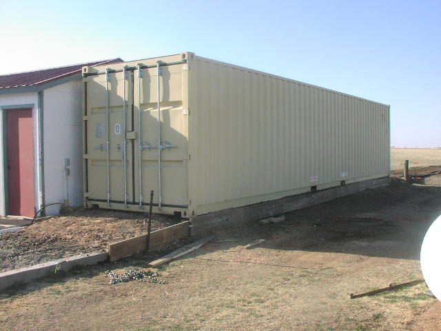

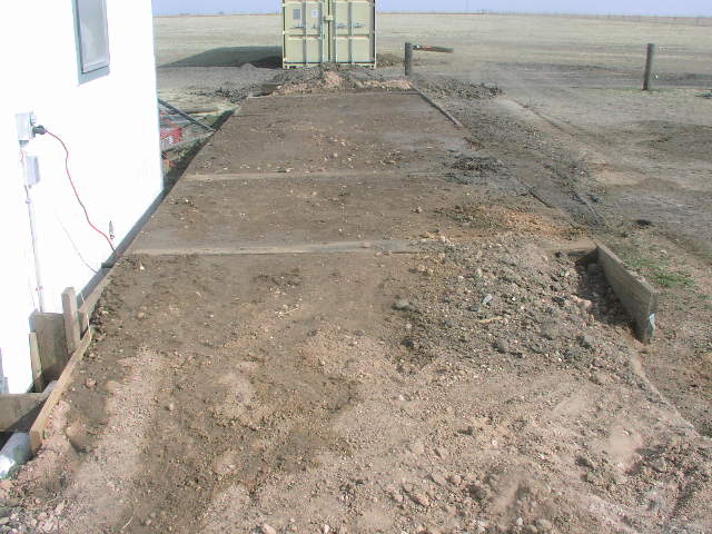

I would like to build a shed and attach it to my 40 Ft. container. It needs to be high enough to get my tractor (102 inches) under it.

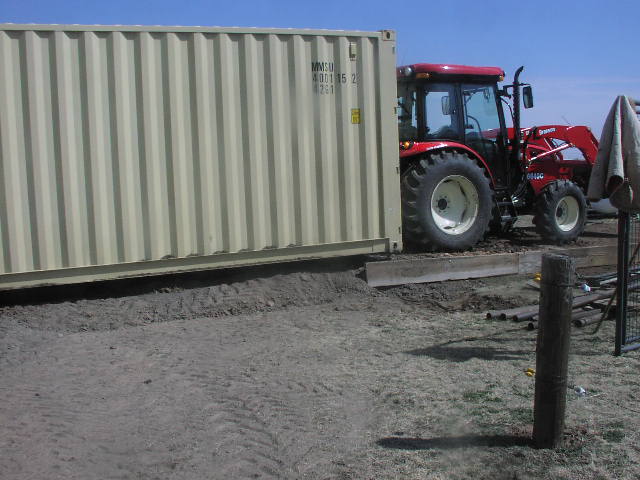

My first step is to raise the height of the container by 15". I will accomplish this by moving the container off site, build a dirt pad, add cross ties, fill spaces between ties. Then I placed the container back in place on the new pad. I will have more pics as I build this project.

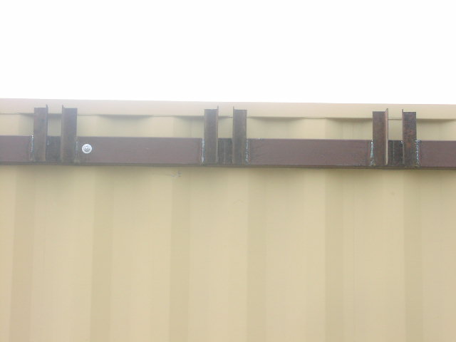

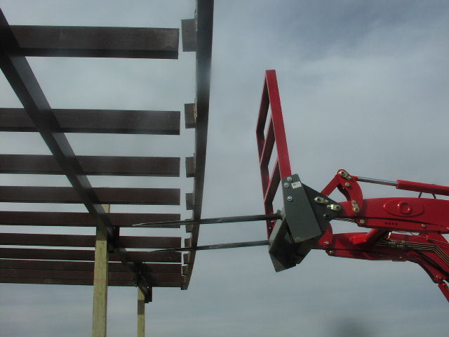

More pictures of work that I completed this week.

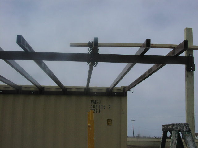

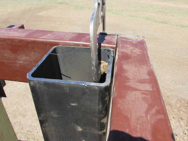

Headers bolted to container.

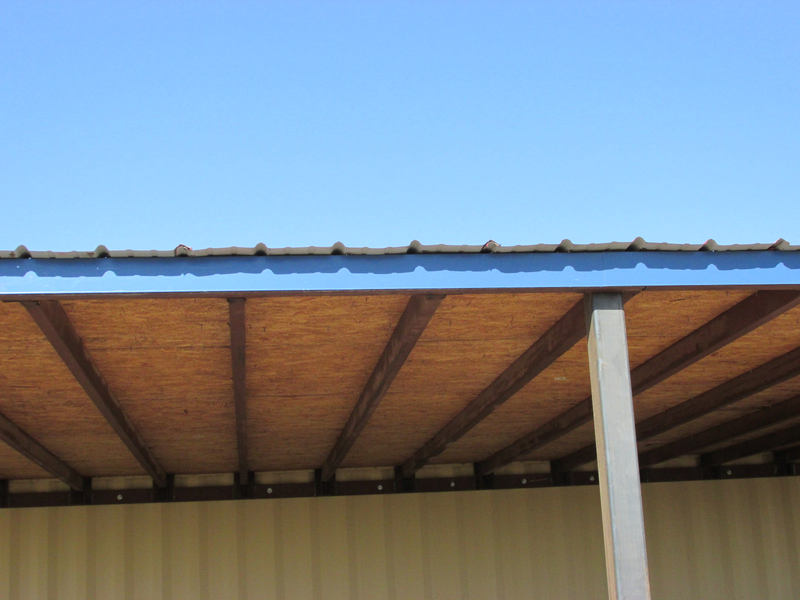

Placing rafters (2"x4" rectangular steel)
Tail of rafters are resting on temporary header and wood post. ( will be removed later)
Setting tail header.

Looks like a good step towards keeping the bottom of the container high and dry as well. Personally, I would not have filled between the ties. Are you going to have moisture problems in the low area between the pad and the building?

You also could of jacked up the container and built up just the corners with a quick plywood form and a few bags of concrete.

TC Jatko..Should not have a moisture Problem between the container and the storage building. I have a 4" drain pipe installed between the container and the storage building. The only water will be from the run off from the storage building. I have a berm built on the uphill side that will carry the run off around the container. I Hope. I filled between the ties, wet it down then compacted the fill with my tractor. The 2"x12" boards are bolted to the ends of the ties. The purpose of filling between the ties is to keep them from being "Rolled" or drug out of position when I pulled the container back on top of the fill.

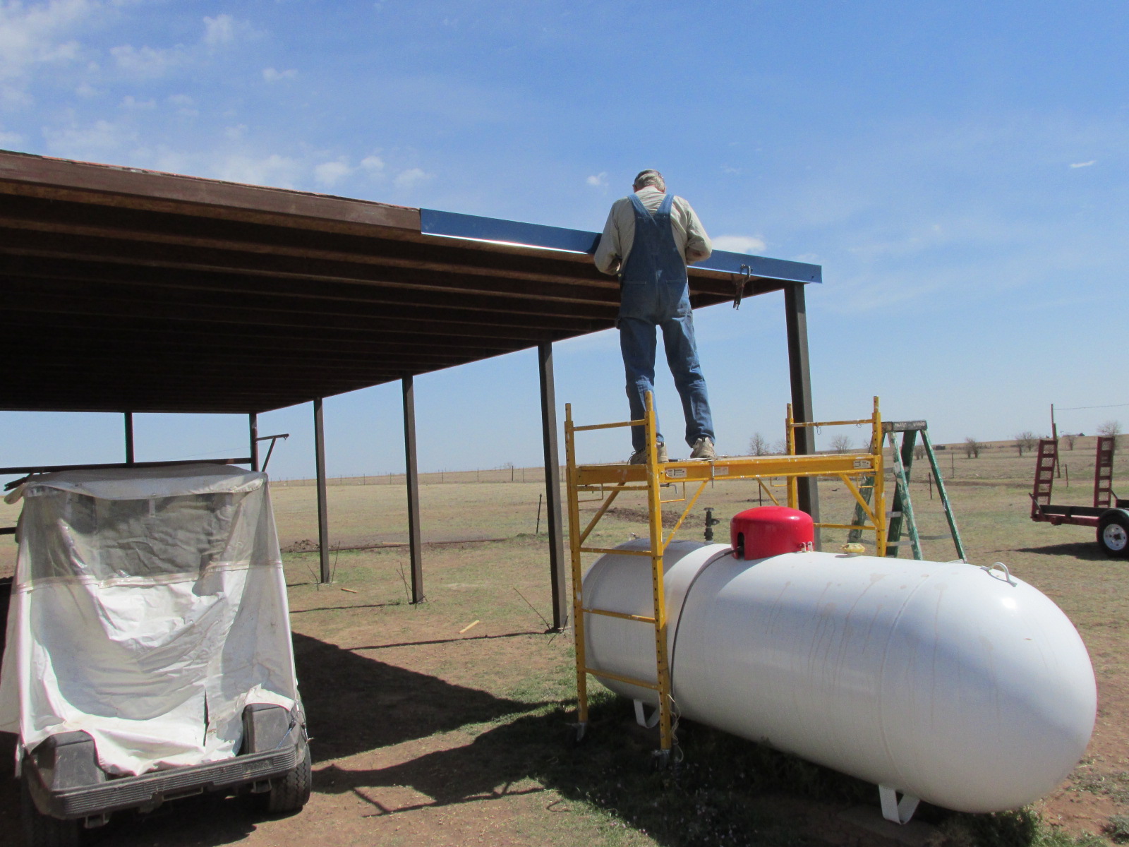

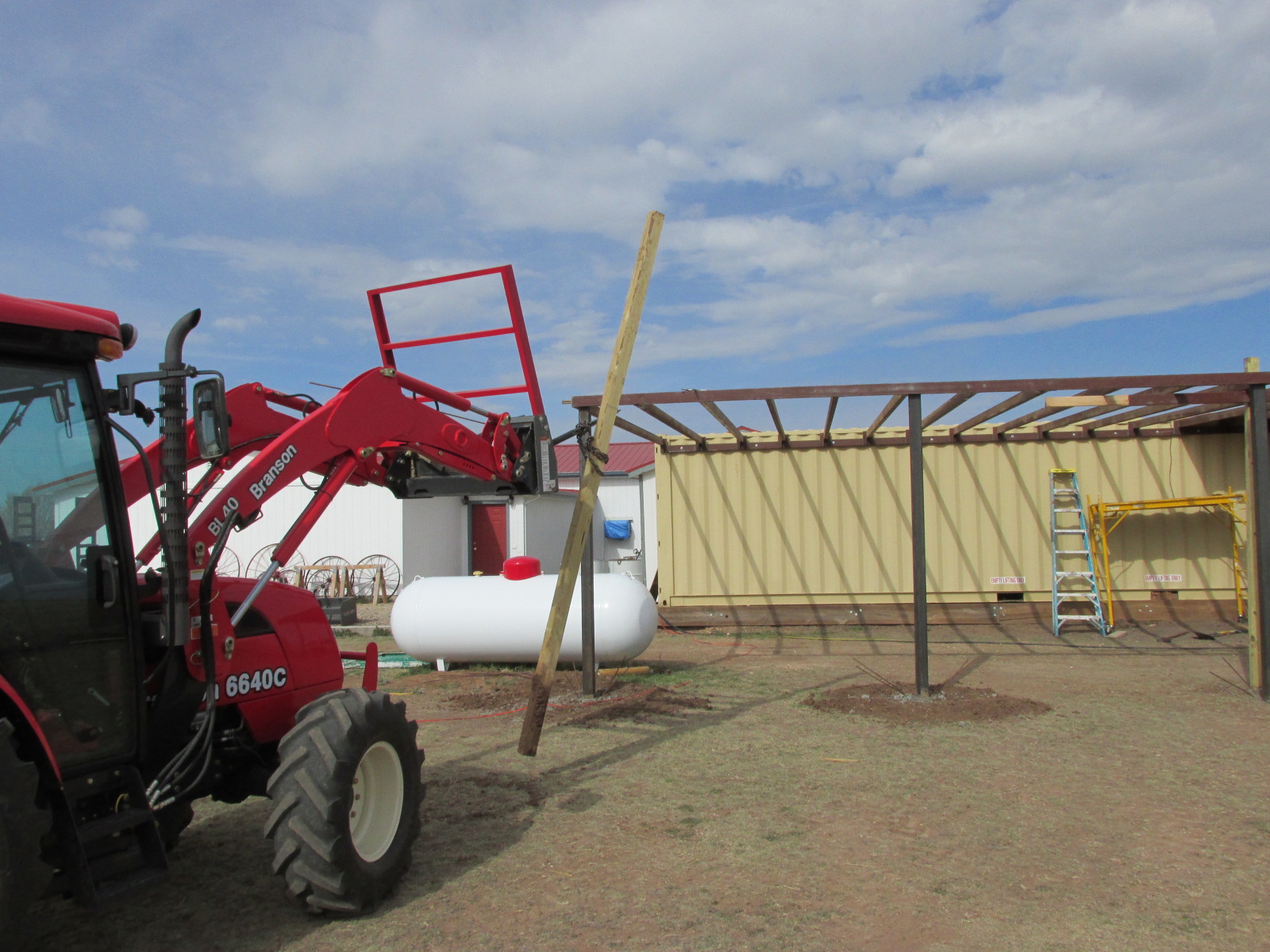

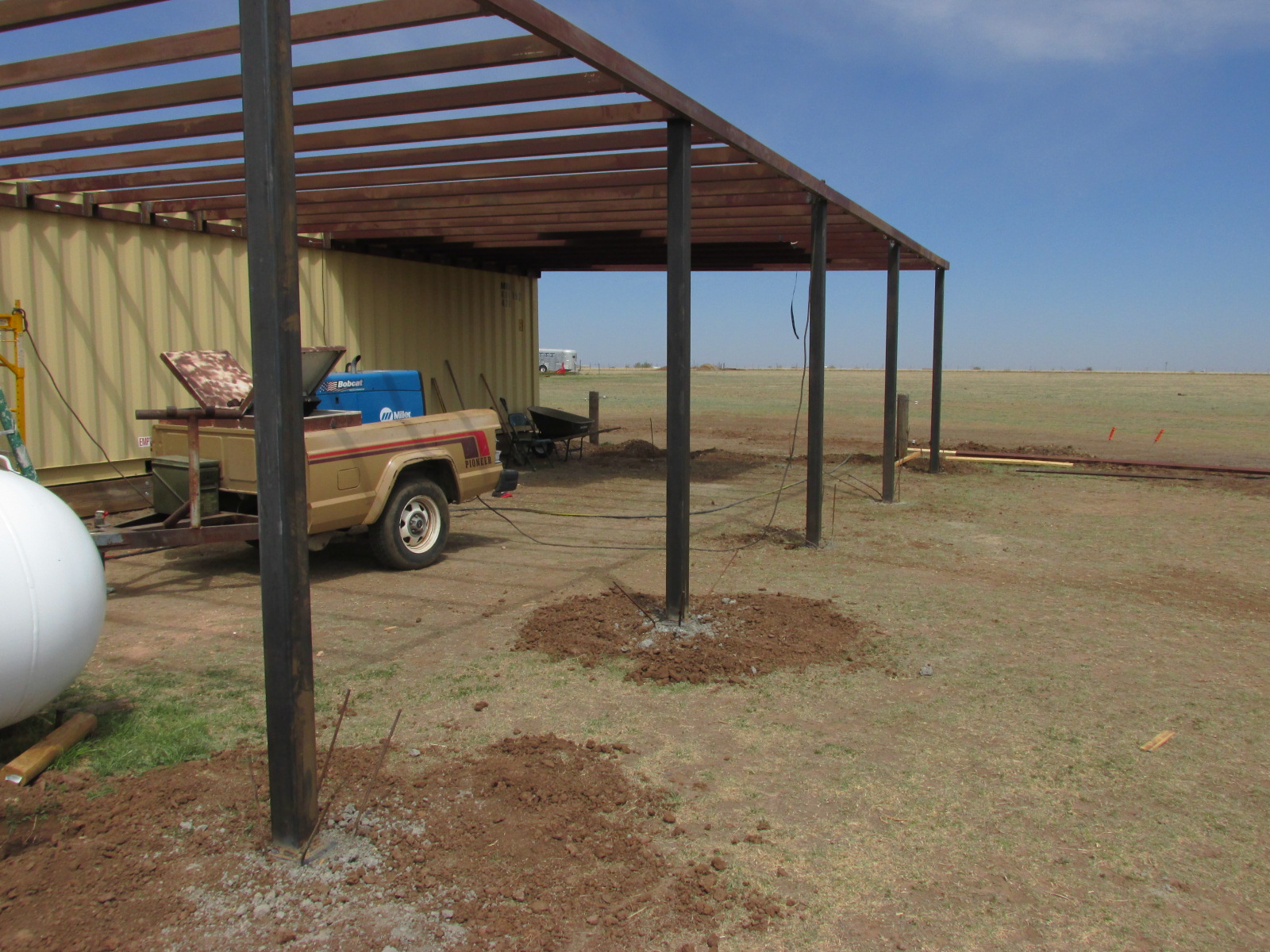

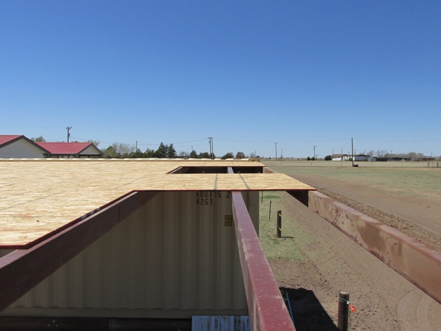

More progress on my project.
Installing the decking. The decking was also used to square the roof framing.
Here I am setting the permanent steel post
All post are set
Removing temporary post and header
Welding in all of the steel components

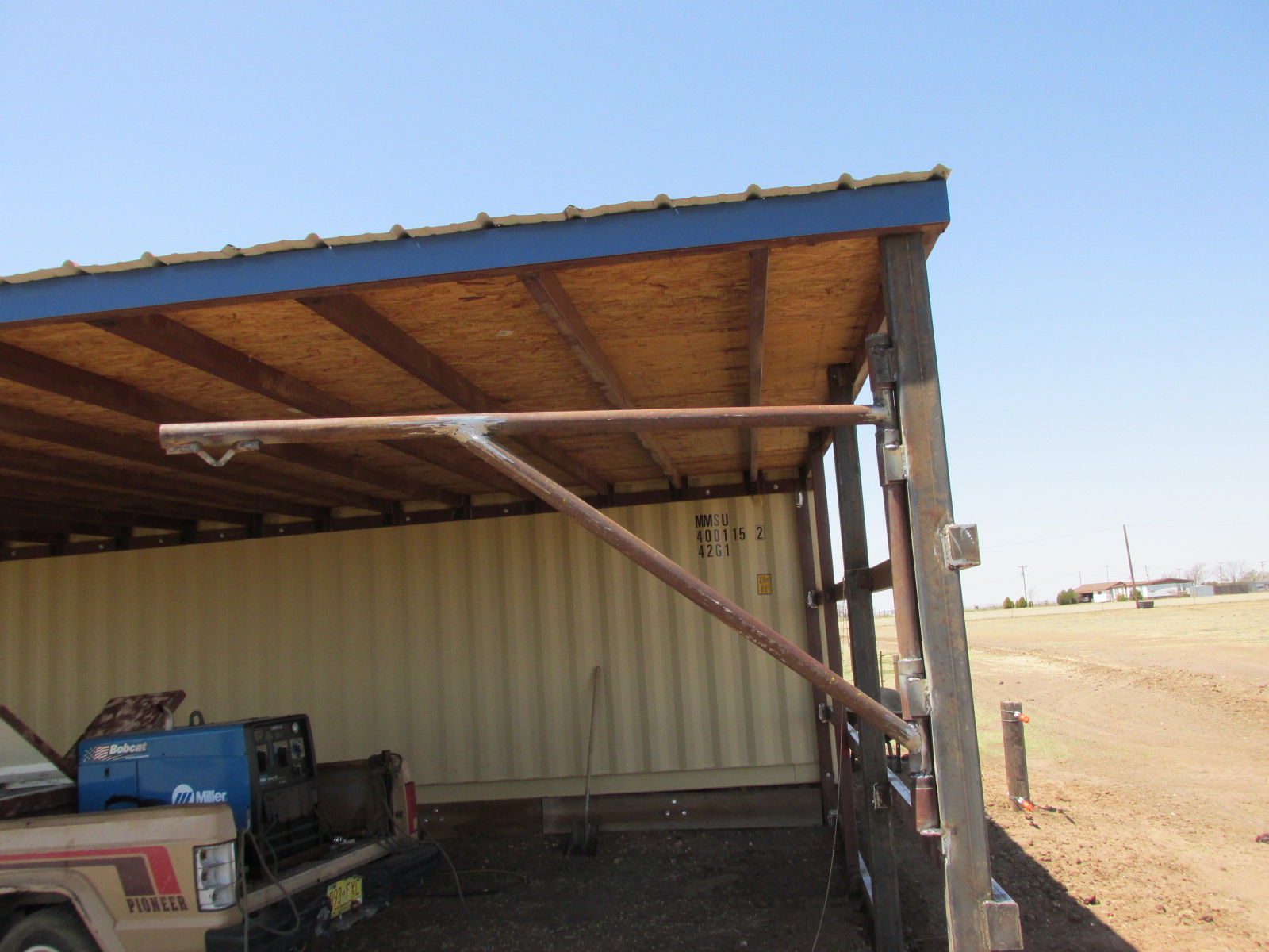

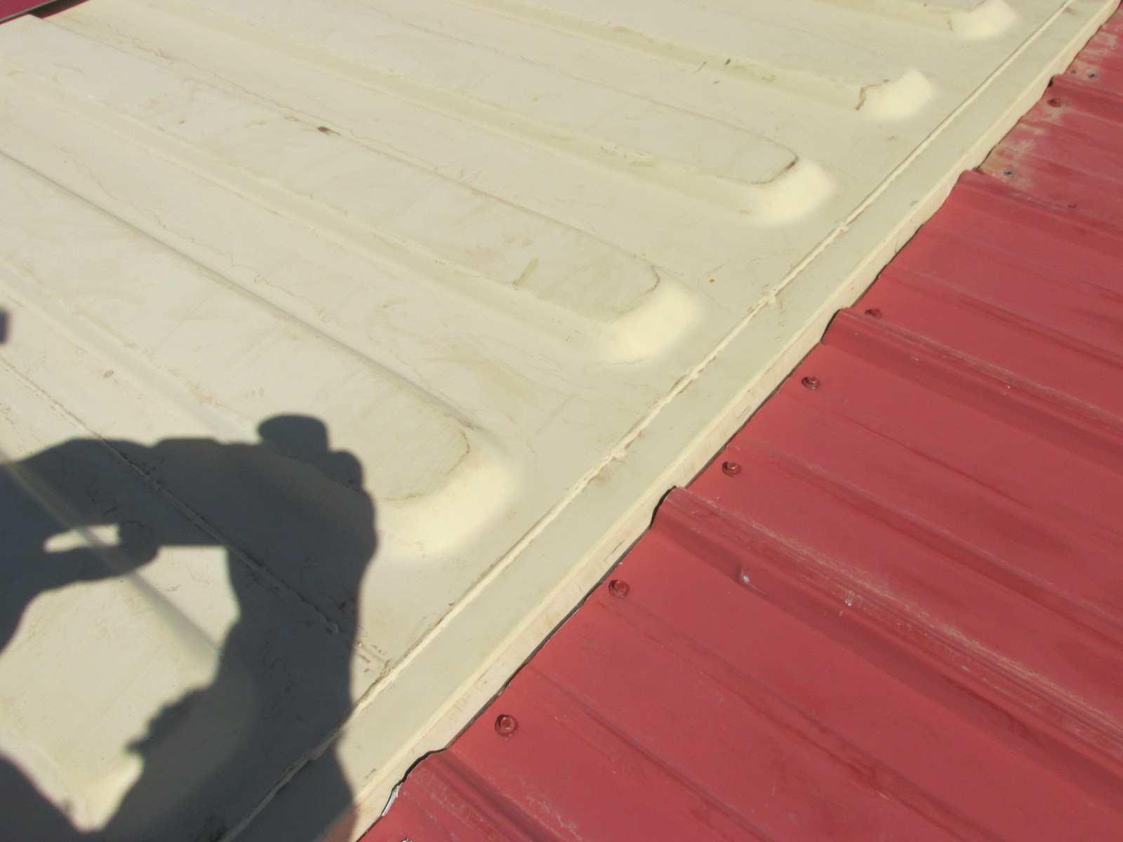

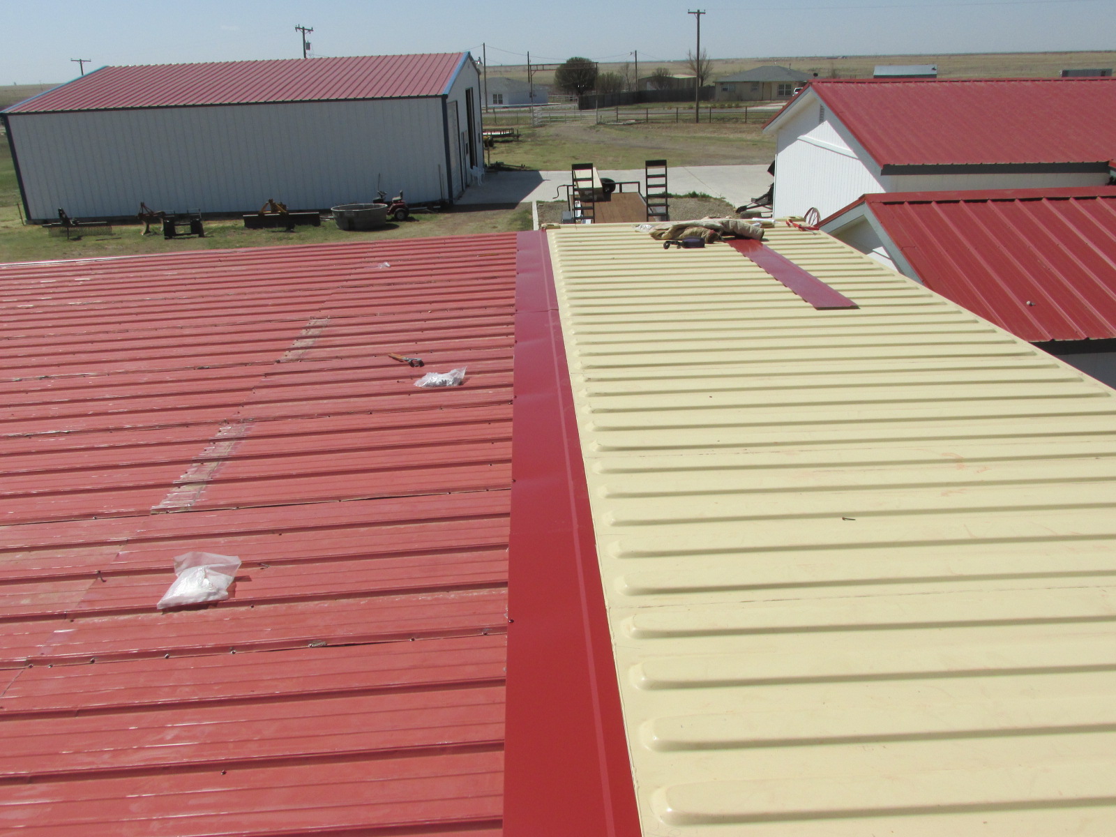

Project is now completed
Trim to tie container roof to shed roof.
Trim matches the trim on my shop.

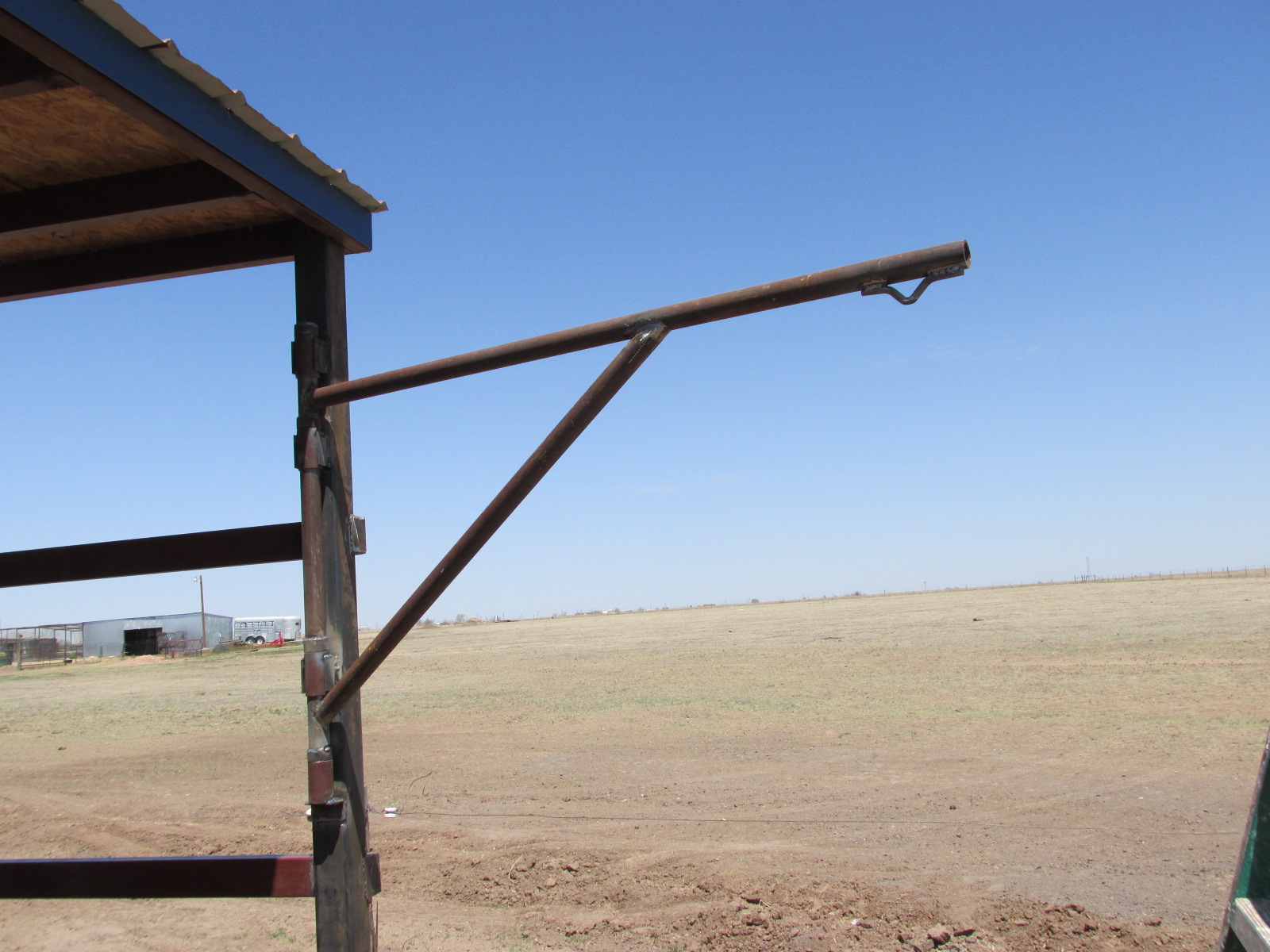

This swing arm will be used to dismount and mount my PHD. Swings under the roof for storage.

Nice job! How wide is it and what is the cost of the steel frame? I like the swing arm.
Dave
