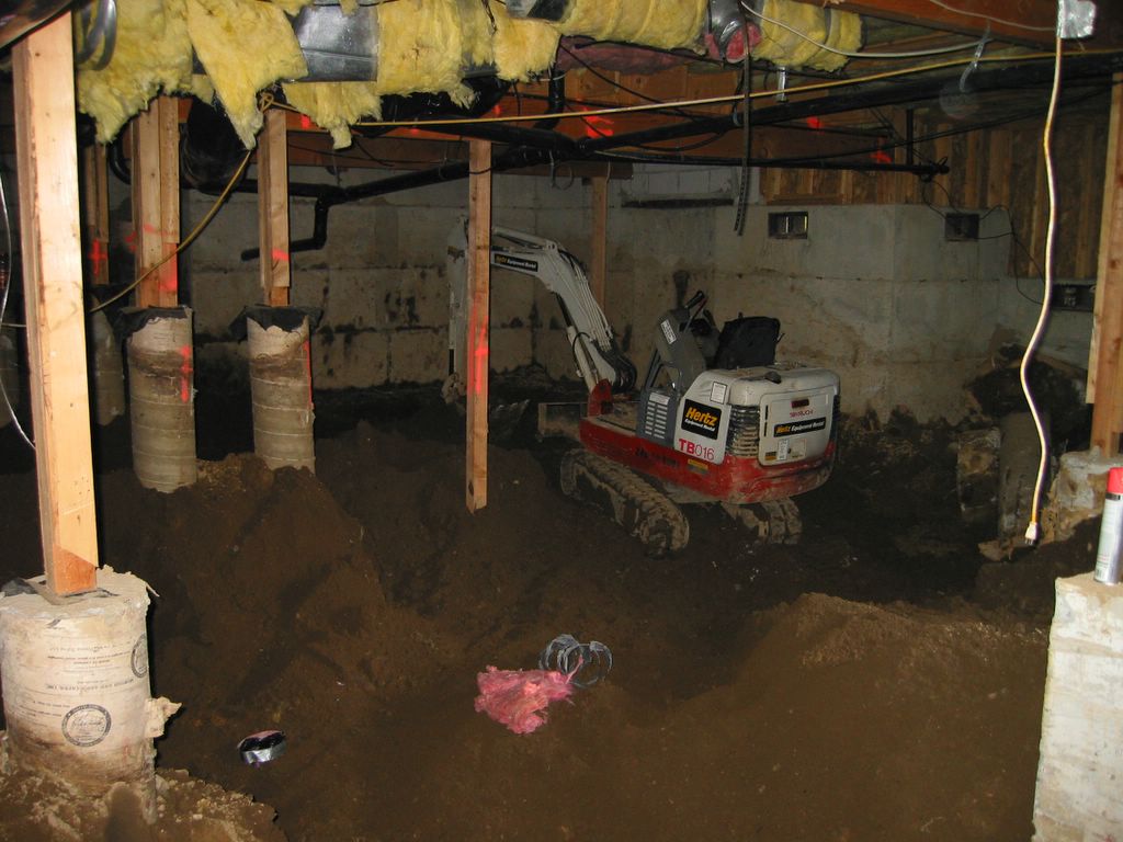

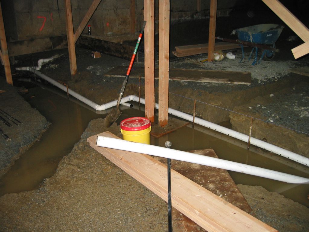

Thanks for the ideas so far. I guess I wasn't as clear as I needed to be on my idea. I'll have to dig a ramp from the side/back yard that goes down to basement finished grade; bottom of ramp will be deep enough to allow BobCat/Mini-excavator to be driven in. Call me not so bright (I did vote Republican) but the finished grade will be 10' beneath the house; that will give me plenty of space to drive the BobCat around once I enlarge the opening. It is after I get the opening big enough that I want to use the conveyor. It will take up a lot of time to get a bucket full of dirt, drive up the ramp, dump in back yard, drive down ramp, get another bucket of dirt, etc etc.
For those interested, I have attached some pics from a blogger who dug out his crawlspace in Northern VA. I tried to find his blog but google didn't turn up anything.
