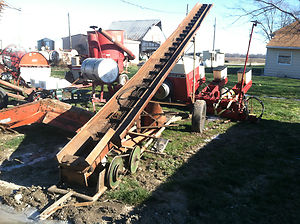

when they hand dug basement under houses around here they used a ear corn elevator usually taken off it wheels, if your using a skid loader make a ramp and haul it out the ramp with the loader. most of this type used what was called square steel sprocket chain and the links were stamped steel that had a end curled so they could attached, special link about ever foot were used to attach the paddles to most used two chains,, and used a cast sprocket,
link to one source,
http://shop.evansimplement.com/prod...E.m1plqscsfapp04?productId=3112&categoryId=43
http://shop.evansimplement.com/prod...AE.m1plqscsfapp04?productId=983&categoryId=43
http://shop.evansimplement.com/prod...E.m1plqscsfapp04?productId=3110&categoryId=43
and you would need chain and sprockets,
some time ebay .
a place call Baum Iron carried all the stuff at one time,
http://www.baumhydraulics.com/home.php?cat=397&sort=orderby&sort_direction=0&page=2
most of the newer type of units use a roller type chain now that #550, it is what corn header chains are made out of, (if you have a neighbor or a dealership in your area that does corn, they replace the gathering chains (some every season) they have a extended part one could weld a paddle on or a bolt pad, they most like will give them to you, if not scrap iron price should get them, and pick up any replaced sprockets, you will need one on the drive end one on the idler end, I would most like make a dual drive chain, keep it running smoother, just hook them together to get the length you want.
I would drive from the top end on your project, weld on paddles or bolt pads and make paddles that will clean to the bottom of the elevator,
one can use wood or steel for the bottom of the unit, (most corn elevator enclosed the bottom of the elevator as the chain will droop and be hazard and or catch on some thing, so it is a box with a trough,
but used corn header chains would be the most economical route to take, if you want this type of unit, make the idler shaft with a lot of take up, up to 18 inches, at least 12 inches, keep the shafts parallel,
hope that helps, if you ever use them for elevating concrete wash them out very well, (the chains), power washer is best, to get the chains clean, and keep away from the moving parts when operationing.
