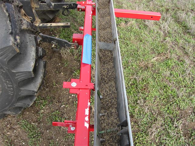

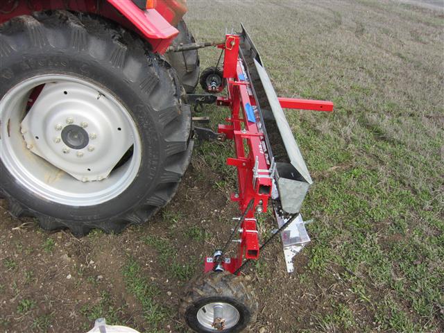

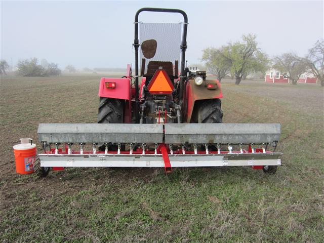

I built this drop seeder a few years ago. Used a pair of 5-ft wide grass seed boxes from an old Minneapolis Moline P3-6 grain drill.
I use it to plant grass seed mixes as cover crop on my hayfield.
Just welded up a frame from 2x2 inch square tubing, added the 3-pt hitch connection to the frame and bolted the boxes onto the frame.
The two-bounce seed chute on the output ends of the drop tubes spreads the seed out more or less uniformly in a line so you don't get the seed planted in rows with 6-inch separation, which is what you get without the seed chute.
The feeds are driven with a simple #40 chain, sprocket and drive wheel setup.
It's designed to be used after the hayfield has been worked over with a disc harrow and then grooved with
a cultipacker. I press the seed into the soil with a 10-ft wide roller.
It takes 3 passes over the hayfield using this method. Right now I'm building a 10-row no-till drill to do the job in one pass with no tilling or cultipacking required.
Good luck with your project.
