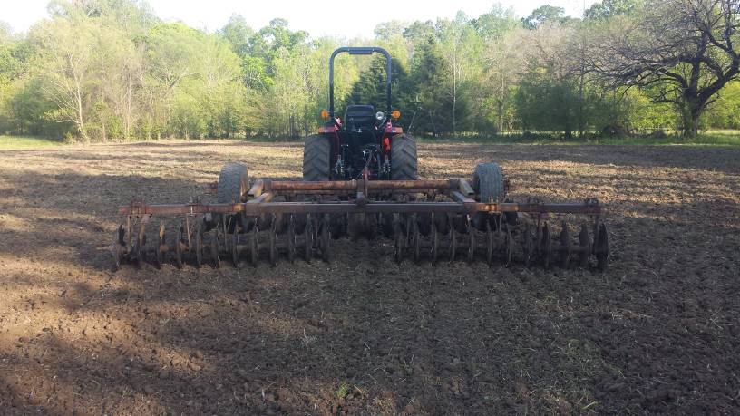

I like your heavy frame and you can see the result by your blade depth. You seem to be in sandy loam which helps your penetration.
I had a pretty heavy frame on mine but added 4 JD rear wheel weights (600#) which helped penetrate my Houston Black Clay.
With that rig and my 6530, B-1 or 2 is all it wants. I think you are sized right for that tractor.

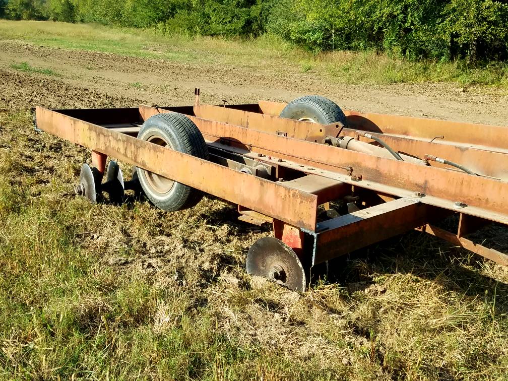

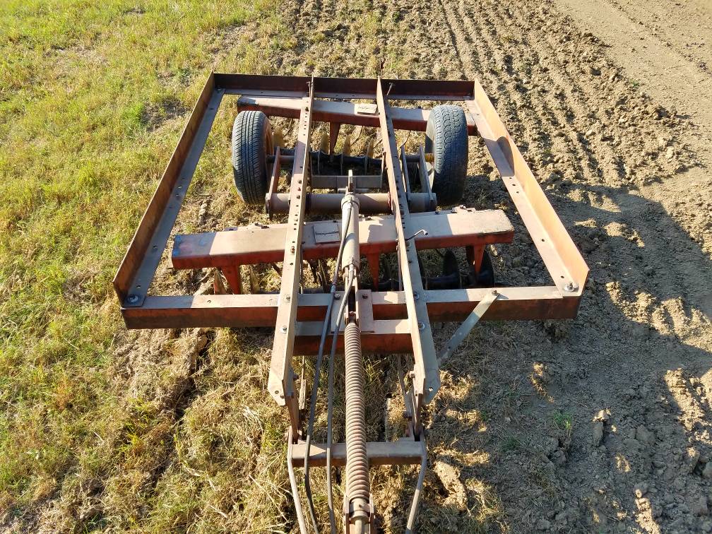

I've been off the forums for a while! Didn't even realize had several replies on this thread. Yes, the Branson will pull a larger disc than that. I've pulled a 12 foot lighter disc. That old IH disc would have stopped it in its tracks! It would make my 1256 blow black smoke! I wanted a heavy cutting disc for new small plots and hard to get to areas. It fits the bill perfectly. I also love fabricating, so why not! The ground in the following pictures was hard as a rock! 20161002_162818.jpg20161002_162843.jpg

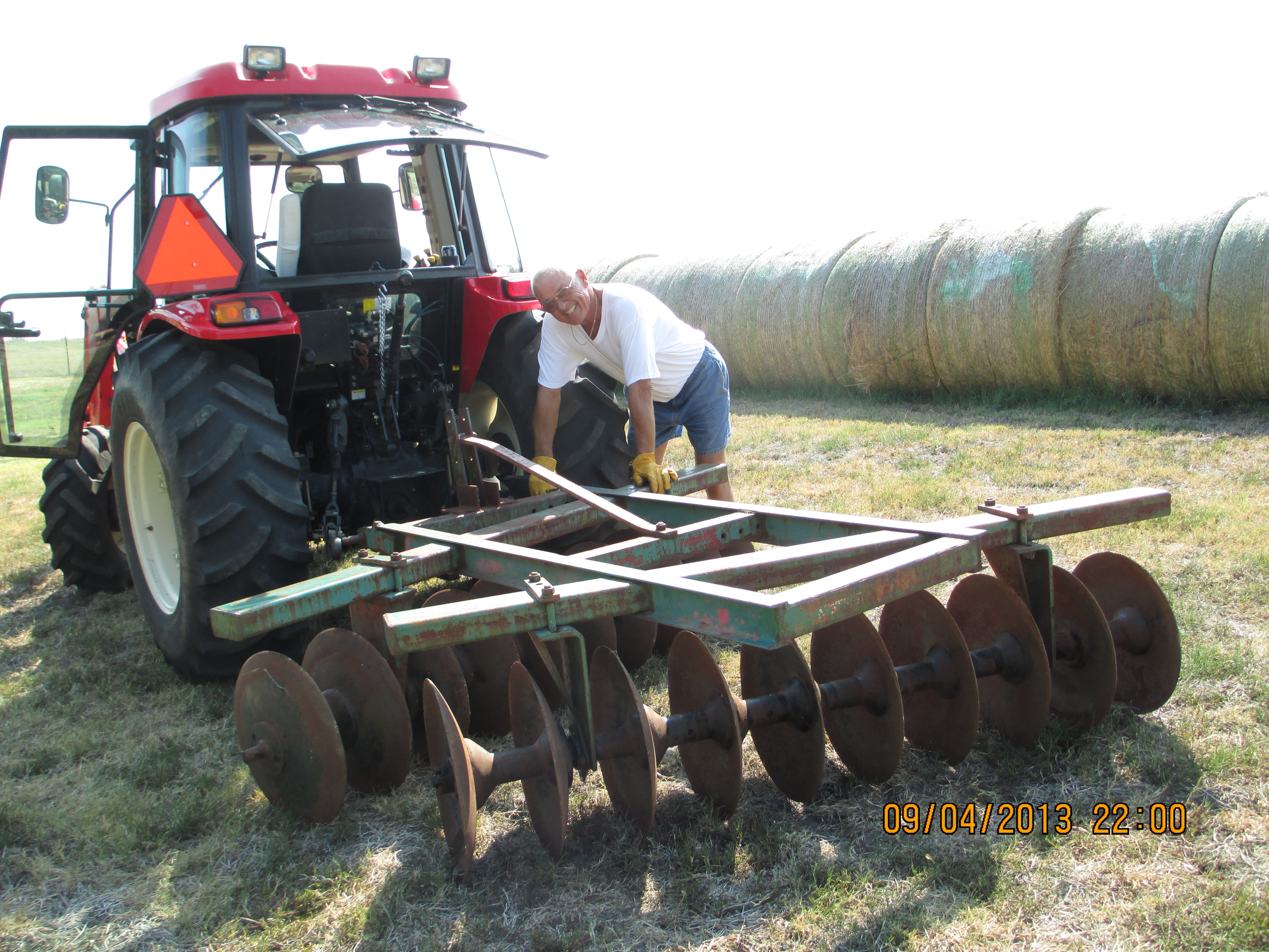

20160410_174415.jpg Pulling the 12 foot.
