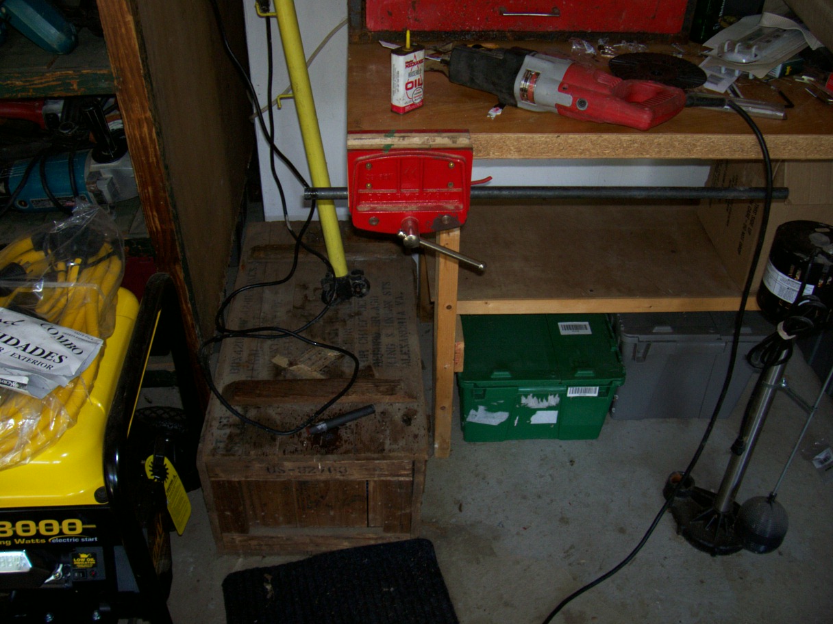

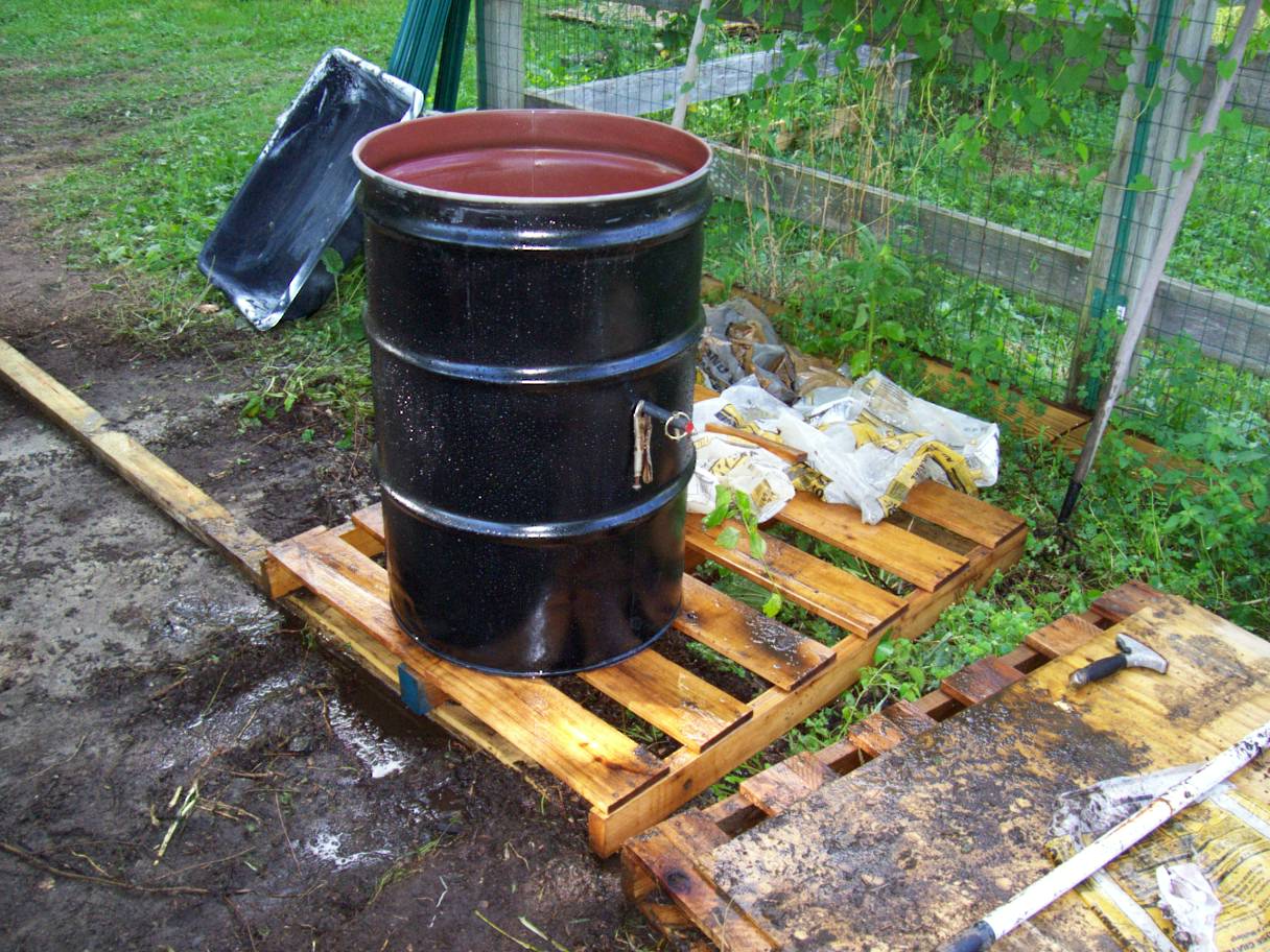

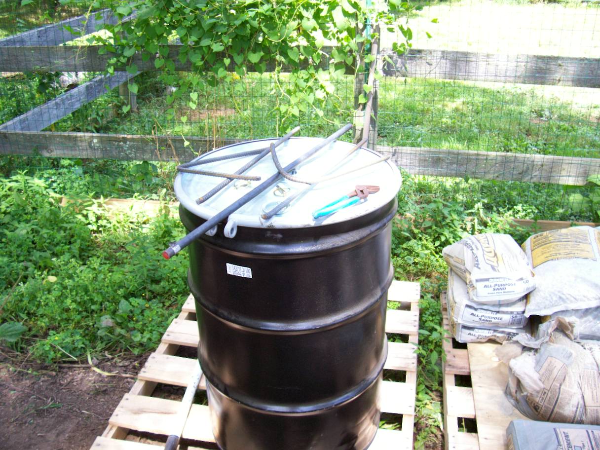

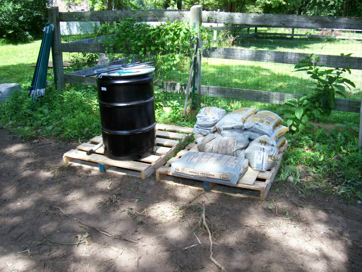

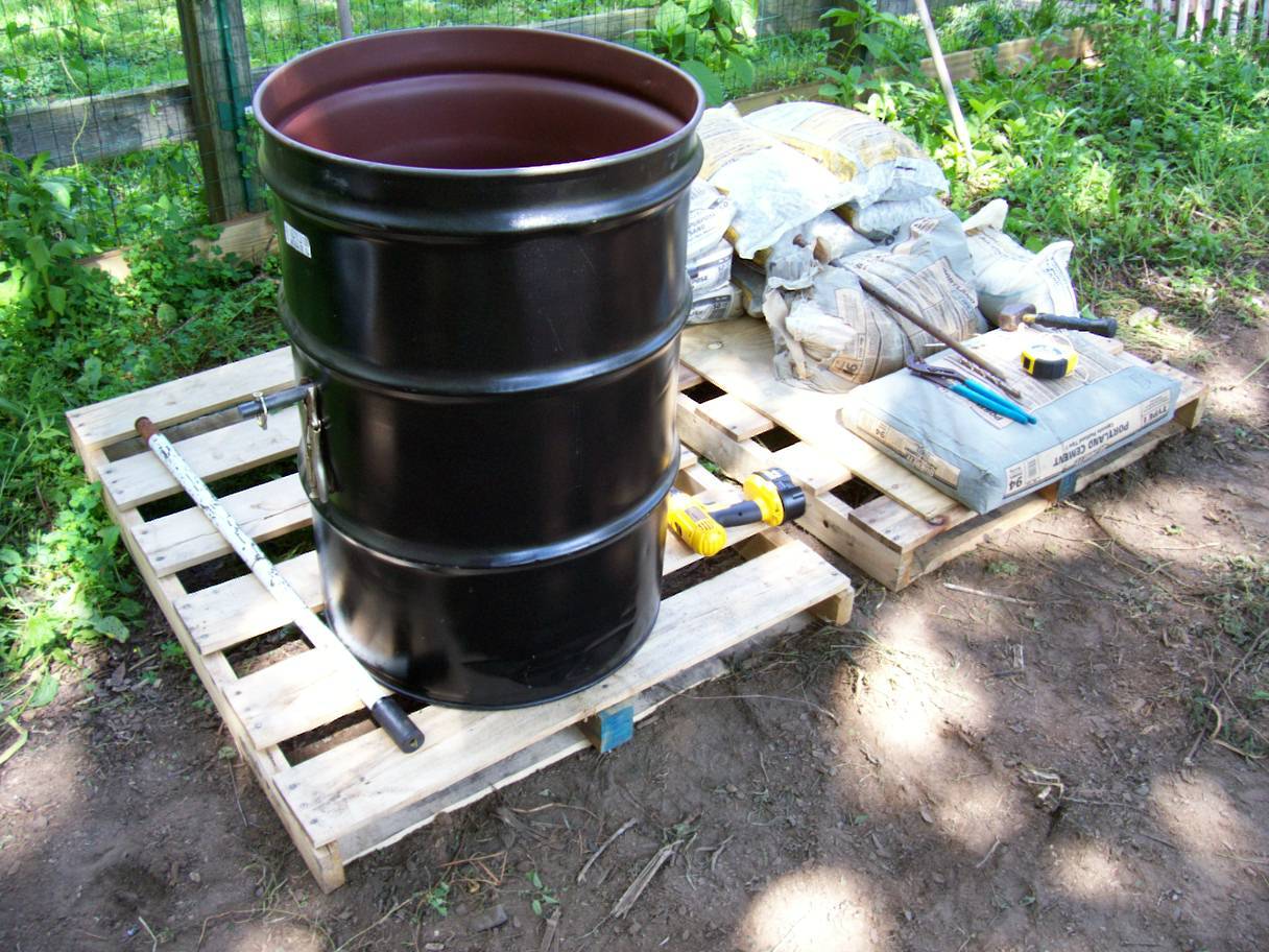

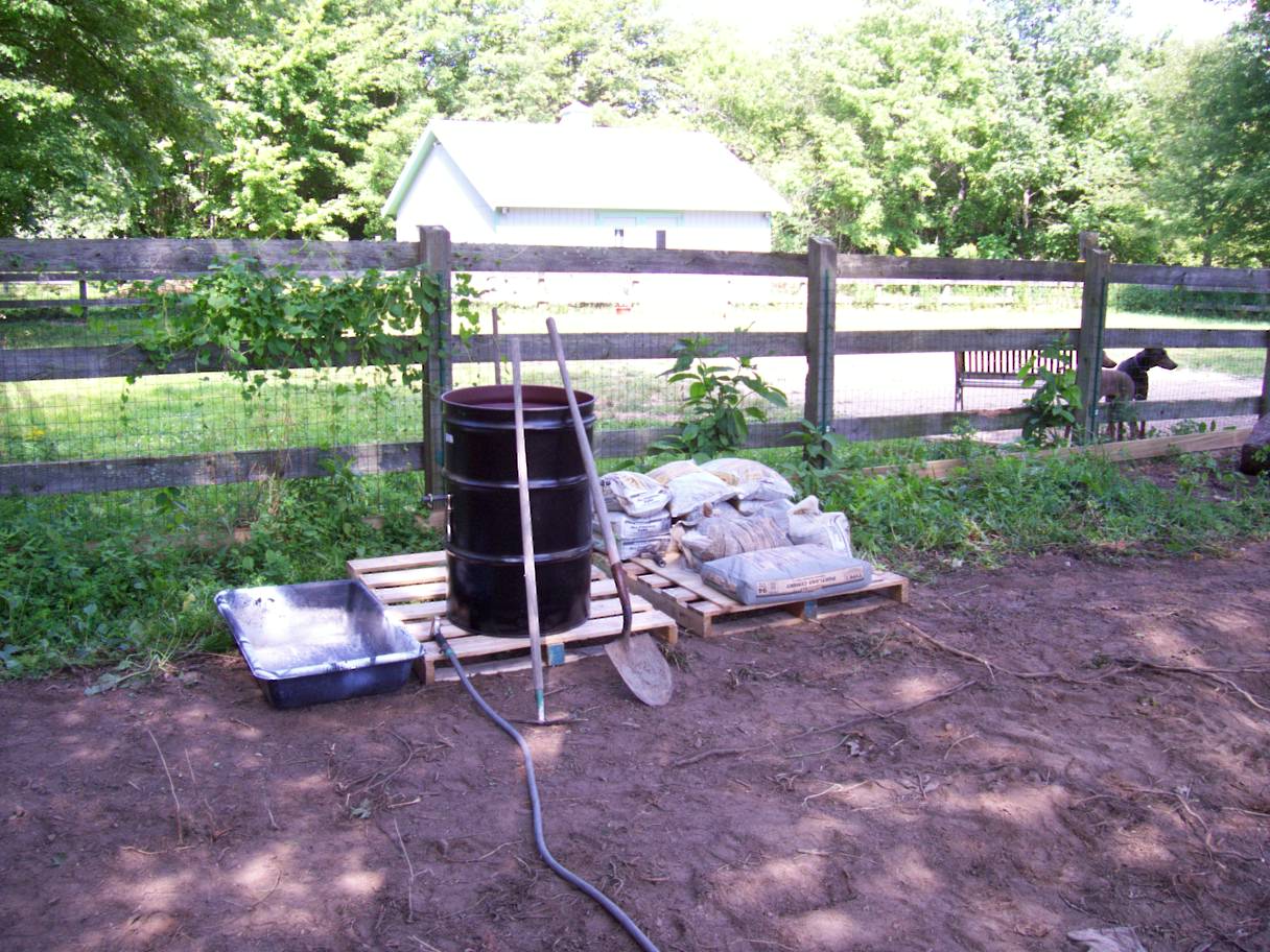

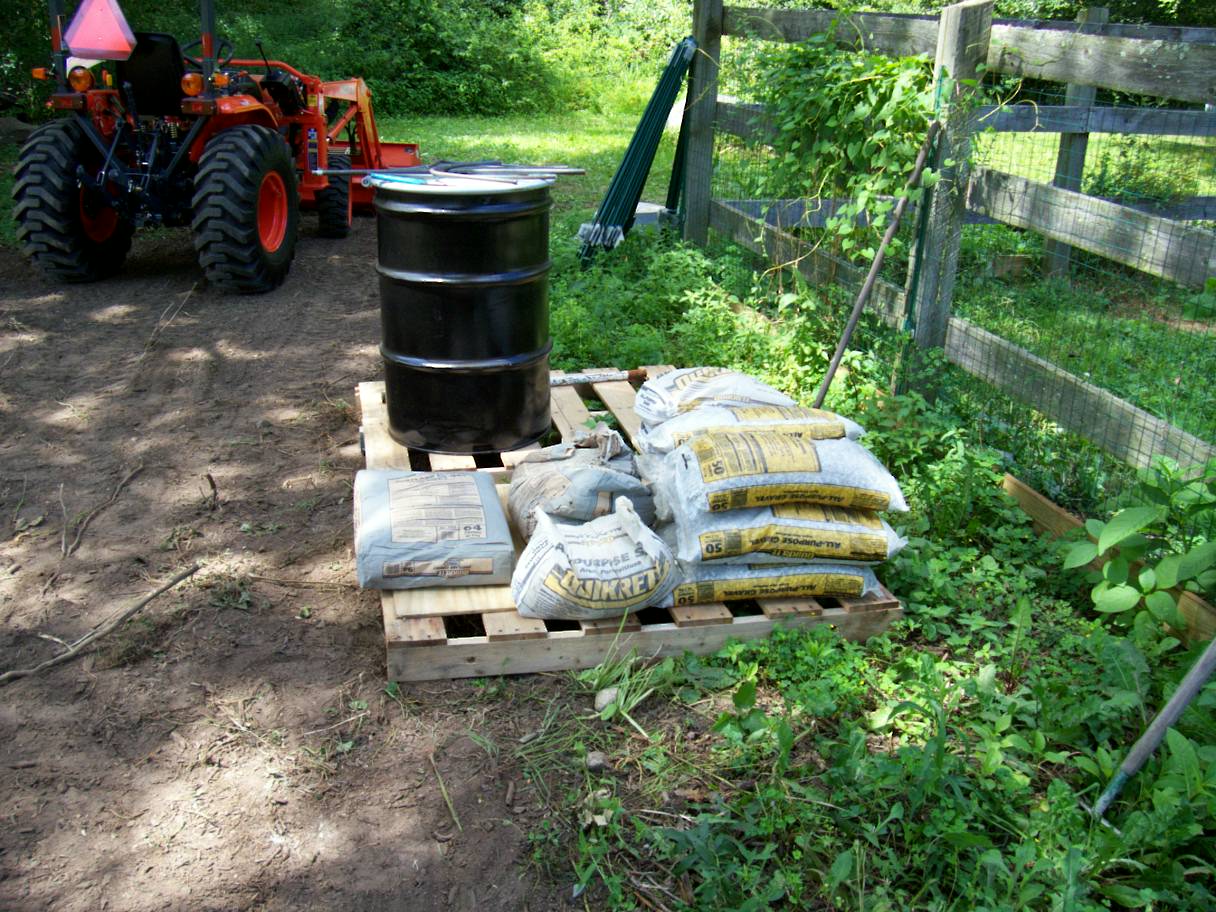

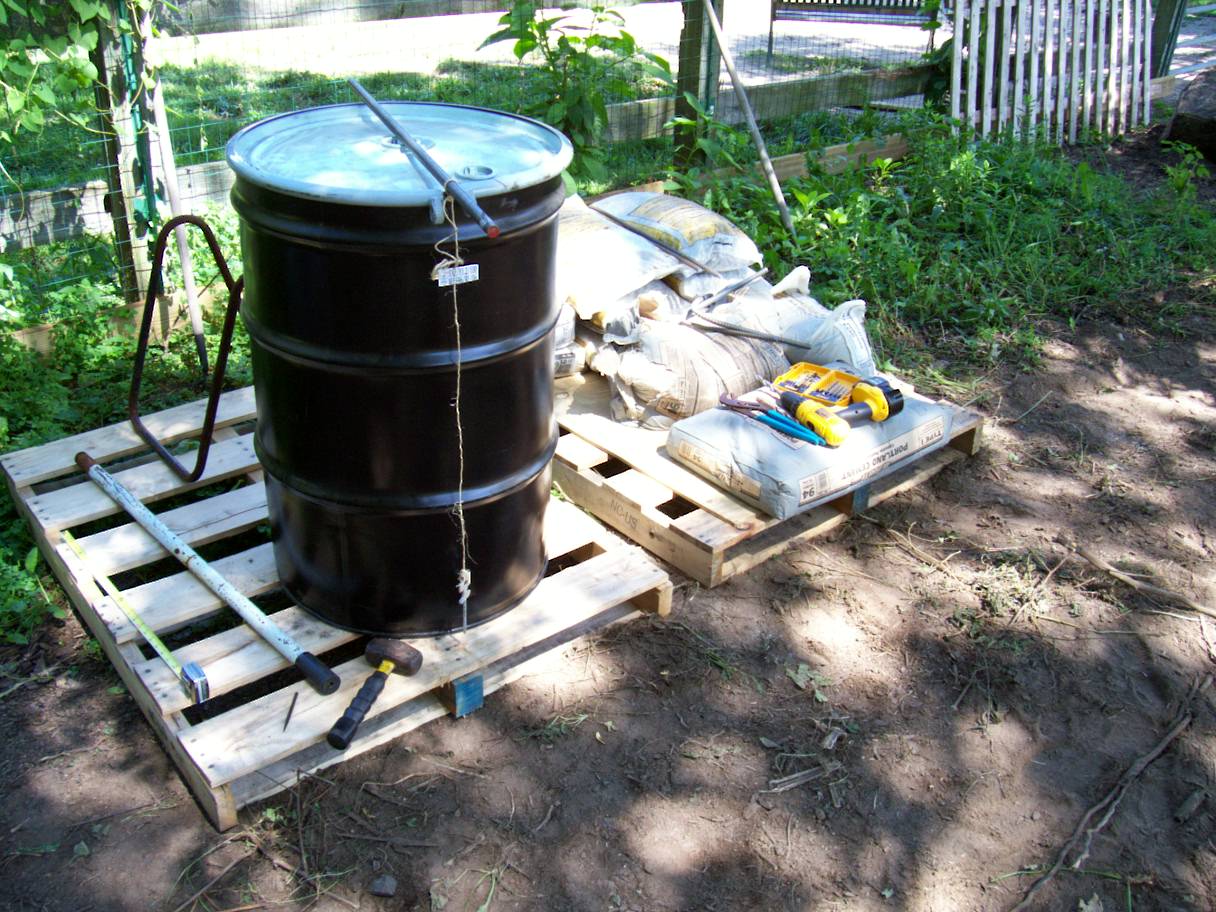

OK Todays Tractor project was a 3 point Balast box for my B7800
I was fortunate to acquire a new 55 gallon drum with a lid and a
snap ring. I went to Lows and picked up my 2 bags of cement,
4 bags of sand and 6 bags of stone. I also grabbed a piece of 3/4
solid steel rod and some re-bar and a couple of clevis pins

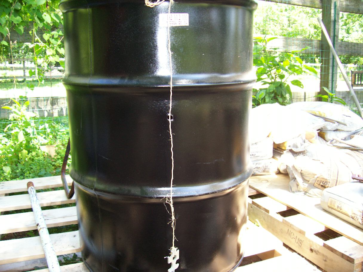

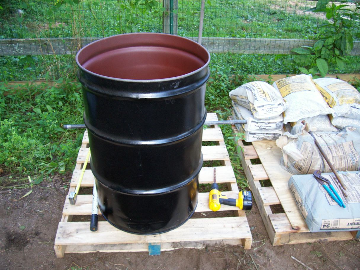

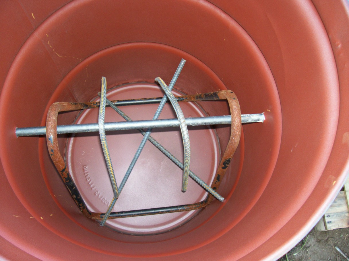

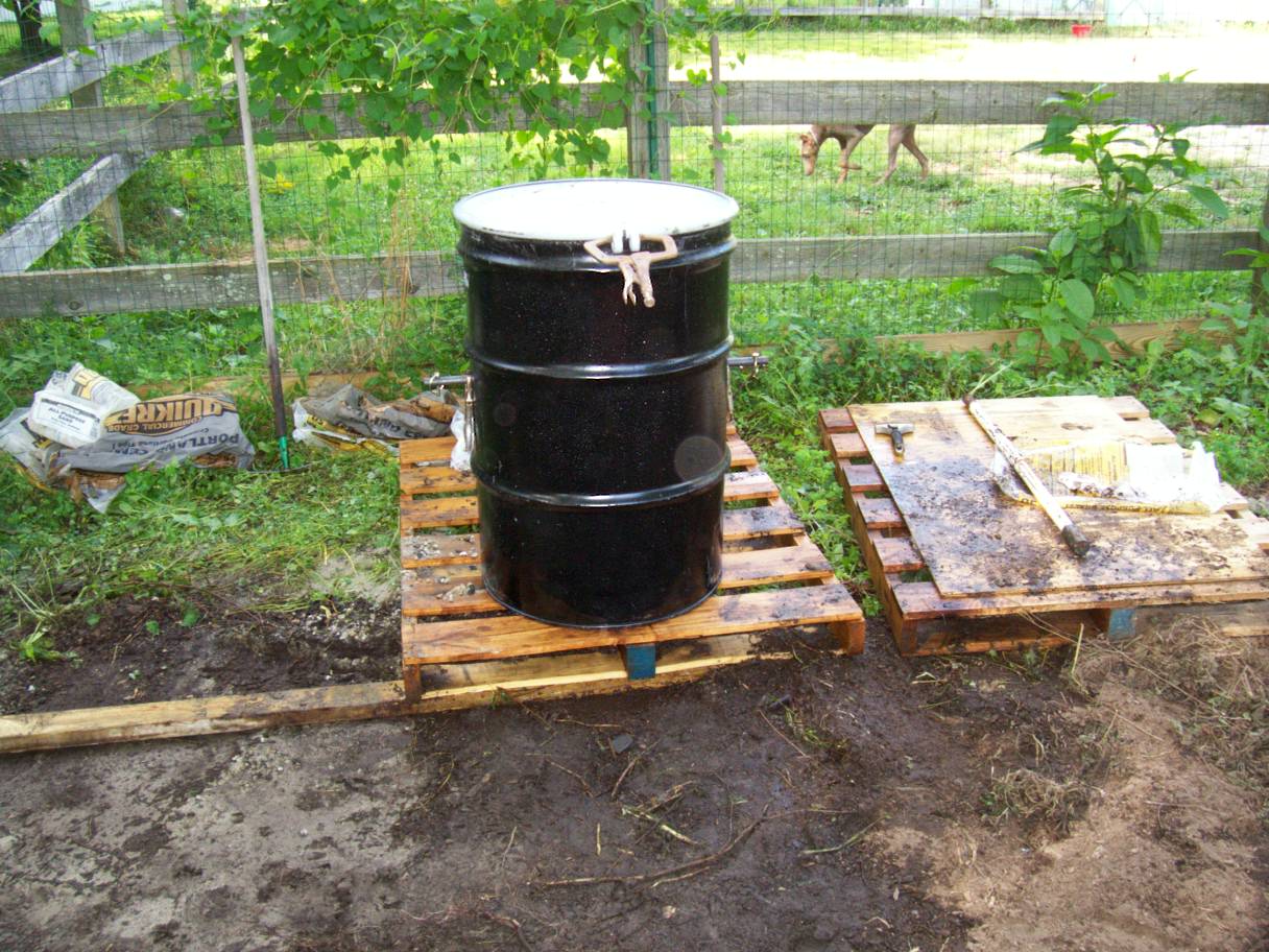

OK 1st thin is to drill the holes to run my 3/4 rod through. I set my rod on top
of the barrel in the center. Then I dropped a plum line from the rod on each side. I measured up the distance in my case it was 20 inches from the bottom.
I marled the holes with a punch and the drilled them out with a hand drill. I pushed my rod through. Determined how much stock I was gona cut off and then I dry fit all my re-bar

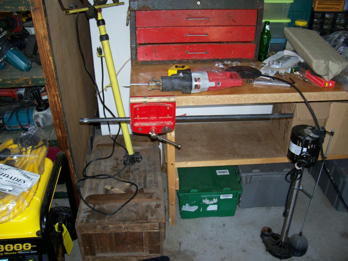

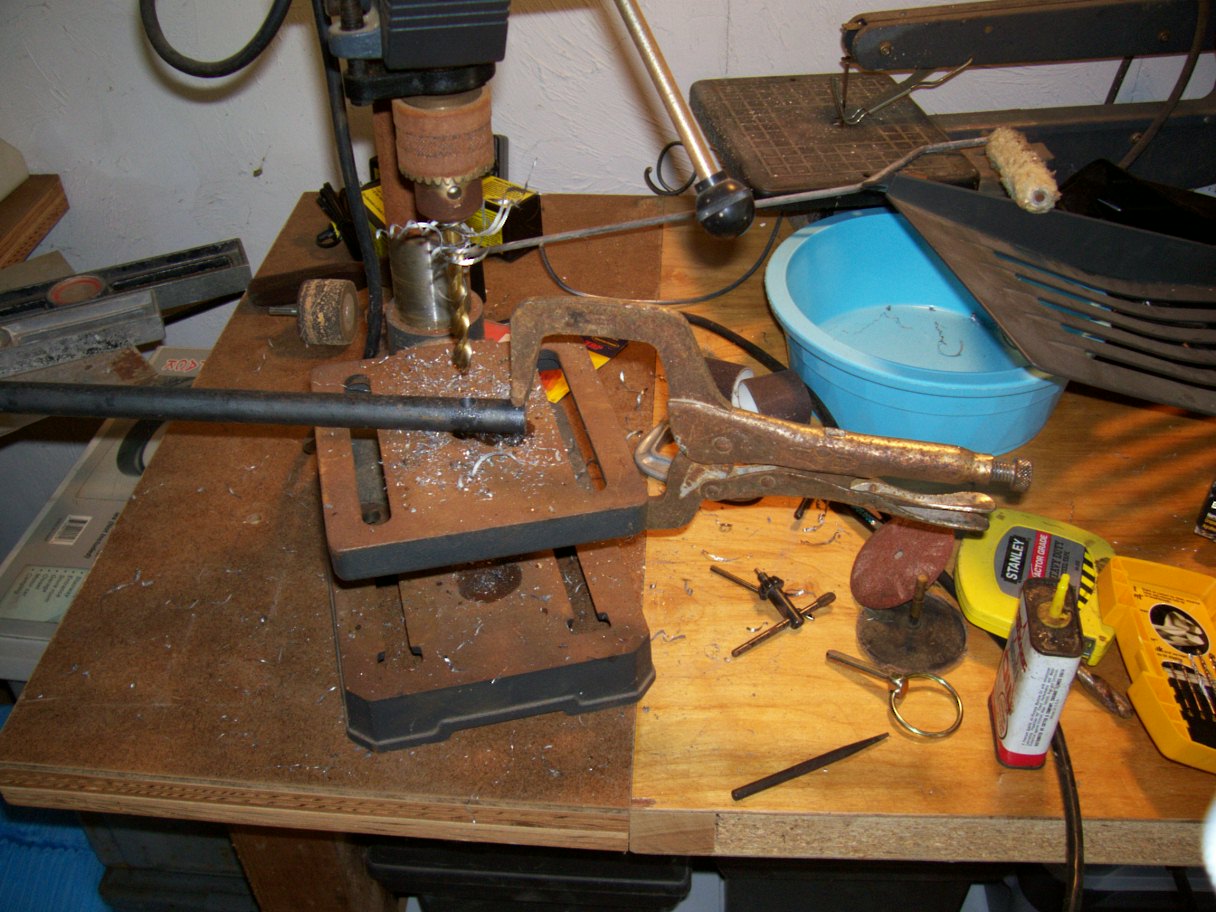

I am going to have my rod extend 4 inches out each side of the barrel
so I am cutting off 5 inches of waste. I'm breaking out my sawzall an a new Lenox metal blade. Little oil and in a few seconds we are done. So now we mark the hole for the clevis pins. I'm coming in 1 1/4 inch from the end and mark it with a punch. Take it over to the drill press, clamp it to the bed. Now I use 2 bits. 1/8 and then went to a 3/8 and done. Now take it back and fit it all together

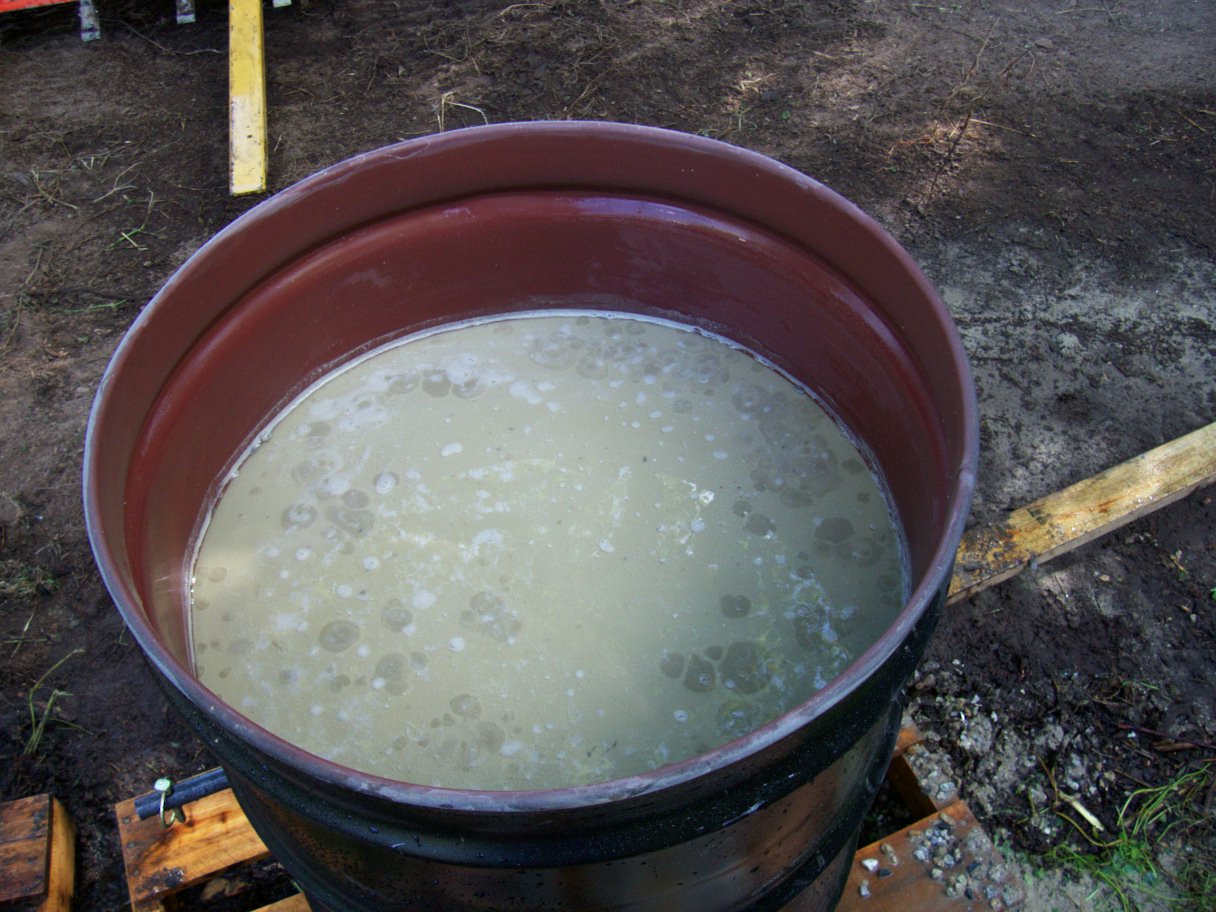

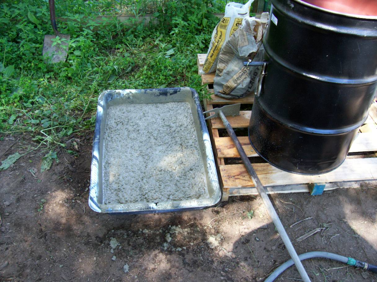

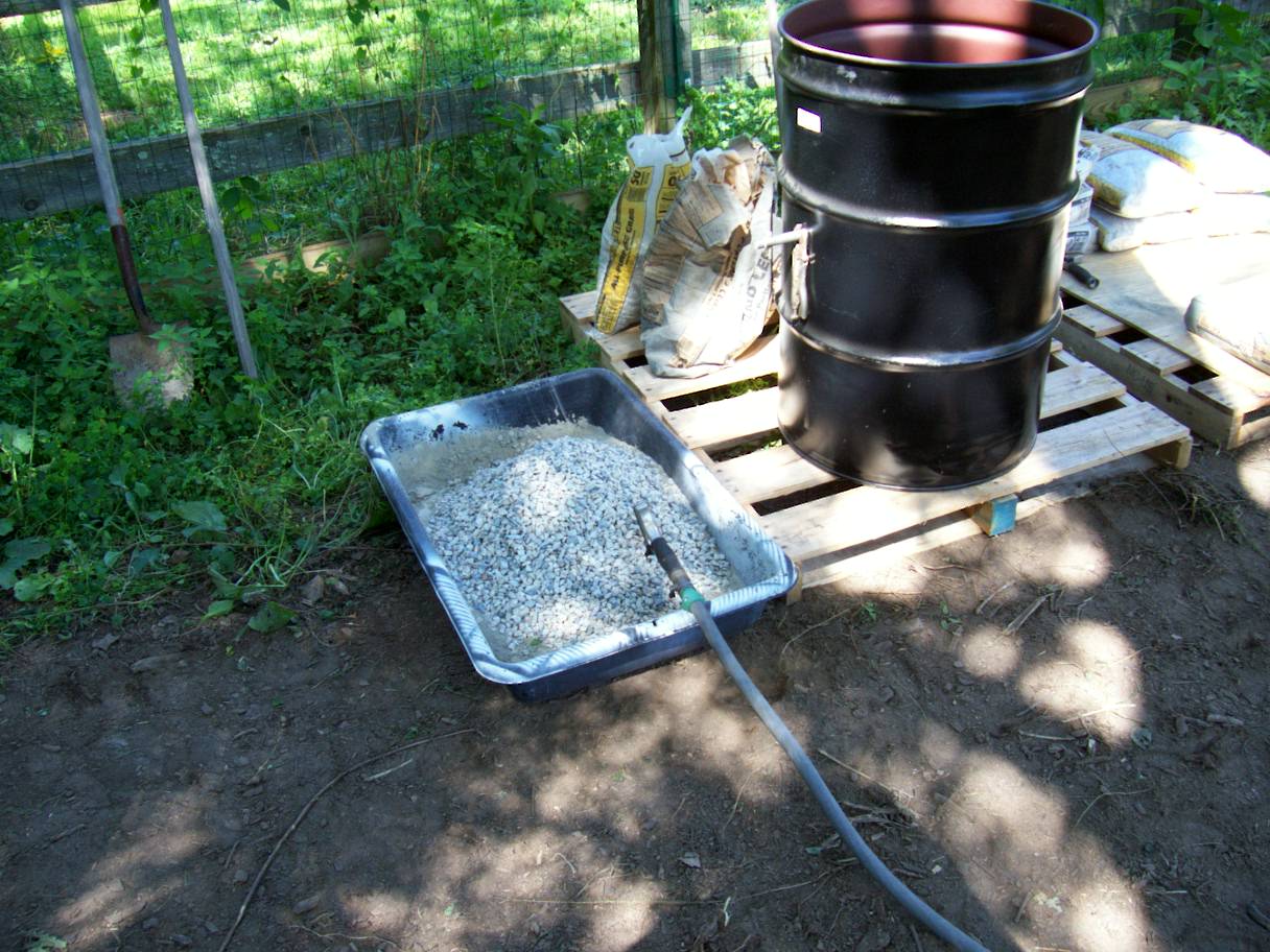

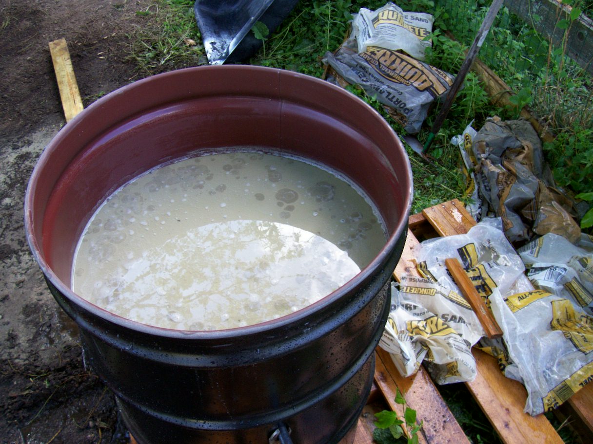

Now its time for the messy part. Get out your mixing tub, spade,
garden hose and your hoe. Pick a nice cool spot and a place were you can leave this thing for a week or so. Don't do this in your driveway or your garage. The mix I am using is 1 bag of cement, 2 bags of sand,3 bags of stone.The 1st thing is set the rod and clamp it into place so it stays were you put it. That is the mix. I do 1/2 of that at a time. Be careful it gets real wet before you know it. So wet it mix wet it mix a little at a time. You kind of want it like clam chowder. When you get it mixed start shoveling it in. Keep rinsing off the outside so it stays clean. then do the next batch till your done

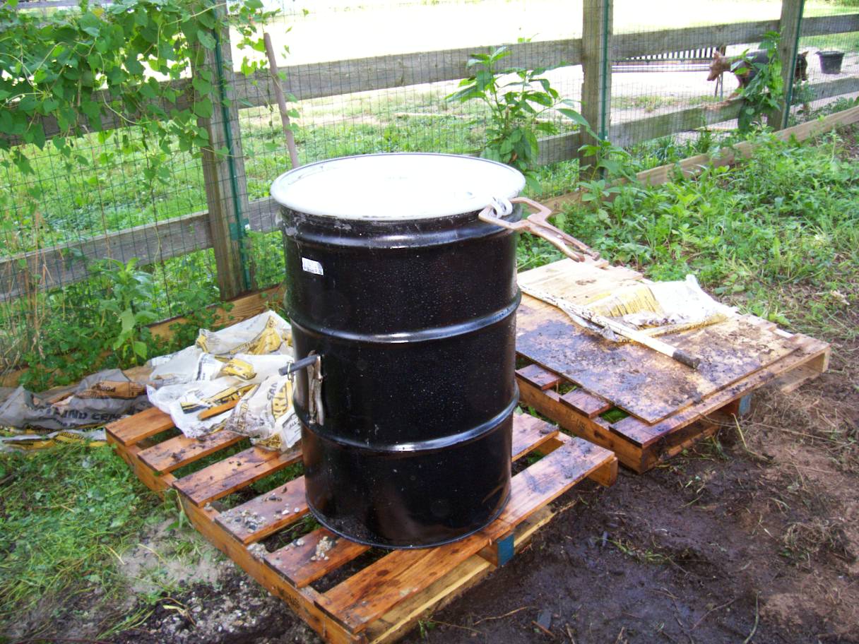

   / Building a 3 point balast box
OK now it is all mixed clean everything, all your tools, the barrel, rice it wipe it even if you think it is an old nasty thing you just might want to paint it some day. Now for me I have a lid so this will also be my chain box so I wipe down the inside above the cement. Now take a small block of wood an float the surface so it is nice and smooth. Make sure it is level too so it isn't heaver on one side. If you have a lid and snap ring put it on so the barrel stays round as it cures. cement can miss shape your container so make sure it is in place. Now forget about it for a week to 10 days and your done

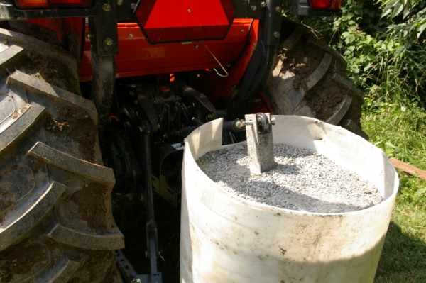

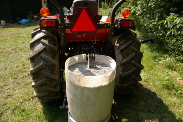

I made one like Soundguy explained in some earlier posts. I used ten 80# bags of concrete,rebar , 2" box tubing that connects to the top link with holes drilled in flat stock that I welded to the box tubing.

I didn't want to mess with the lid so I grab it above center. as long as I have my ground clearance I don't need it any higher. I wanted the trunk space LOL
