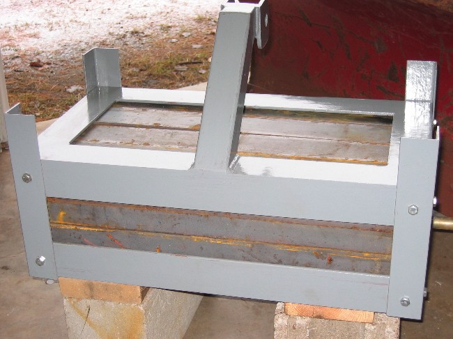

For some of us the 55 gallon barrel is a little large. I built my weight box out of scrap metal in a rectangle 16"d, 12"h, and 22"w. It has room for another 100# if I move the bracket to the top. Presently it weighs 561#. I use it on my JD 4110 with the snow plow and could move it to the TC 55 New Holland if needed. I can also slide some of the bar stock out for use on the cultipacker. It stores easily with a roller pallet. I may be able to adapt it to the front of the NH and remove the loader for better visibility in field applications.
