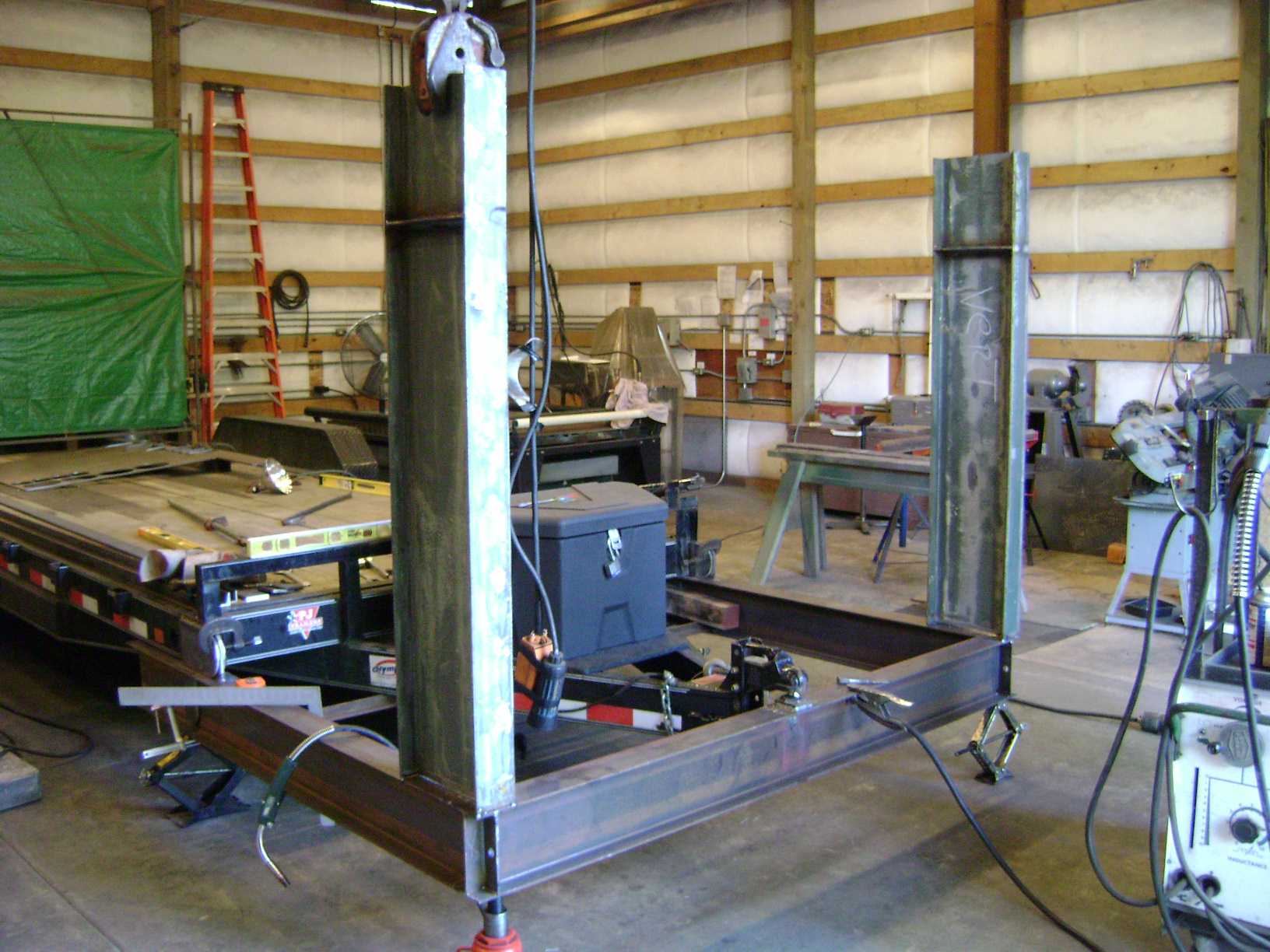

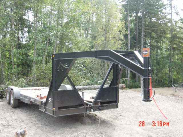

I've built a couple gooseneck adapters for flatbed trailers in the past. One for me, other for a buddy. They are a lot easier than one would think. ;)
Holy crap you do excellent work brother!
