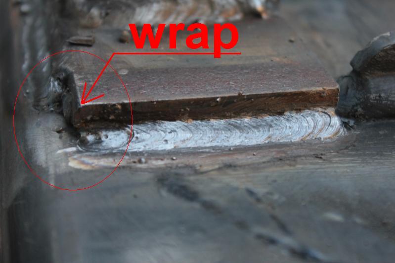

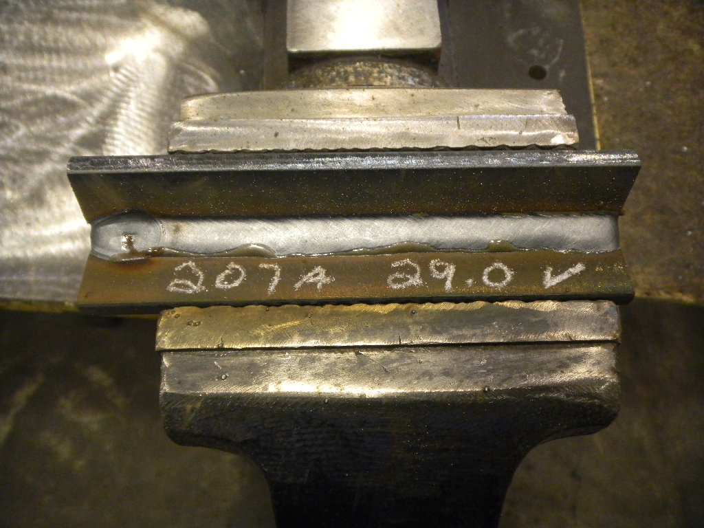

I will add one more, "Nice Work". I bet that Plasma table is a huge time saver. Please tell me what you mean by wrapping corners and filling craters. I am just learning the finer points of fabrication and am always looking to learn.
Cheers
BUBBA
   / Building a 5th wheel trailer to haul my tractor. #32
Wrapping the corners is when you take the weld all the way around a corner. Another good habit to get into is to try and never leave the crater on a corner or edge, try to leave it in the center of the weld, grind the crater down a little, then run the next weld into the crater. What I do when finishing a weld to fill the crater is to back up about a 1/4- to 3/8 of an inch. Also close up the arc length, this will help cool the puddle as well so it will fill easier.;)

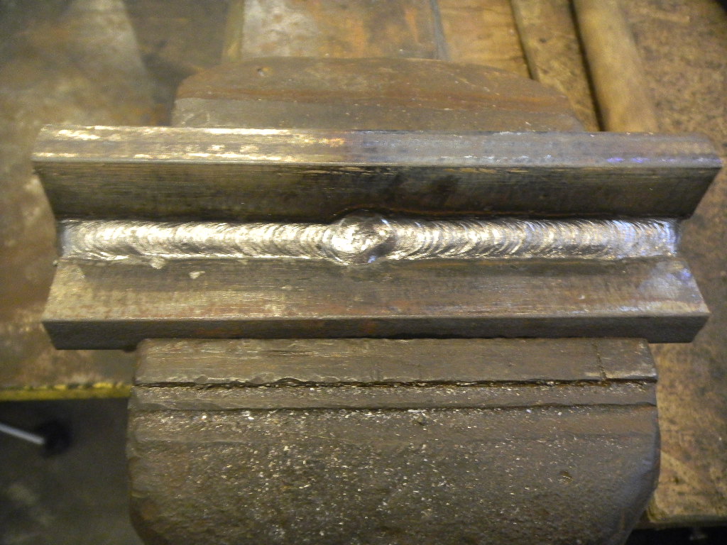

Other good habits, grind the starts and stops of each weld. I like to grind a little ramp to them.
Here is a picture of the stop in the center of the weld. You can't always do this, but it does help if can. ;)

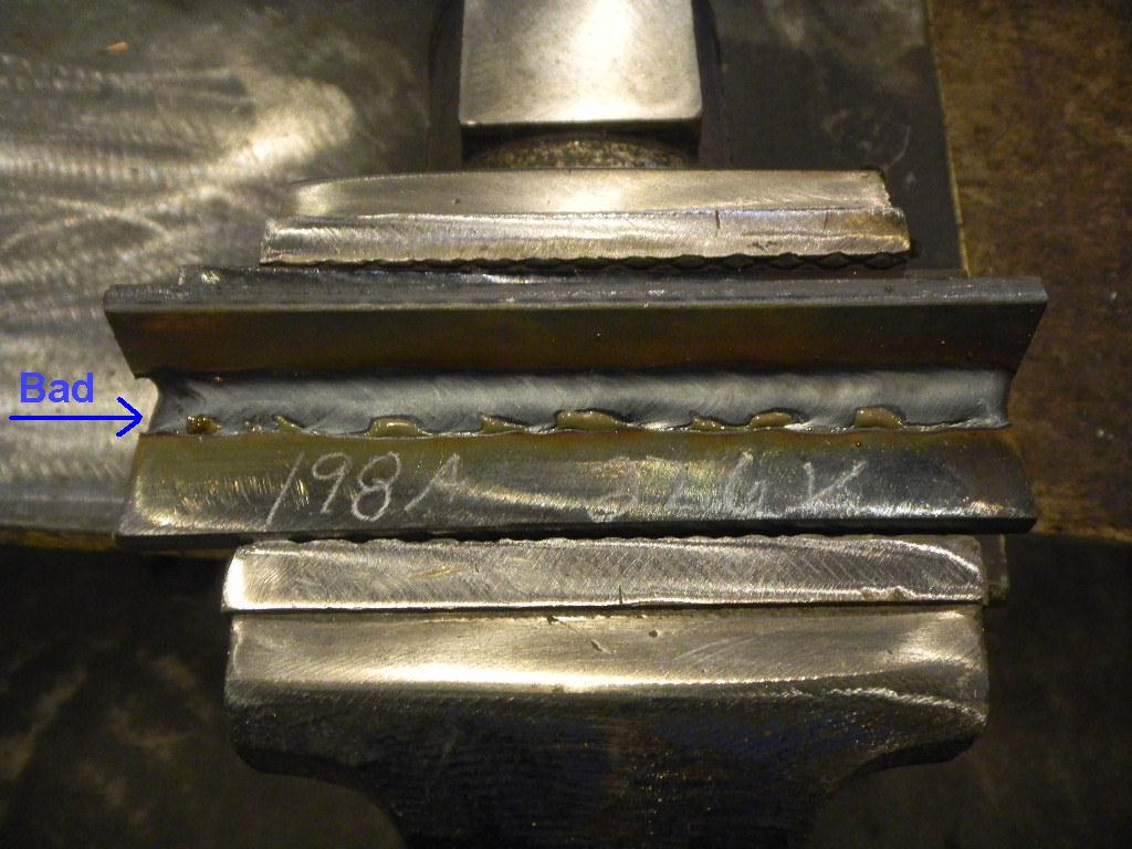

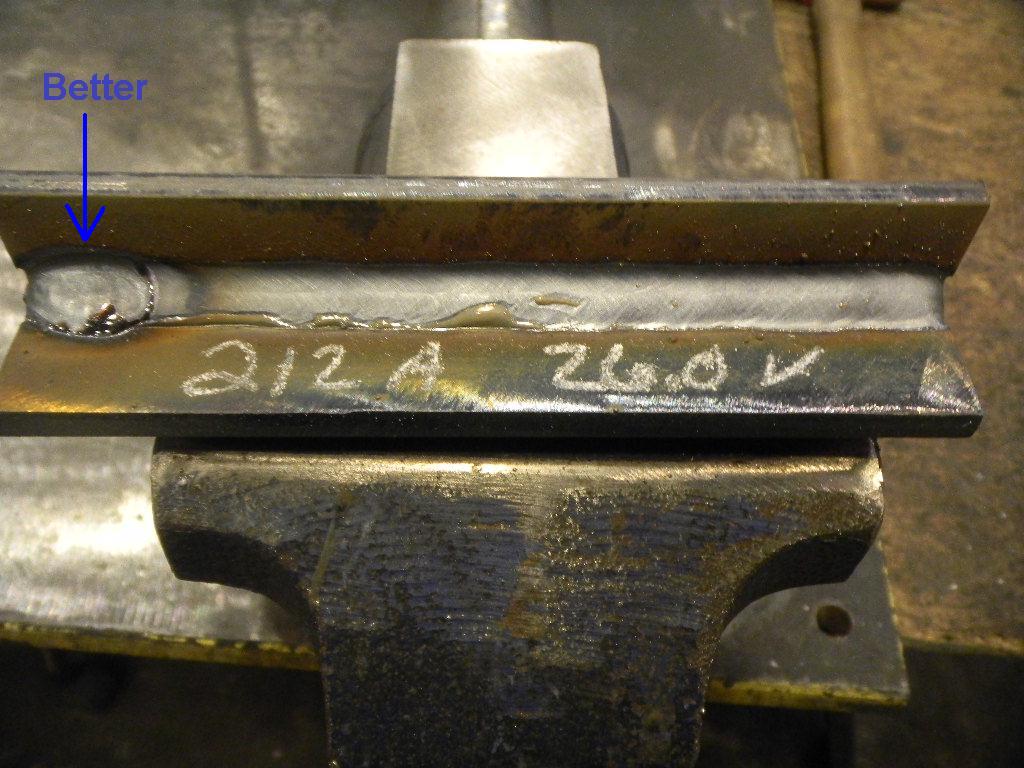

   / Building a 5th wheel trailer to haul my tractor. #37
Here is what I mean by filling the crater / stop. Now these pictures are some playing around by me with spray transfer, so the welds are very hot! In this case I had to back up, but also turn the Mig gun back towards the weld. As you can see in the bad crater, it blew the metal right out! :eek:
