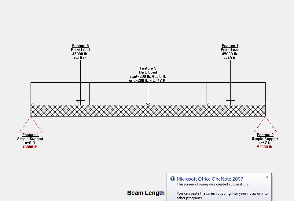

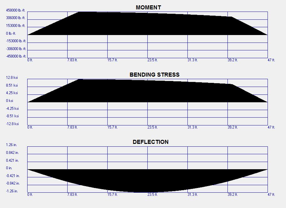

Some background, Beams are rated for load in two ways,
1. Bending stress in KSI. Most beams are A36, which is 36ksi steel, and you are allowed a bending stress of no more than 24ksi, which has a good saftey factor built right in.
2. Deflection. L/360, which is the length in inches/360. In your case, you are allowed a deflection of up to 1.13"
I plugged some #'s into beamboy and this is what I came up with
Beam............Deflection...........Bending stress..........Max capacity
W12 x 30..........(.991)...................13.2ksi....................5700lbs
W14 x 26...........(.963)..................14.5ksi....................5800lbs
W16 x 26..........(.783)...................13.3ksi....................7200lbs
S12 x 31.8.........(1.08)...................14ksi......................5200lbs
I used a 5000 lbs point load @ 17ft (exact center). Using two beams that would give you a 10000lb bridge. Given that steel is priced by weight, I'd probabally opt for the w16 x 26, as it will be one of the cheaper ones listed and the strongest.
The beam he is quoting you will look like this
W16 x 57.........(.311)..............5.5ksi.......................18,200lbs
His beam would give you a 18 ton bridge.
And if you really want a 13 ton saftey factor, consider the W18 x 50 or the W21 x 44. Both would be a little stronger but save some $$$ due to less weight.
