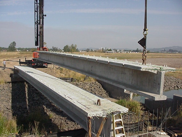

One more photo. Thanks for letting me show the pics.
