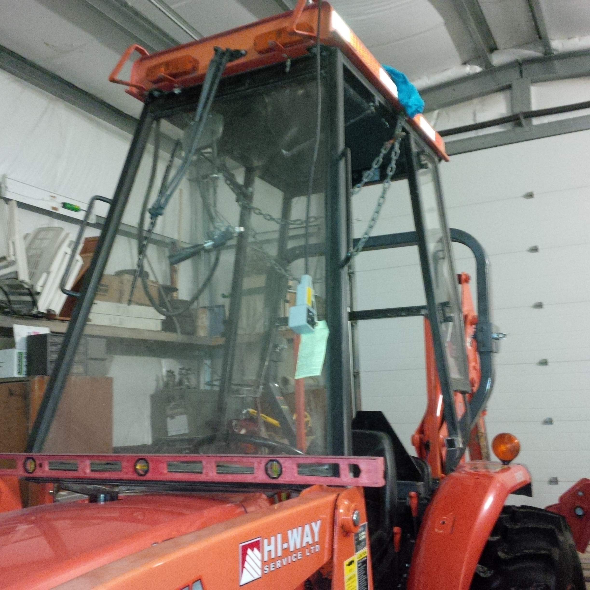

A few pics of the refit so far. A little tall, but I can stand up without bumpin my noggin!
No paint yet, all the fill pieces are whatever metal I had on hand, such as steel corner trim leftover from my shop build, used to fill rear corners. Bottom of door will b lexan, same behind seat. Fill around the cowling will be vinyl and Velcro.
