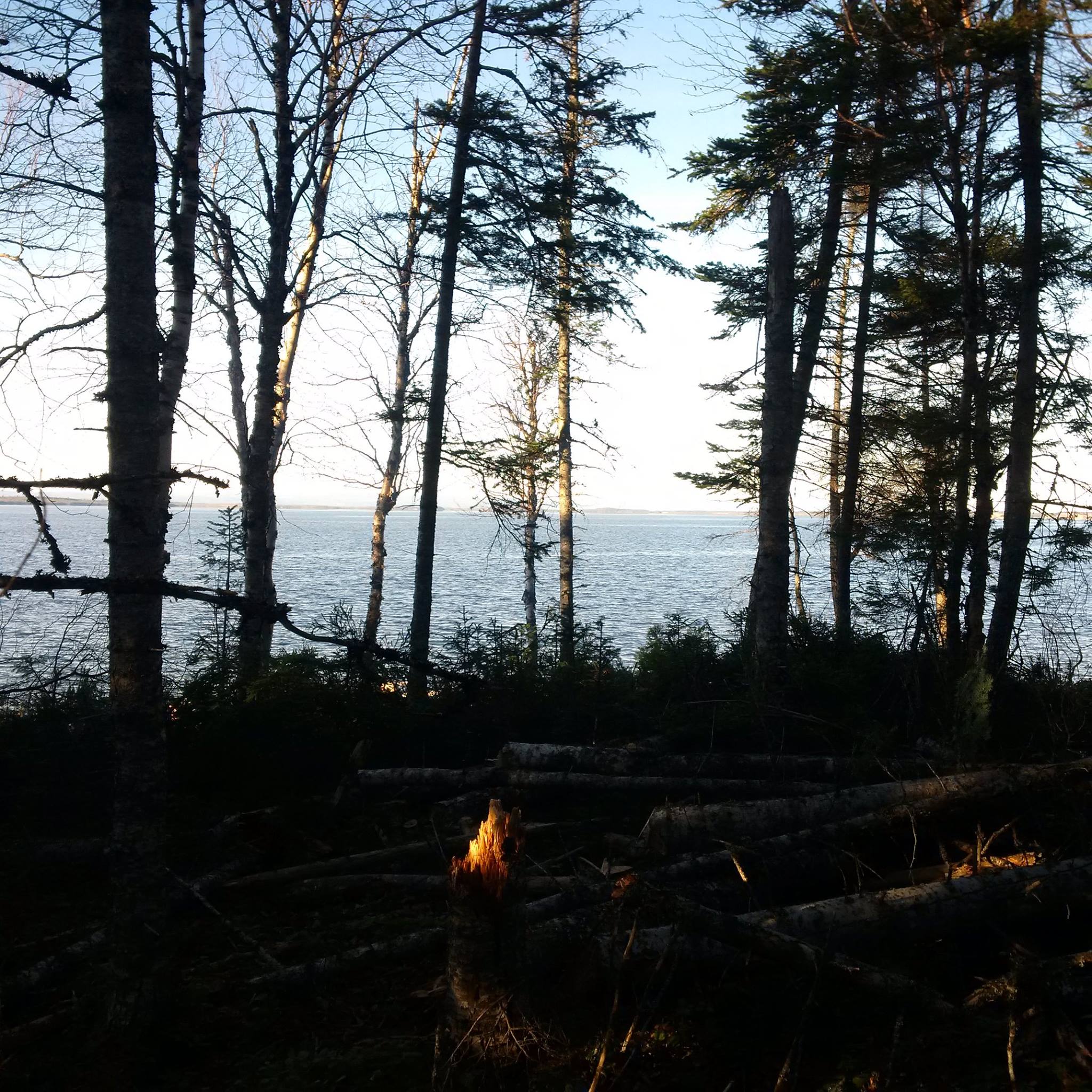

Think Ill start a project thread a little later but seeing as folks here like pictures so much here are a few I took a month ago when the little man and I were up to take a look. We cleared away a bit of brush on site to show mom what the view would be like from the future cabin.
Looking North across the lake from the lot.

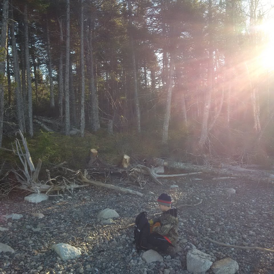

Looking North-East from the beach
Looking South-West with my helper.
Looking south toward the lot from the beach.

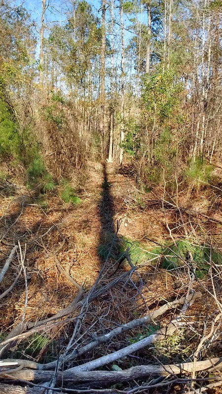

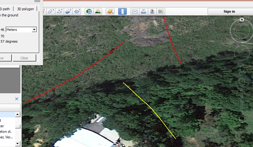

I just "made" a trail about 50 meters through a stand of mixed hardwoods
yellow line
attachment.php
It was an overgrown (30 or 40 years) field area.
attachment.php
I only had to cut about a dozen trees or so that were about 6", the rest were smaller, and the trail meanders a bit so I missed the larger trees.
With the OP's potential pictured work force dragging brush to the side it should go quickly. By cutting the trees down to ground level, LEAVING the stumps to drive over, it should not be that difficult.
Face it an ax and a strong back is all he really needs. He's got a good potential work force.
